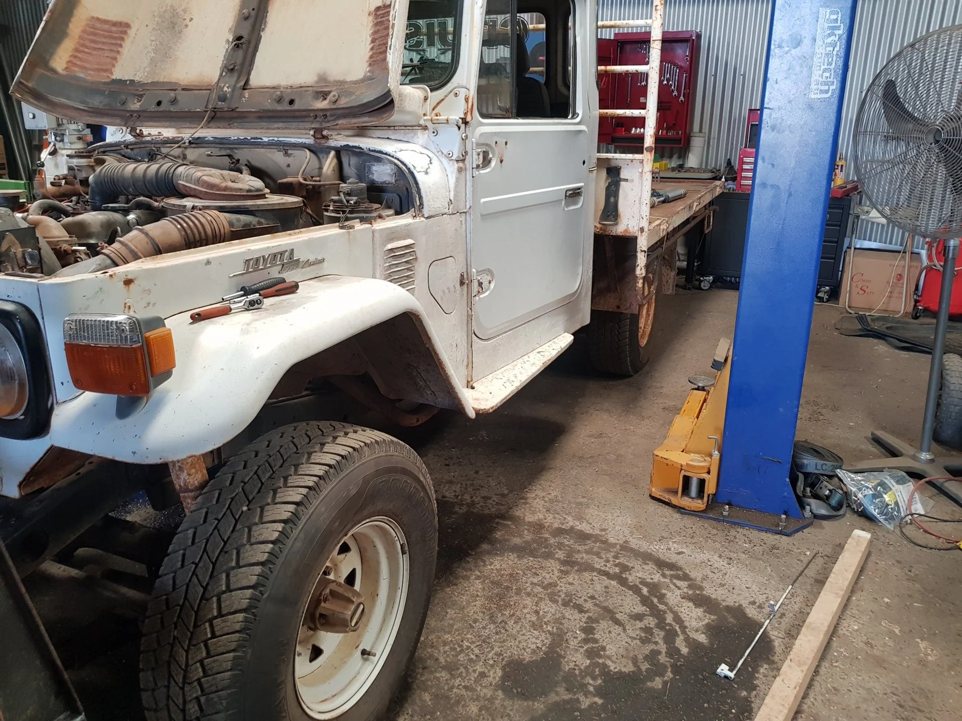

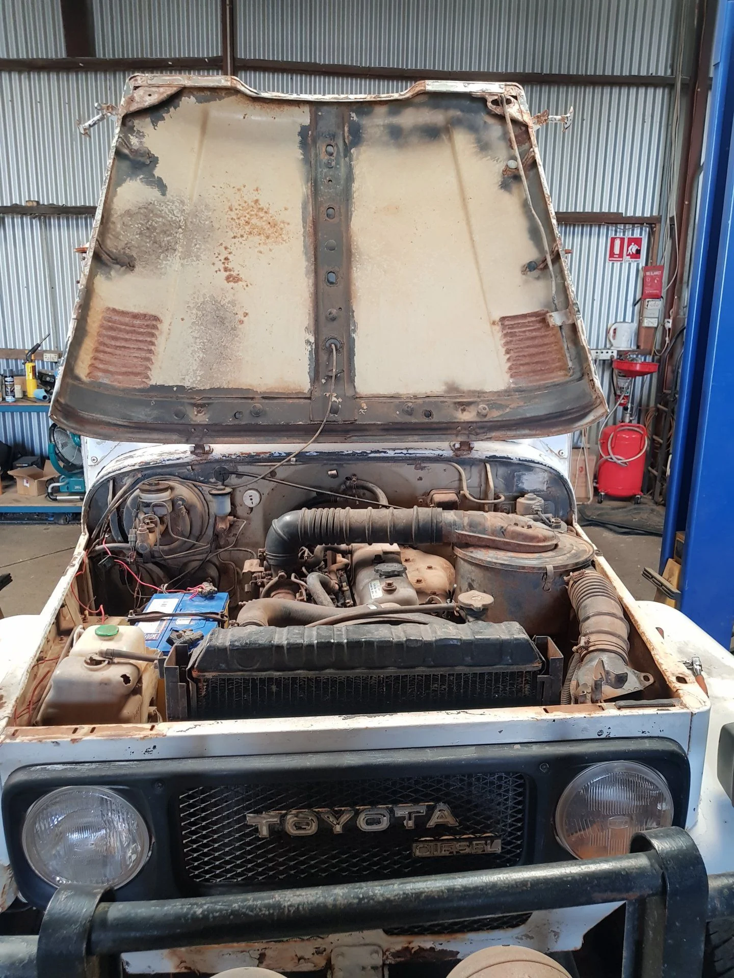

Our candidate is a 1982 HJ47 that my cuzzie @Indestructible 47 very kindly found for me.

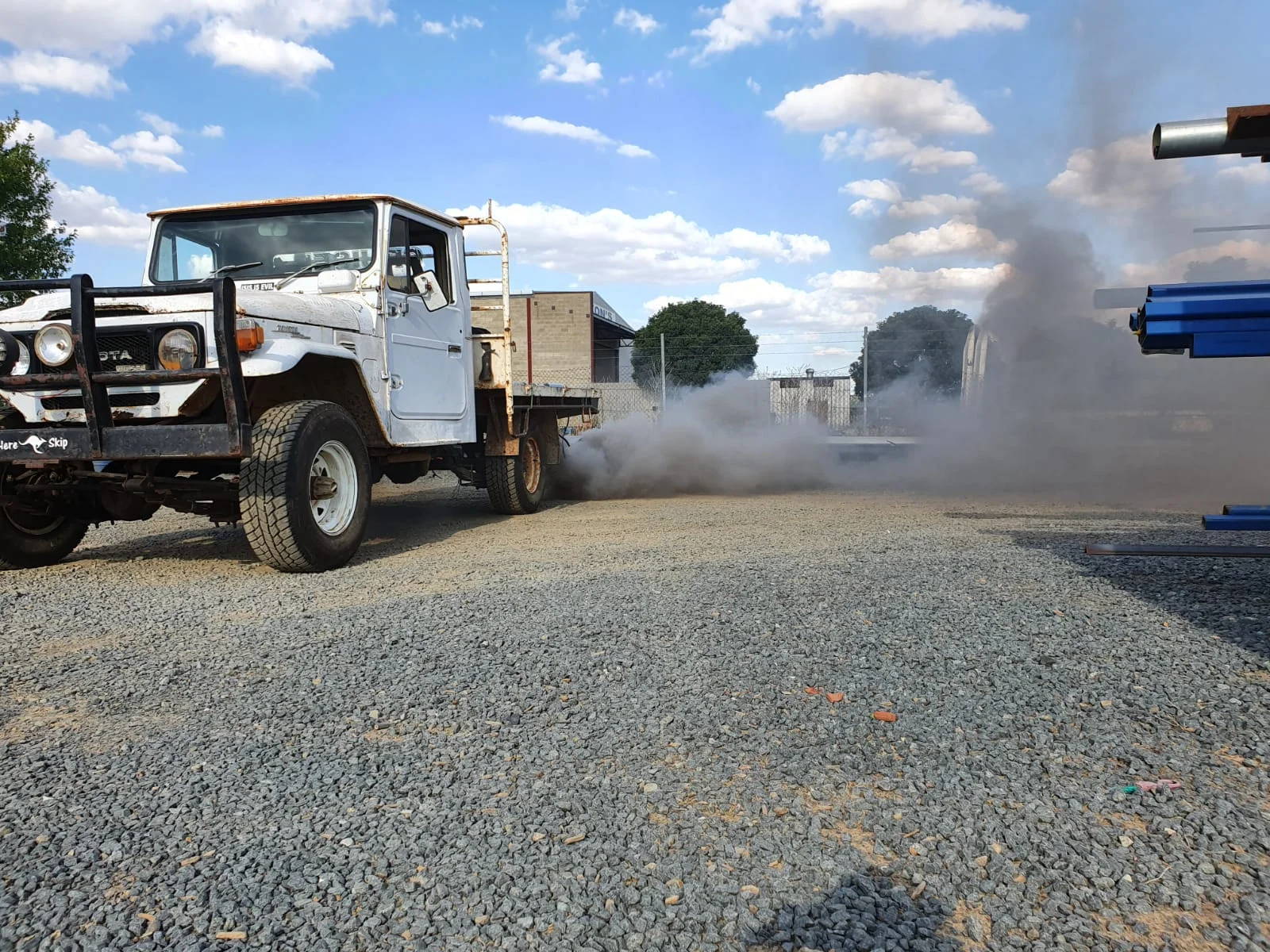

When purchased, she was said to be a good runner, but didn't have the opportunity to hear her run before purchasing.
@Indestructible 47 Kindly picked the truck up, got a battery and got her fired up, but she blew a lot of smoke and had a noticable miss. Furthermore, idle speed seemed to be approx. 2000 rpm. Anyway, thanks to @Indestructible 47 for bringing her up and spending a weekend doing cruiser therapy, we got a knuckle rebuild done on his HDJ79 + a bit of work done on the 47.
So far, the following has happened:
1) Air, oil and fuel filters + oil change
2) Drained fuel tank and refilled with fresh diesel and the suite of products from www.costeffective.com.au - I realise many consider such things to be snake oil and whilst I agree for the most part, I've found the cost effective products to do what they say on the bottle and that's enough for me.
3) Run a bottle of liqui-moly diesel purge plus through the system - filled new fuel filter and pulled the rest of the bottle from the feed line as per instructions.

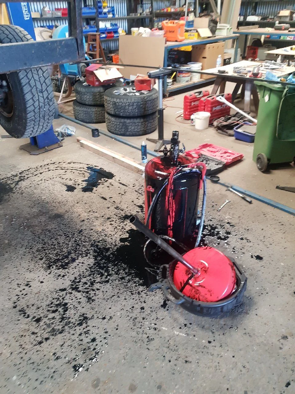

4) Used the cost-effective oil flush - this stuff works! Having had good results previously with this product, gave the 2H the treatment. Dropped the old oil, refilled with clean, warmed the engine, added the flush and ran for 20 minutes at a fast idle, then drained and refilled oil and replaced filter. The second batch of oil was stain your fingers dirty after the flush.

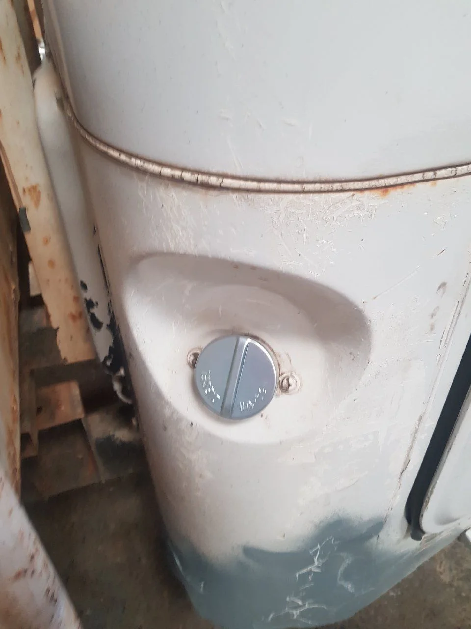

5) Old sock replaced with genuine fuel cap
So, smoke is basically gone but I think the injector pump needs a diaphragm replaced, which I have one sitting here. Running on the diesel purge below...

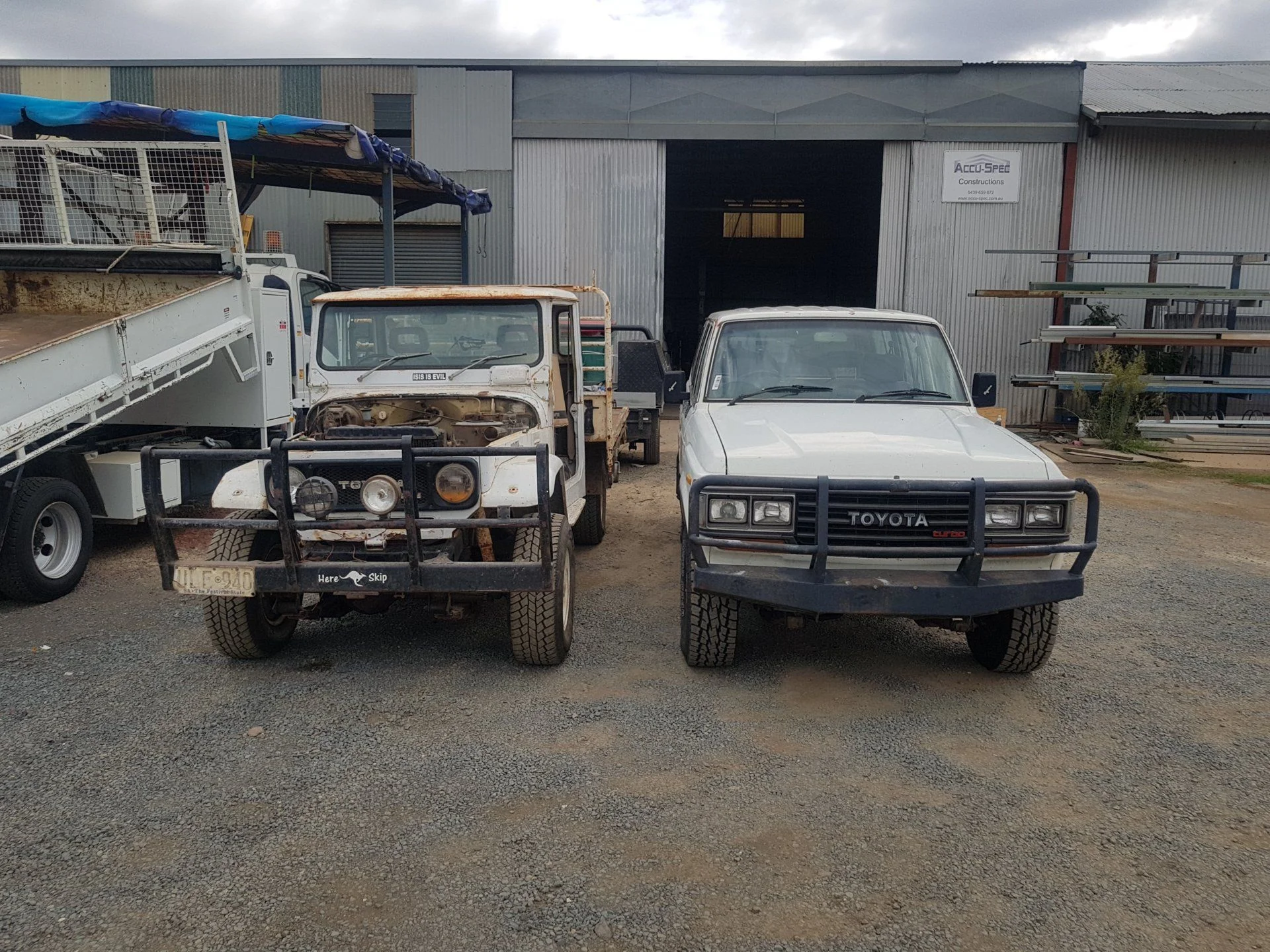

And last but not least, the go part! I have a HJ61 on the way to provide a 12HT and H55 swap, so looking forward to that.

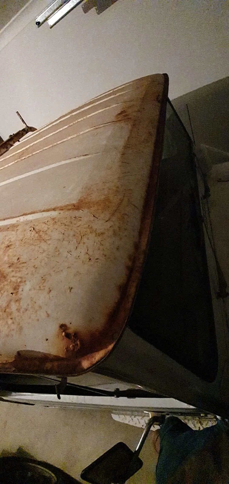

Not bad for a steel roof

Under a couple of other horrible paint jobs, there's the 464

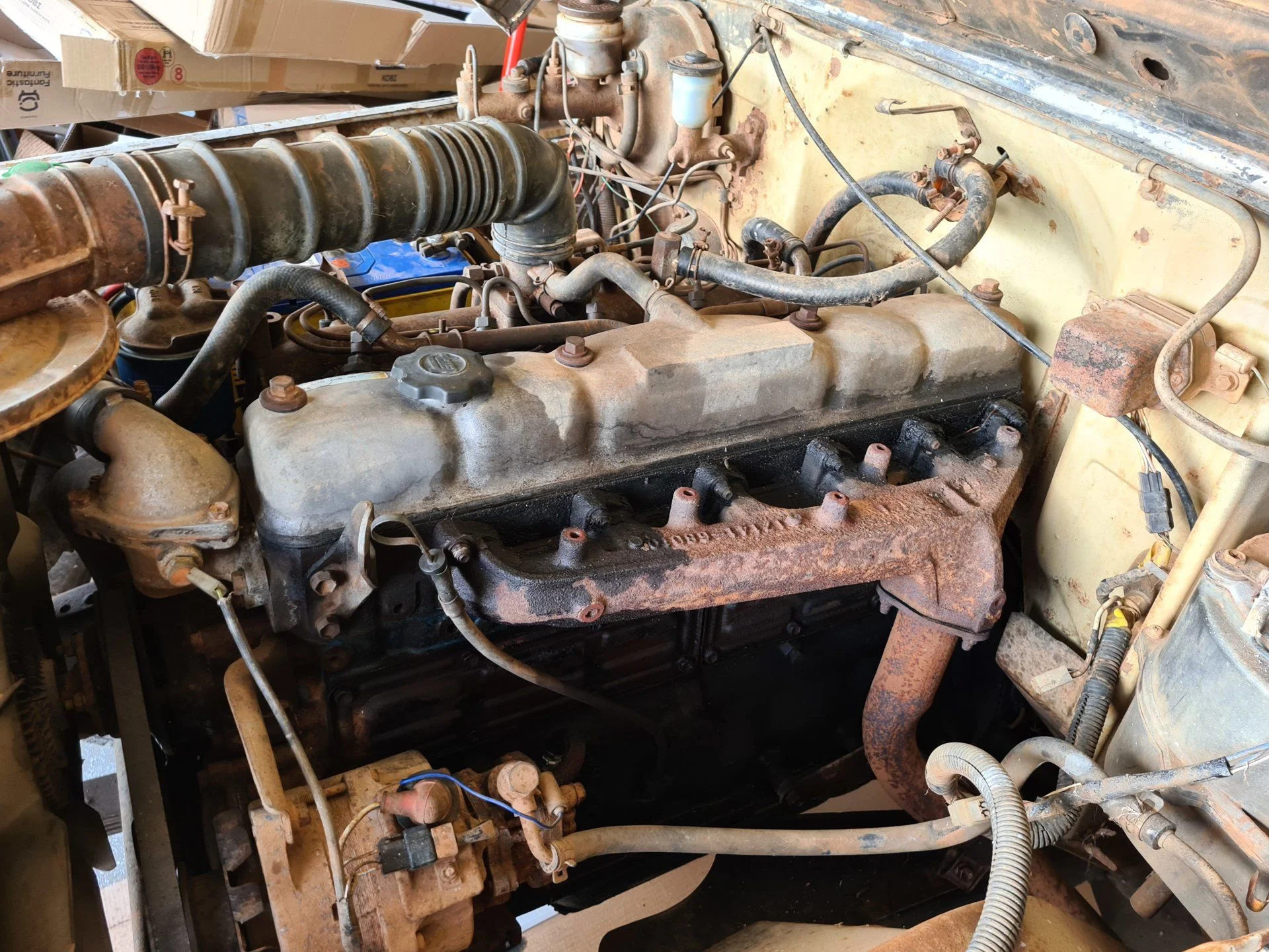

Oil leak from the vacuum pump feed line

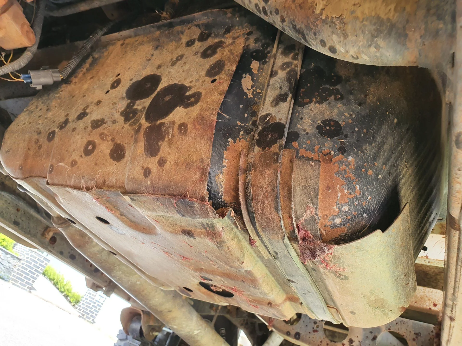

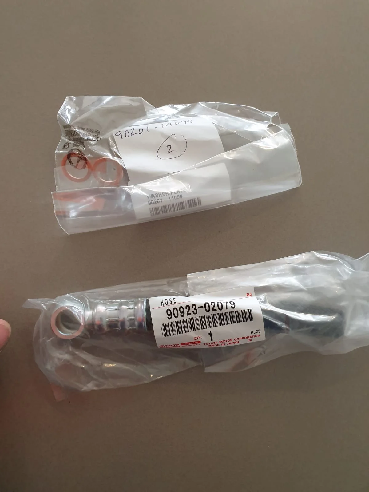

So, it begins, no pics, but the fuel tank had an old sock as the cap which had to be addressed immediately - 77310-60100 for the diesel cap

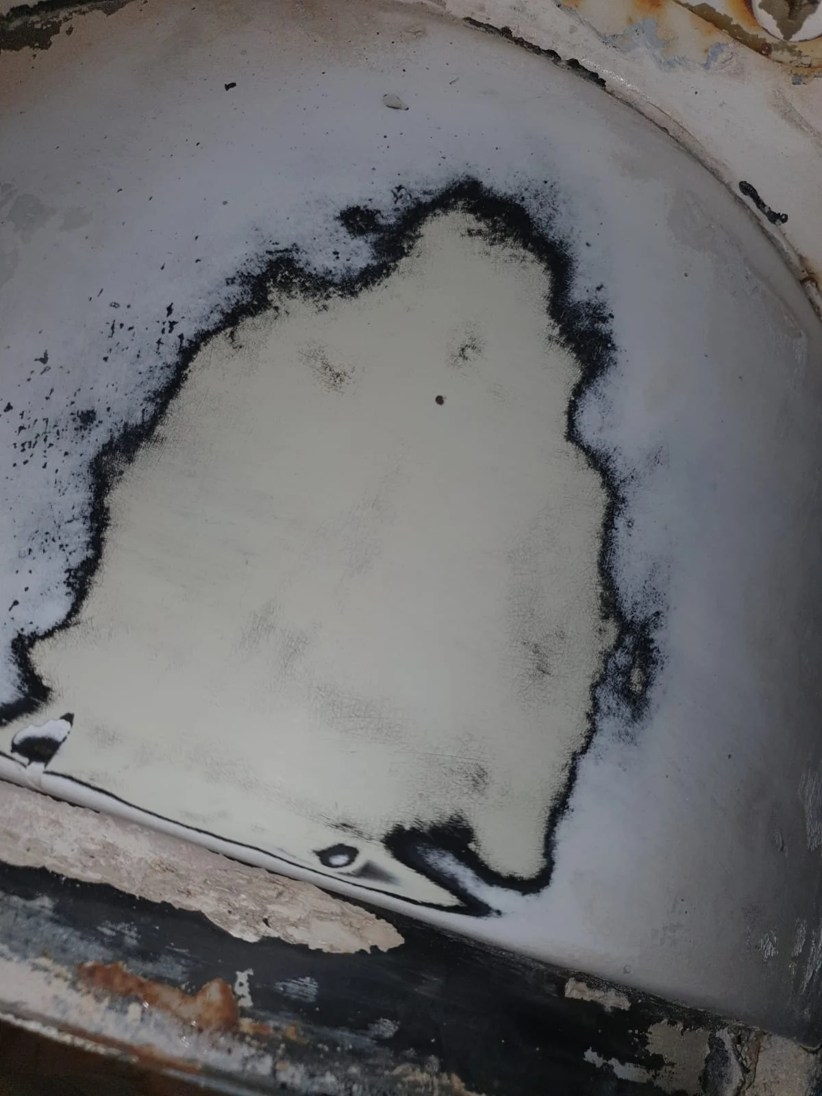

Also pleased to report that doing some digging with a chisel, the cracks you see are from someone being too lazy to use a hammer and dolly and instead filling some minor dents with bog.
I was planning to get the 12HT in and drive this thing for a bit, but the springs are sagged out, the 2H leaks like a sieve and the knuckles are leaking badly so I think it's gonna be a frame-off straight up - possibly not realistic but I'd like to have her back on the road by Christmas.

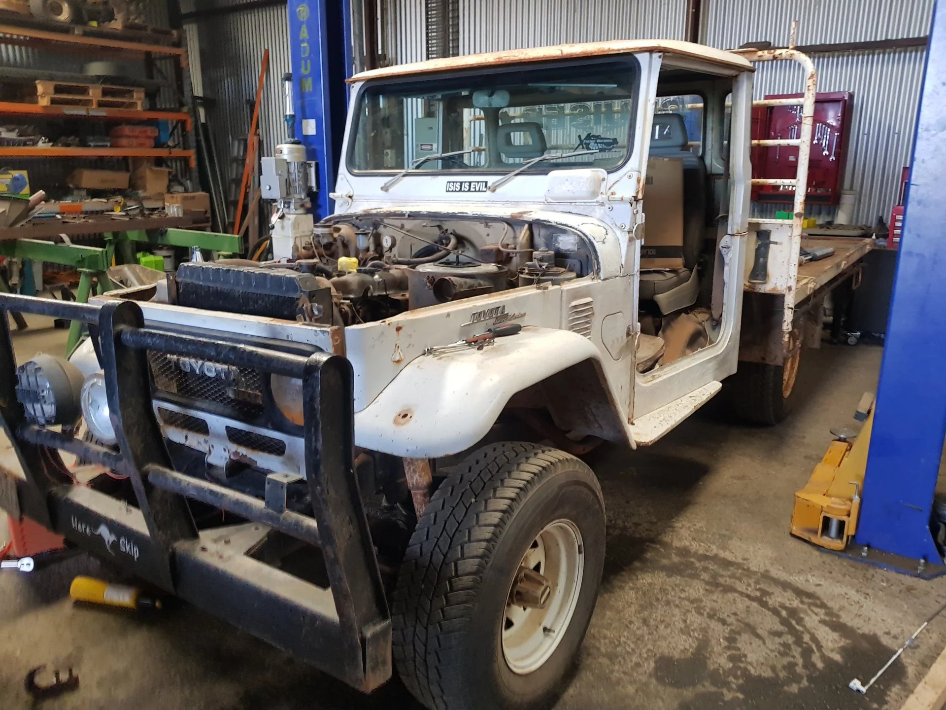

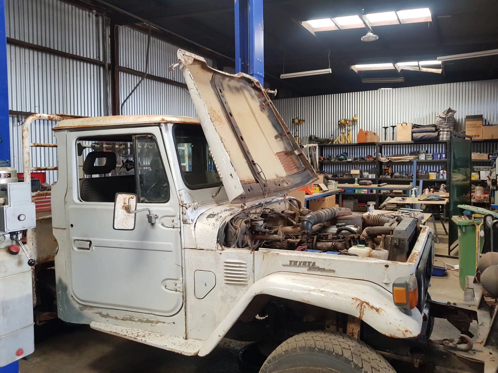

The teardown begins
Tenderized and ready for the Barbie!

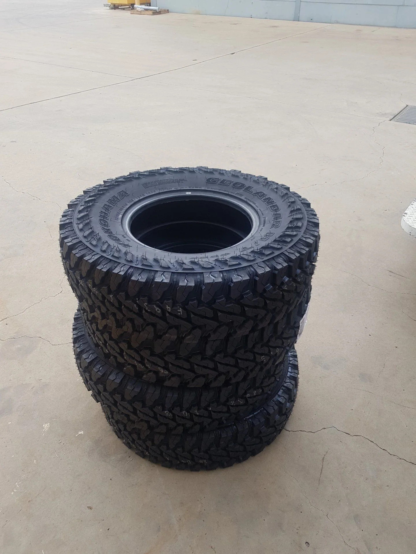

I'm probably putting the cart before the horse a bit here but Yokohama Geolandar G003 came on sale here so I bought 4 in the 255/85r16 flavour. I can't find an engineer interested in helping me with coils, decent lift or anything so change of build plan and shooting for 2" springs, 2" extended shackles for a 3" lift which should look good with 255/85 on stock rims

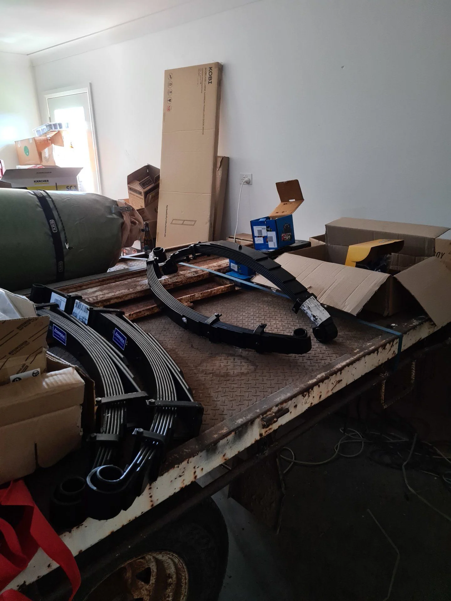

2) Suspension, I have ordered 2" springs, extended shackles from Superior Engineering and Bilstein 5100s from summit racing. The springs and shocks in it are absolute toast.

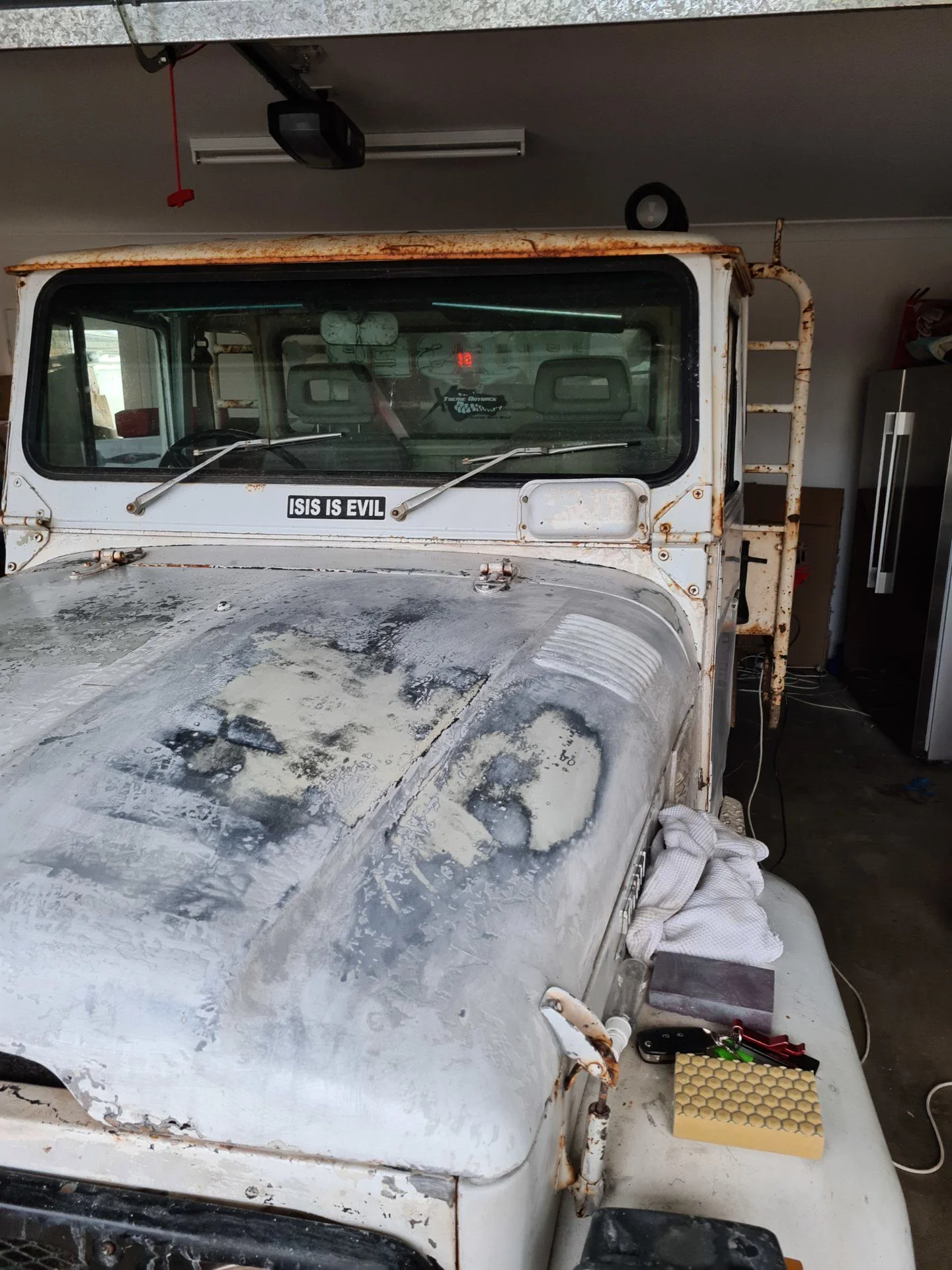

4) a bit of wet sanding to clean the body up a bit

Springs have arrived
Wet sanding underway - still not looking great but it is coming off

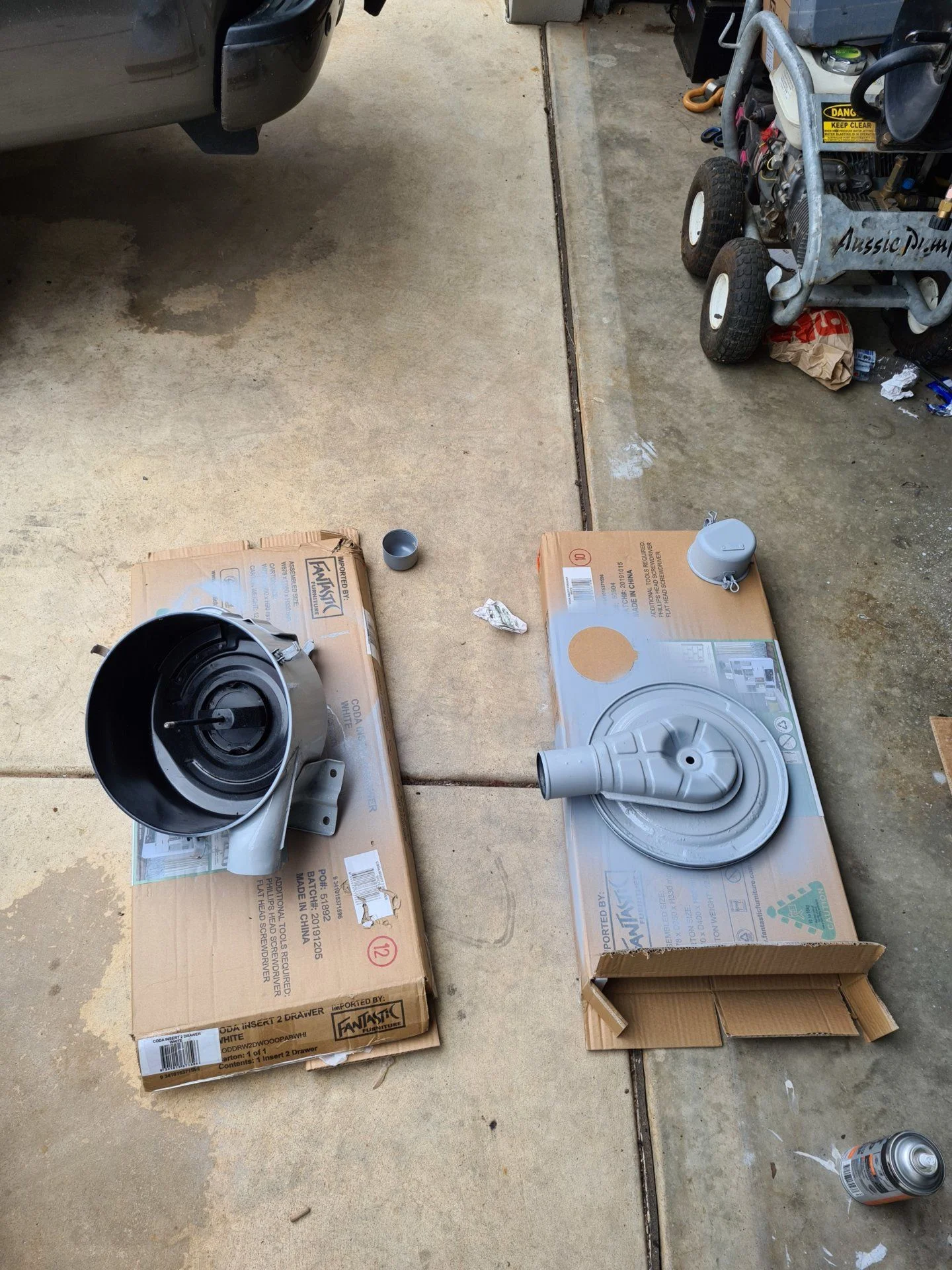

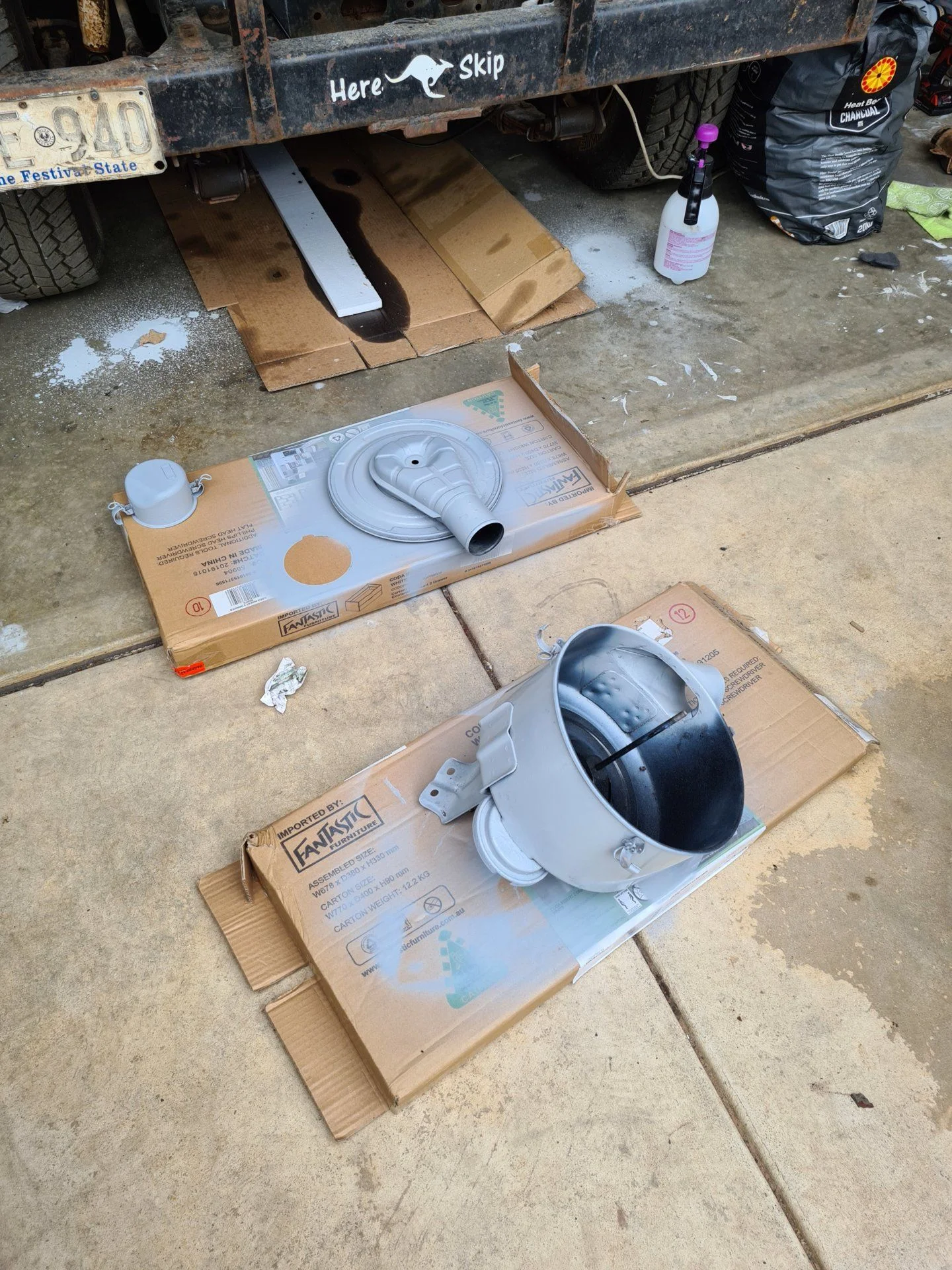

Lastly, with the airbox out to pull the heat shields, not necessary but easier with it out, decided to paint it so gave it a round of degreaser, dish soap and a scrub and lastly a phosphoric acid rust converter in prep for satin black tomorrow
A bit more - cleaned, rust converted, wire brushed, cleaned with acetone and primed. Not concours quality by any means but I think I've put the brakes on the rust for a while
