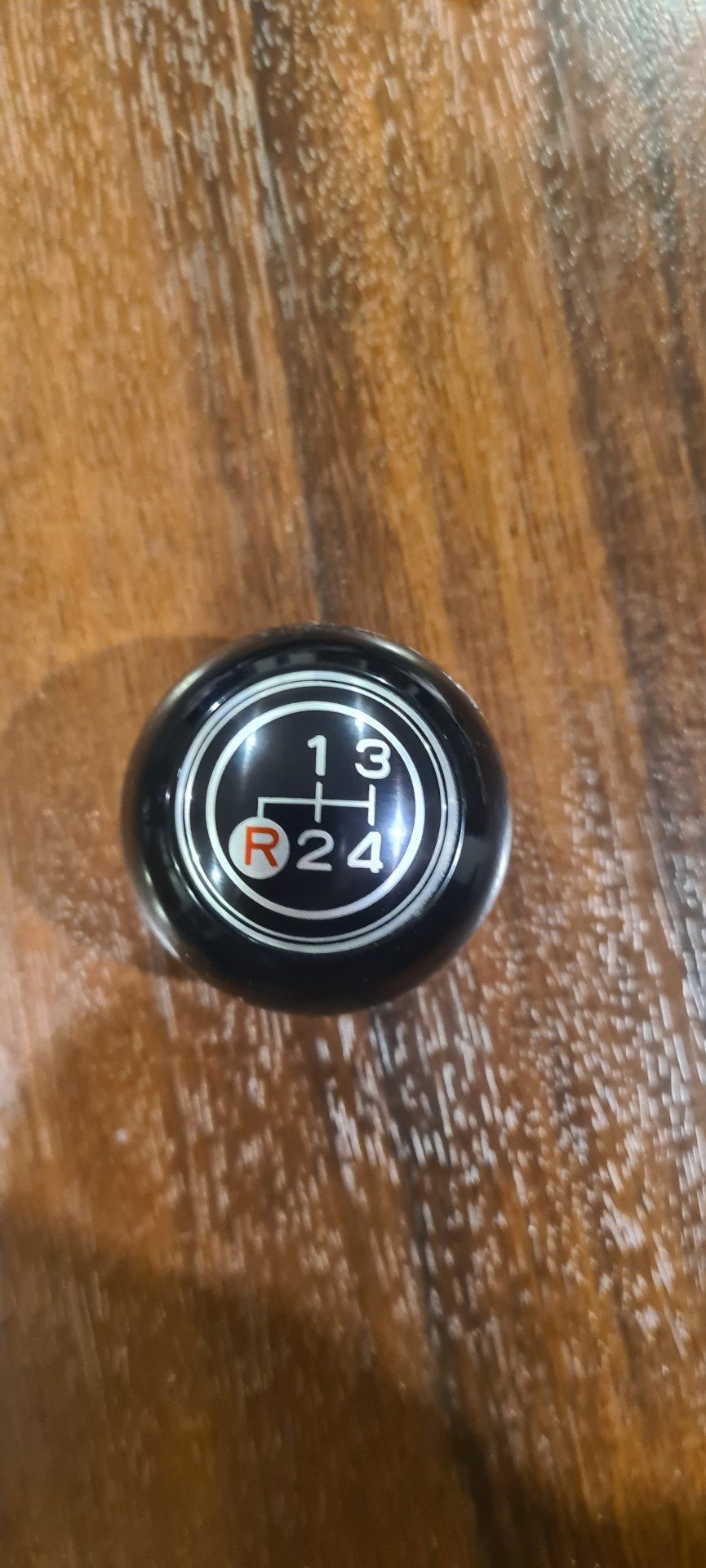

Care package from Partsouq today, front axle hardware and rear bearings and seals, plus shift knob etc. Gotta love Mr T's attention to detail with the threadlocker on the studs etc.
Also got some very nice goodies from @lcwizard - rocker protectors and U-Bolt flip kits - more pics of them tomorrow
