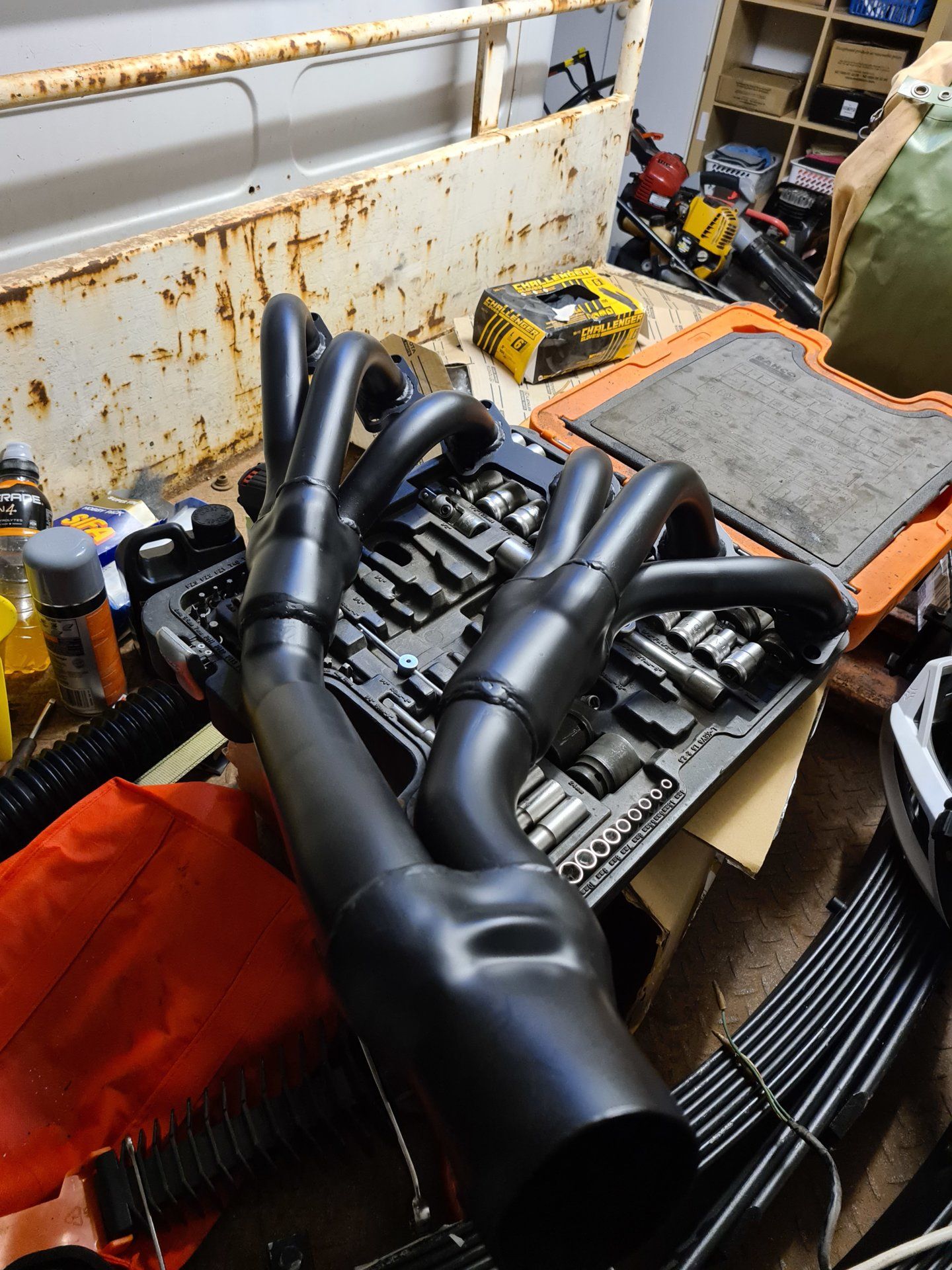

Extractors turned up today so got into pulling the manifold. Didnt break any hardware so that was nice, but will have to wait until tomorrow to get it off as I can't get the downpipe nuts off and the neighbours might not appreciate a grinder at this hour
So...this escalated quickly
Exhaust manifold off, some of the studs decided to act like bolts...
Since the access was so good and I have a genuine gasket set...why not do the side cover gaskets while I'm here?
Houston, we have a problem - factory studs are too long for the header flange - dammit!

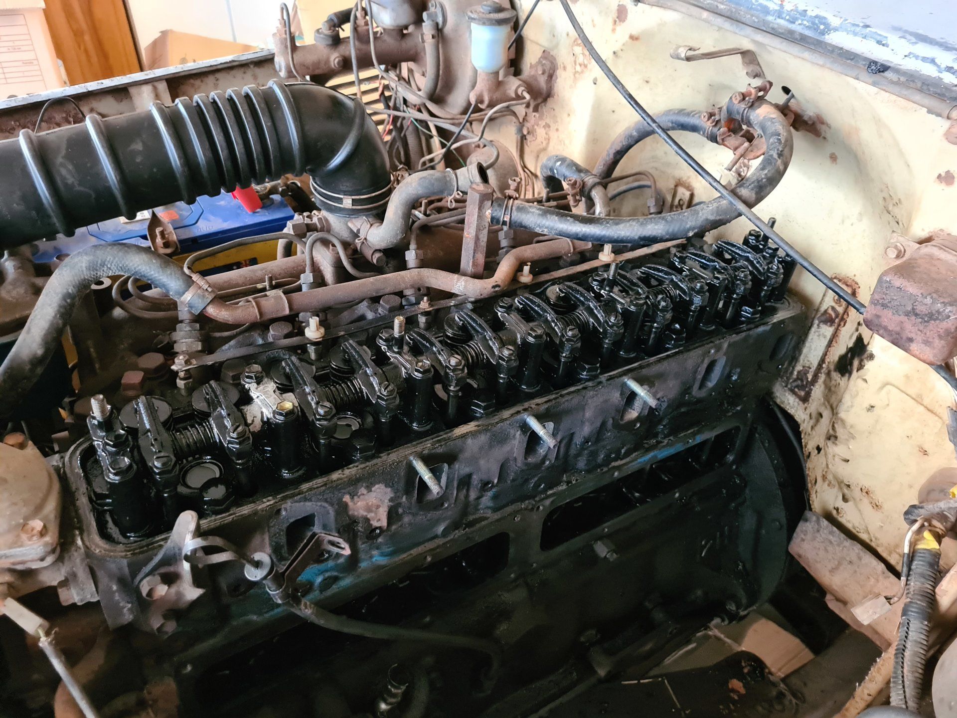

Well, I can't put it back together tonight so might as well replace the valve cover gasket...

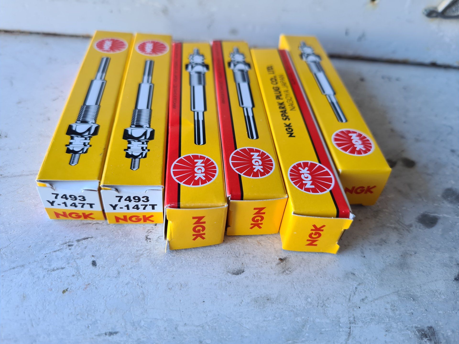

Glow plugs arrived! Hopefully this is the key to decent cold starts as I'm getting 12V at the busbar with the key turned backwards
Old plugs out, nothing alarming here thankfully, no oil or signs of mechanical distress. They're 6 volt plugs tho so the full 12 volts probably cooked them pretty quickly as this isn't a superglow setup, it's a manual, turn the key backwards setup. And she starts perfectly now!
