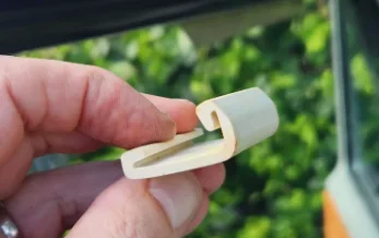

Part number?
What is the specific purpose of these?
I'll get that part number for you guys shortly.
