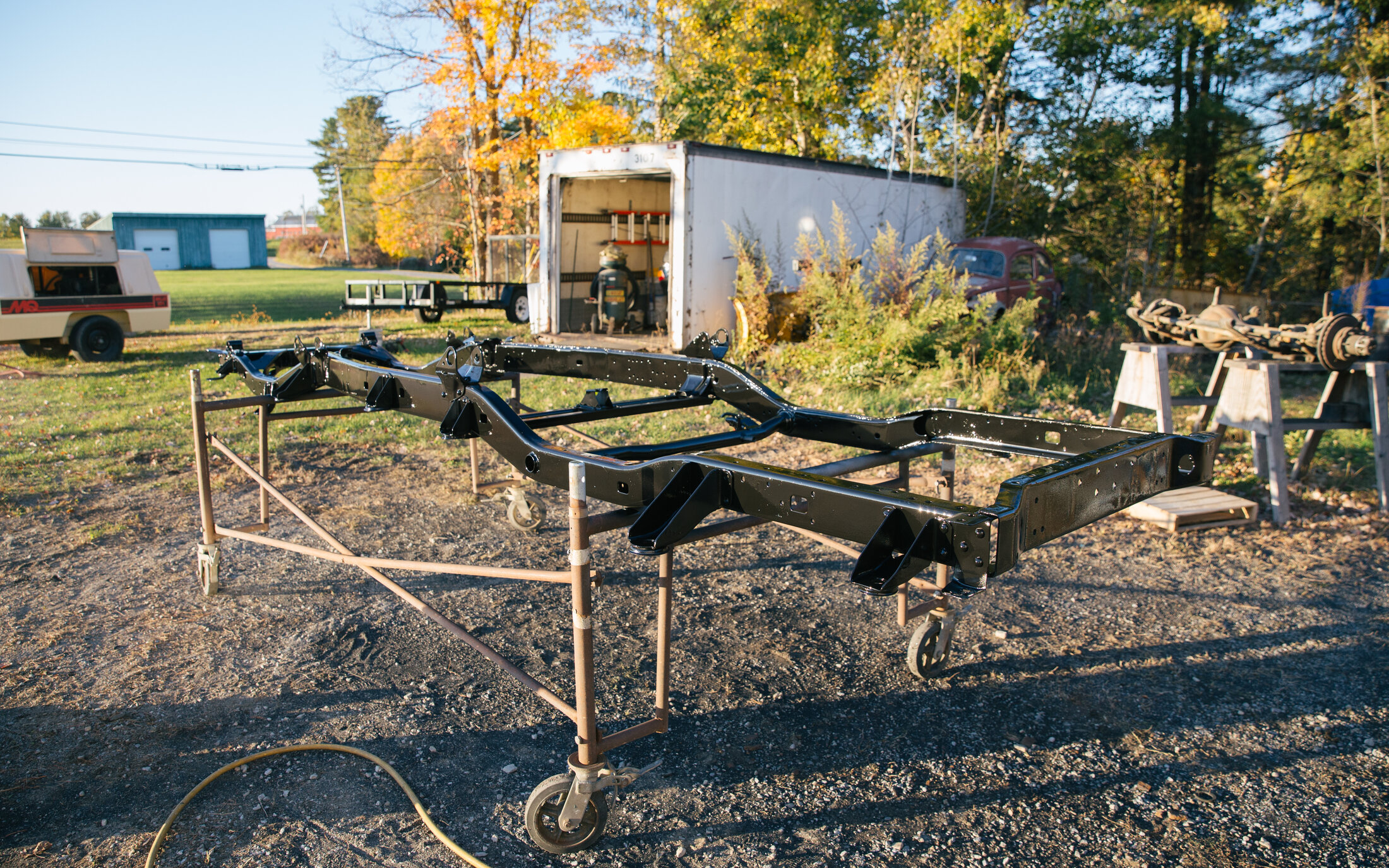

Recently sandblasted and painted the axles (and frame) and now wondering what are the best things to change since the axles are off. I’m going to be doing knuckle rebuilds on both sides but wondering what else should be done at this stage.
Suspension, pads and rotors, brake lines, sway bars, etc.
Thanks in advance!

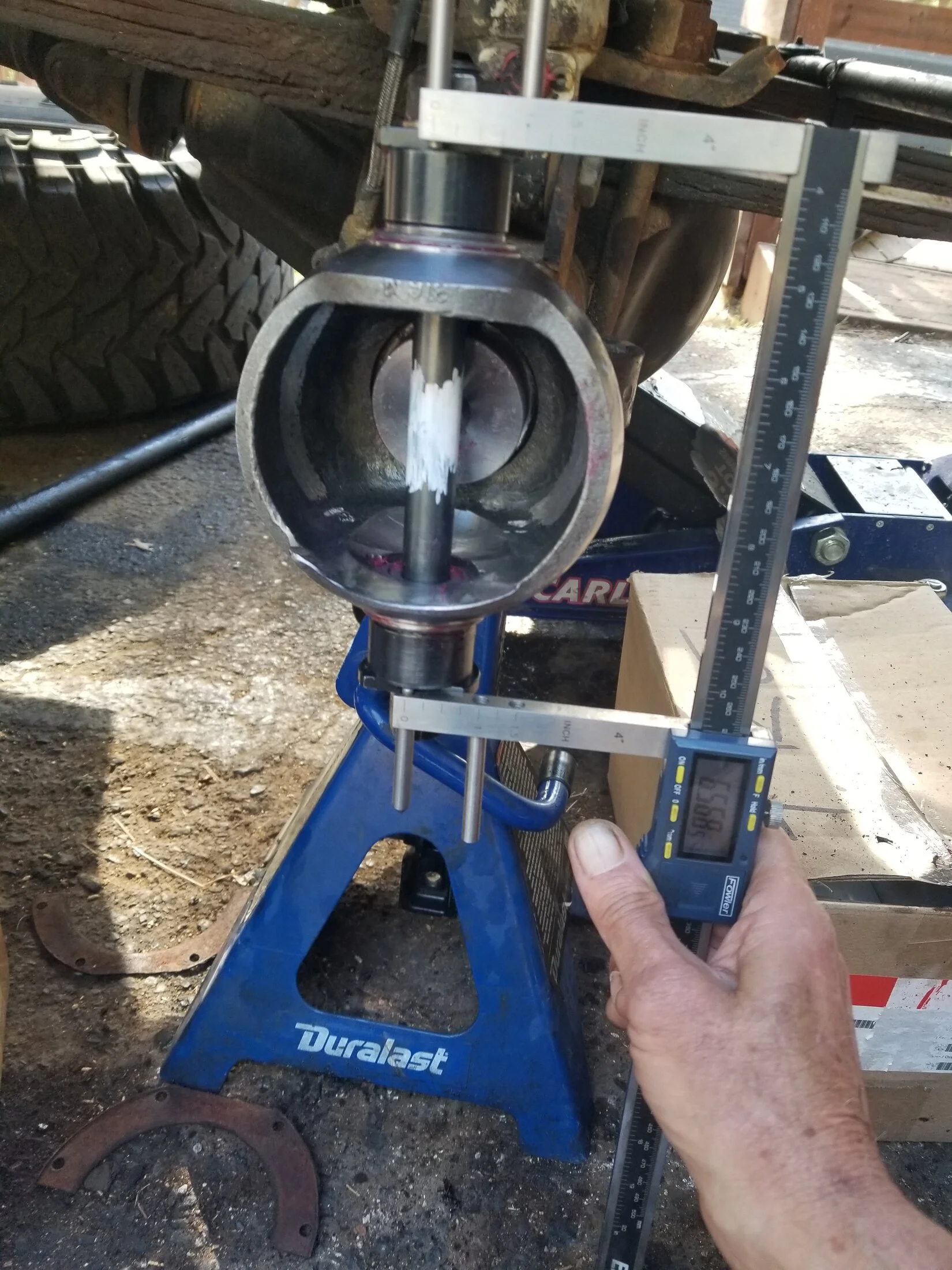

Got the knuckle rebuild kit from Cruiser Outfitters and wondering about the shims. Is there a certain number that typically works best on the top and on the bottom? When I took off the passenger side there was 4 shims and when I took off the driver side there was 2. And only 1 on the bottom.
Just wondering if there is a standard that goes on top vs bottom to help with the resistance?
i don't believe there's a set number for that. the amount n thickness of shims is dependent on measurements taken as reassembly is underway. that's for centering the hub with the axle shaft. resistance is adjusted by tightening or loosening knuckle bearing. see page 6-11 though 6-13 in the land cruiser repair manual

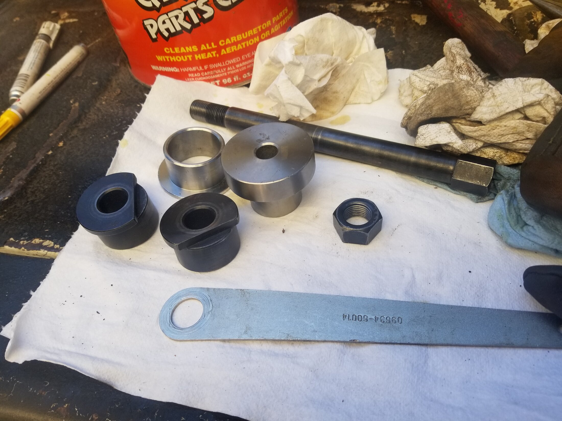

This might be a good time to borrow the SST for centering your axles to the knuckles and do the math thing to help determine what shims you need.
How do you go about centering the axles on the knuckles? And where does one borrow the SST?

I borrowed the SST from another 'Mud member, I just posted that I needed one. There's probably a section in the FSM detailing how to do it, probably something in the 40/55 tech FAQs too. I forget where I found it, but it wasn't too hard. I had to use my biggest calipers.
Some shops have a Rule of Thumb procedure to do it without the SST, they'll use a routine set of shims on the bottom and pick some shims for the top, if the pre-load ( with the fish scale) is within specs, it's probably close enough.
