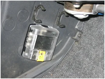

Mine is RHD. 12V Fuse box is on left side.
fuse box
