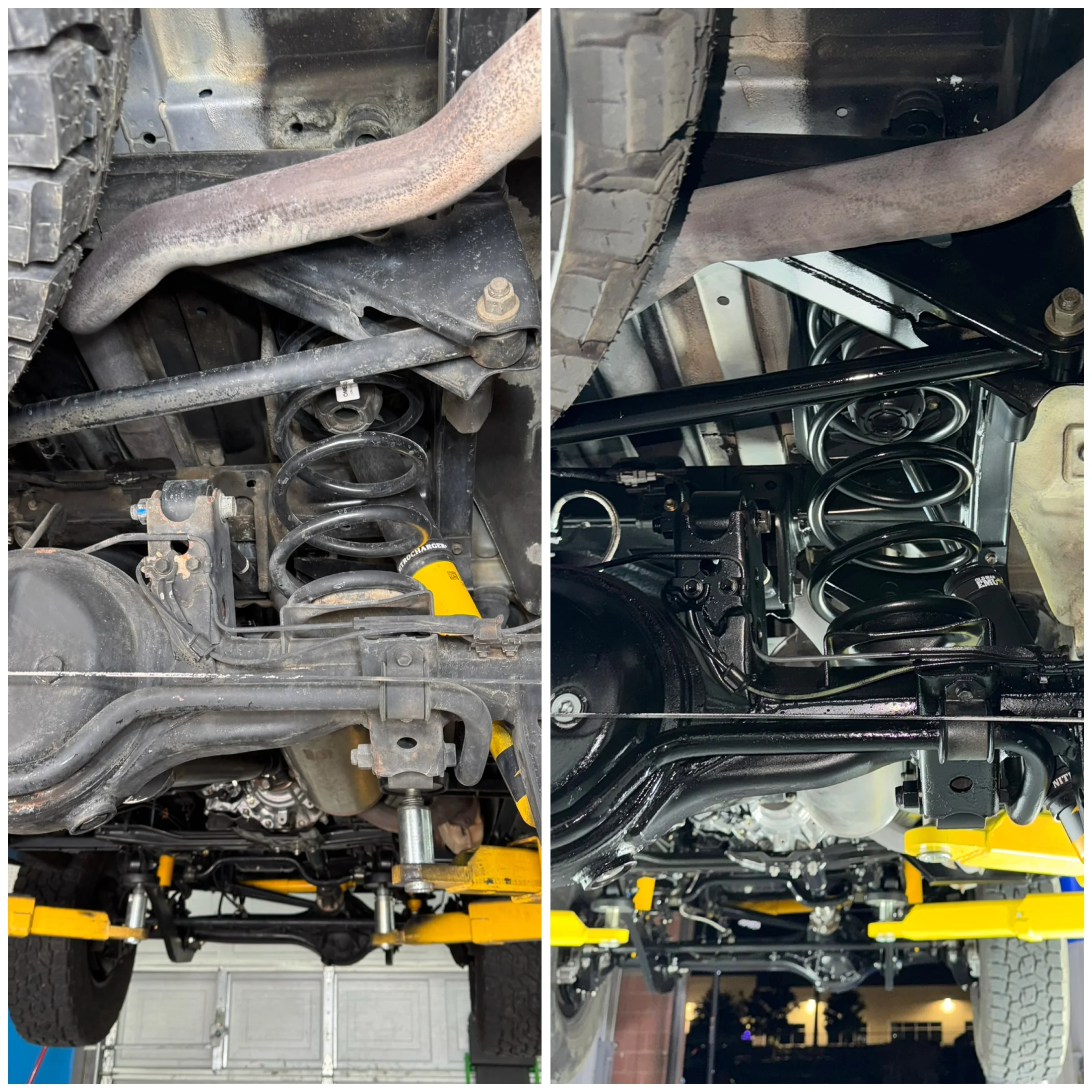

I had my 97 LC blasted then a 10year ceramic coating applied. Absolutely most satisfy dollars spent ($3500). Used DFW Artic Blasting. Highly recommend.

Did they paint a bunch of things black too after they were done cleaning it? Several of the pics definitely show a lot of areas sprayed after. I can post pics of my undercarriage and I have way more zinc hardware etc showing since it’s bare with no coating and zero winter exposure. I’m curious what they used. I do ceramic coatings for a living. I don’t know any product that’s black.

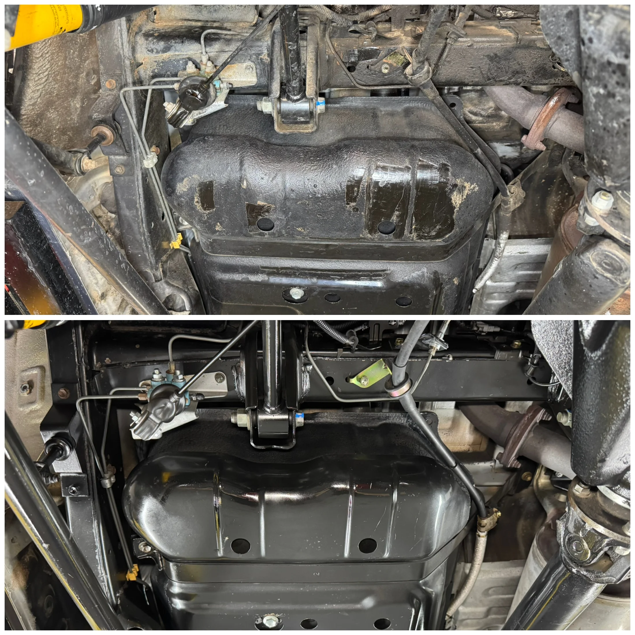

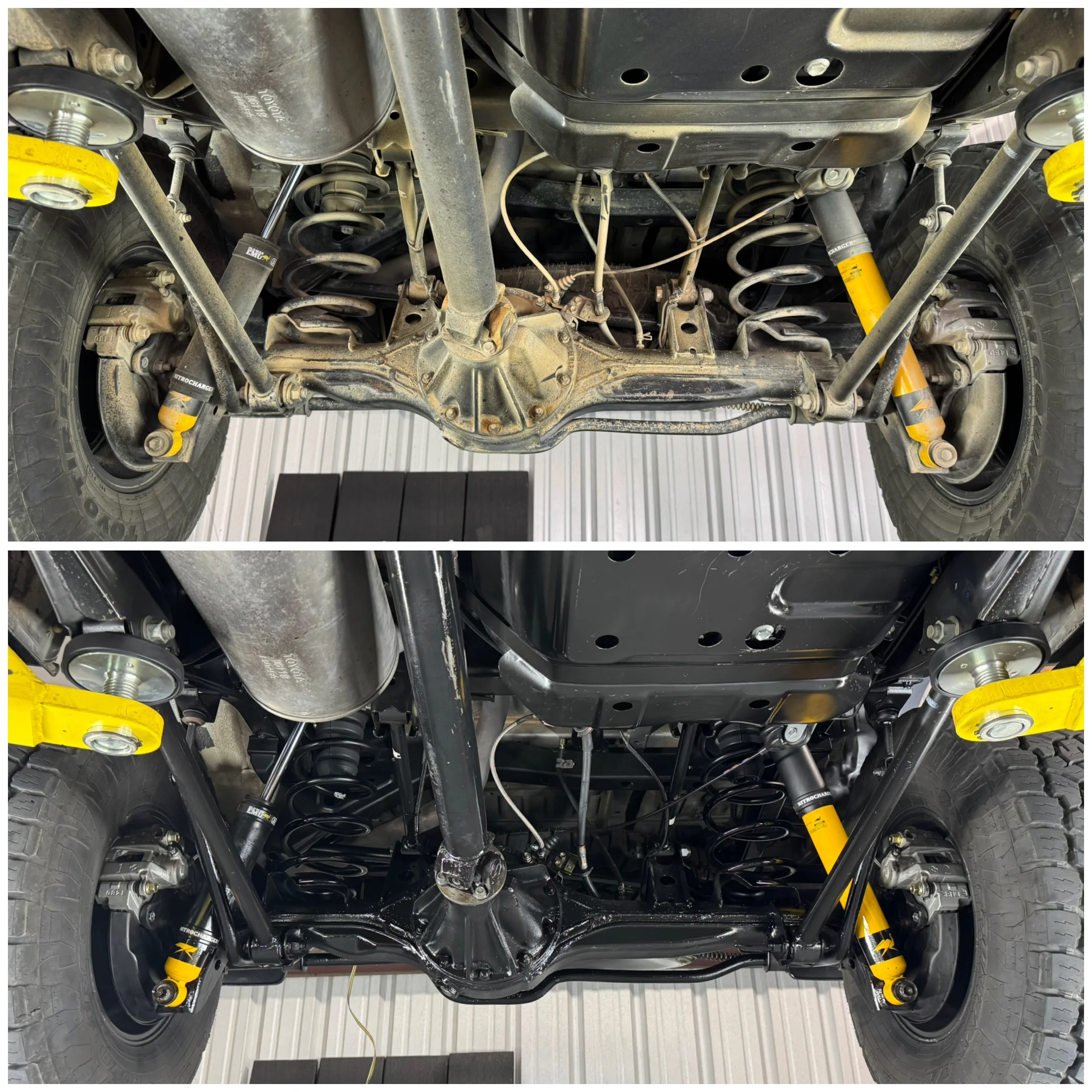

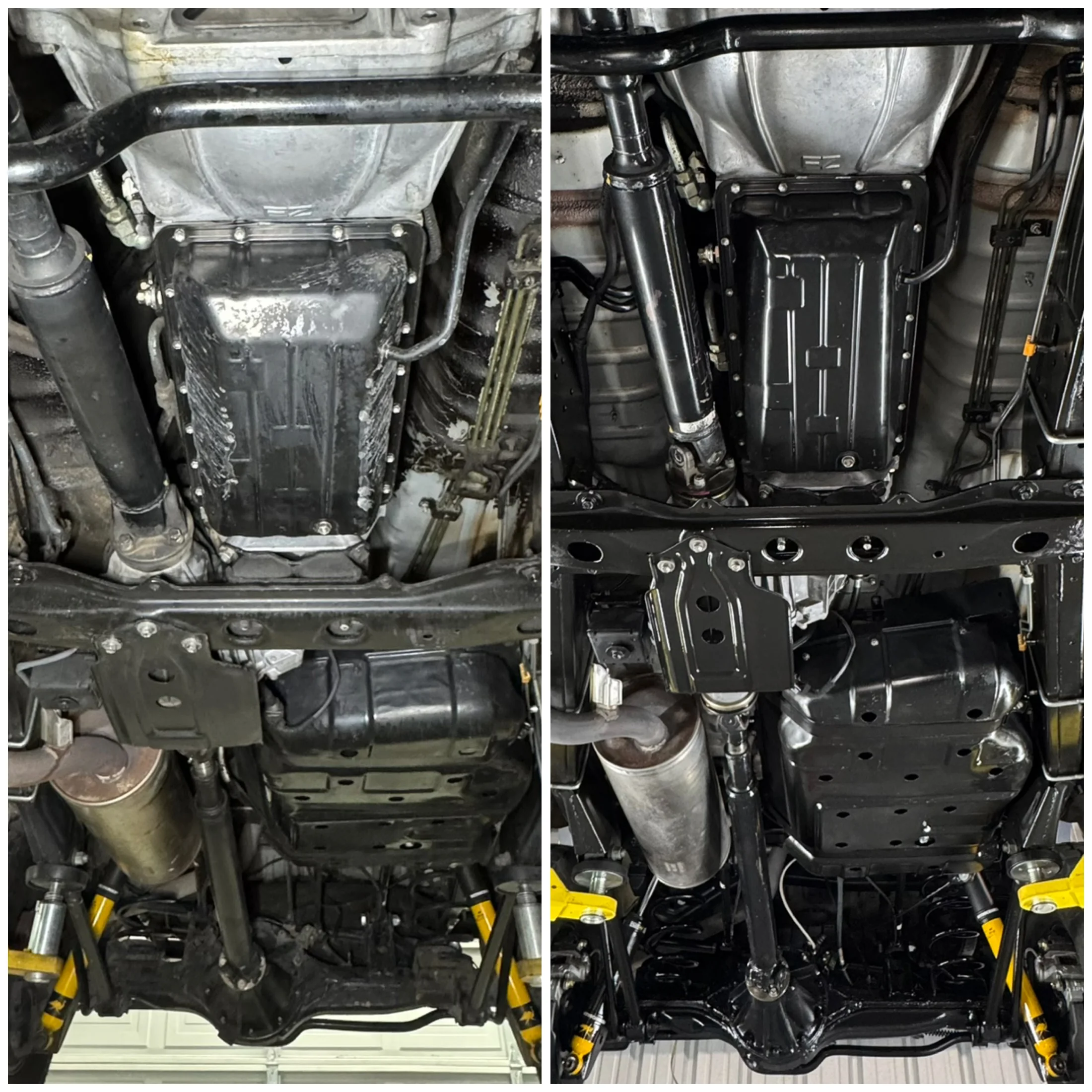

In the attached photos the 80 series had some serious build up from an oil or wax film, the owner wanted the ladder frame cleaned so he could apply por15 to the frame.
