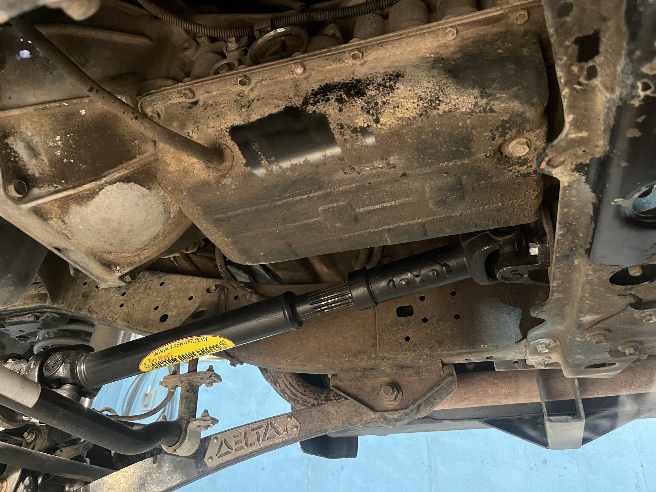

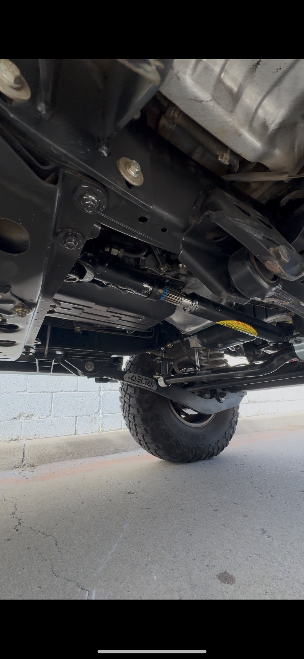

The nice part about dry ice blasting is the ability to adapt to what the customer is looking for, in a lot of cases we can turn up the pressure on the machine and remove paint, in other cases we turn it down to remove contamination from various surfaces without damaging the underlying surface because dry ice is non abrasive.
Other nice part is sensitive areas won’t be damaged like delicate wiring, rubber substrates, and other items like radiators or oil coolers that can be difficult to clean.
In the attached photos the 80 series had some serious build up from an oil or wax film, the owner wanted the ladder frame cleaned so he could apply por15 to the frame.

Amazing results! What would something like this cost in general? My rig is in similar condition...garage kept for most of its life, but also used to it's fullest ability and does get looking like this "before" pic. Unfortunately I'm on the east coast, but it would give a benchmark for pricing to look out for.
Ping Intersport off Rte 7 in Ashburn.
My wild guess is they'll say $2500-3000 for a full size SUV.
"My wild guess is they'll say $2500-3000 for a full size SUV" !!!
Not on my life would I spend that kind of money to clean off dirt and oily grime from the undercarriage. Maybe $1200 tops IF it included an improved coating applied to the entire undercarriage. The vehicle in the video above obviously lived in a dry salt free environment so yeah, it looked good when all the original coatings, dirt, and grime were removed. We'll need a follow-up video showing how a vehicle that's had that dry ice blasting (and coating) looks after driving in the rust-belt (USA) for 5-10 years.
