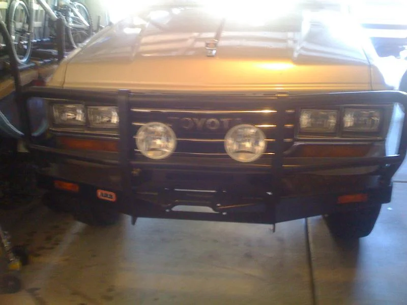

Dave I'm not sure if my bumper was made by ARB or not but it is sure close. If you want to use it as a pattern I would gladly loan it to you. https://forum.ih8mud.com/40-55-series-tech/568518-bullbar.html

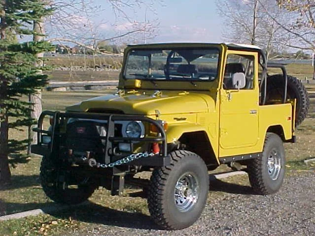

Lee sent me this picture and I think we both agree that something like this would be idea. Neither of us knows the make, what do you think Dave?
I found that pic through a Google search for FJ40 bull bar. No idea who the truck belongs to or its manufacturer. As Sully says, it's a simple design and pretty close to what I'm looking for, and not very different from some of the 4+ bumpers.

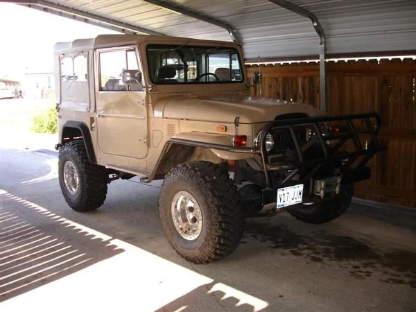

Go to Harbor Freight and buy a cheap ass bender + 2 joints of 1 1/2" black pipe from McCoys + 1 Saturday afternoon + welder +2 cases of beer = the creation of your choice..... That's what I did...:wrench: may not be perfect, but it has knock down power.. that's all I care about......
