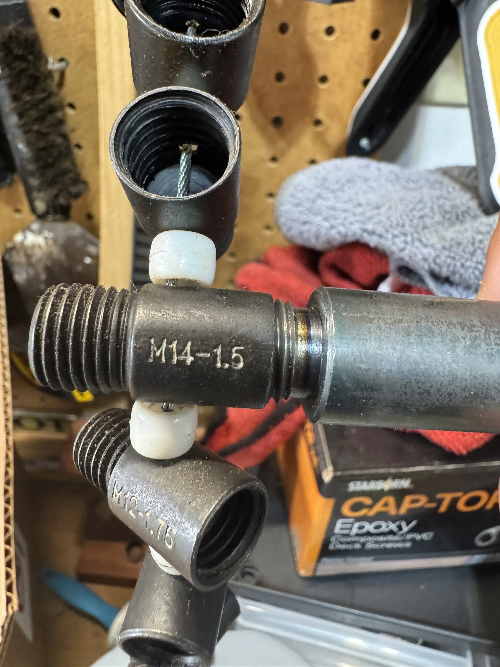

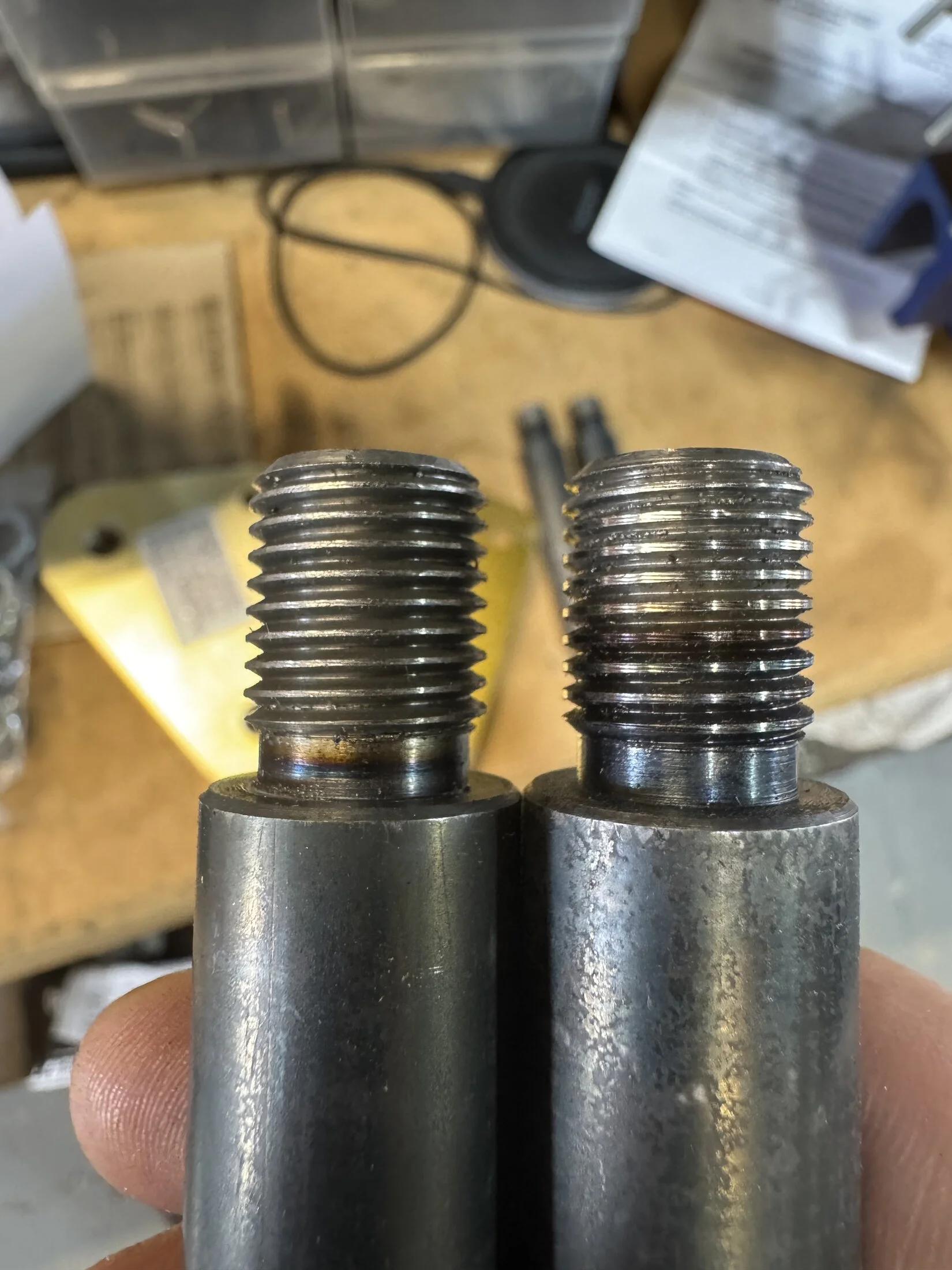

I went ahead and bought their shackles even though they’re quite spendy with the thought that the full kit will tie it all together. Upon first assembly I realize that they didn’t even cut thr threads on the pins and they absolutely will not thread into the side plates even with the help of my vice. As you can see, there appears to be some sort of heat treatment going up the thread body and I confirmed with my thread gauge that yes, this isn’t going to fit.
The front shackles went together fine as did one of the greasable pins. However, for the second pin kit the damn pins won’t even start in the plate.

So far, it’s one rear shackle kit and one of the pin kits that are bad, which isn’t good odds. The one shackle has 3 of the 4 pins with bad threads.

I think this is more that they didn’t cut the treads right in the first place. If you look at the photo, the ones (3 have the same issue) that don’t thread have a thicker thread cut which could mean worn out tooling. Any way you look at it, it’s crap quality control and for the other plate to not thread as well means they are statically terrible at threaded processes.
