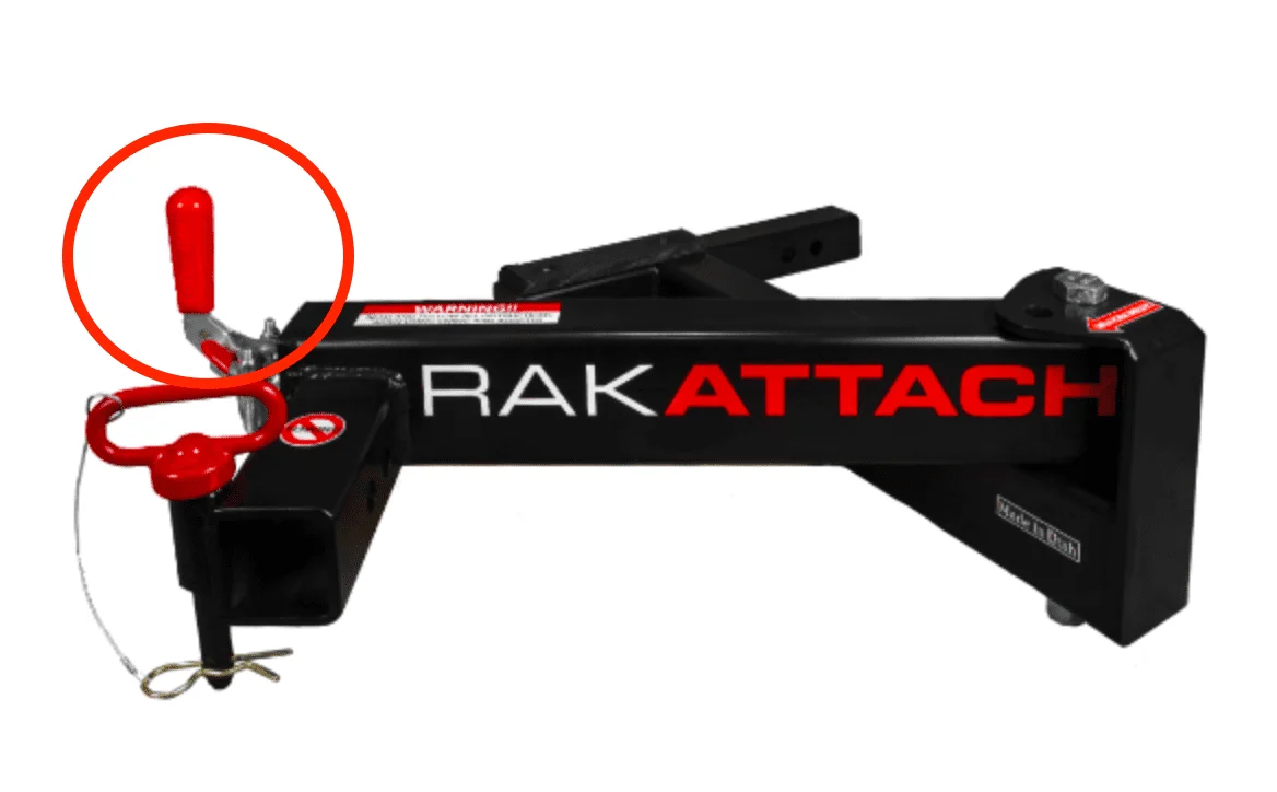

As mentioned above the Yakima works but the swing arm release lever hits the tailgate so that's out.
Next, don't go with a rakattach. Rakattach developed one for Kuat which is the Pivot V2. The Pivot is longer than the large rakattach by almost 2". The Pivot has a better antirattle setup and swing arm locking mechanism as well. Unfortunately as pointed out above seems when the tailgate is open it will hit the Pivot V2. I have one on order from my bike store and will try it out just to double check and see if anything can be modified.

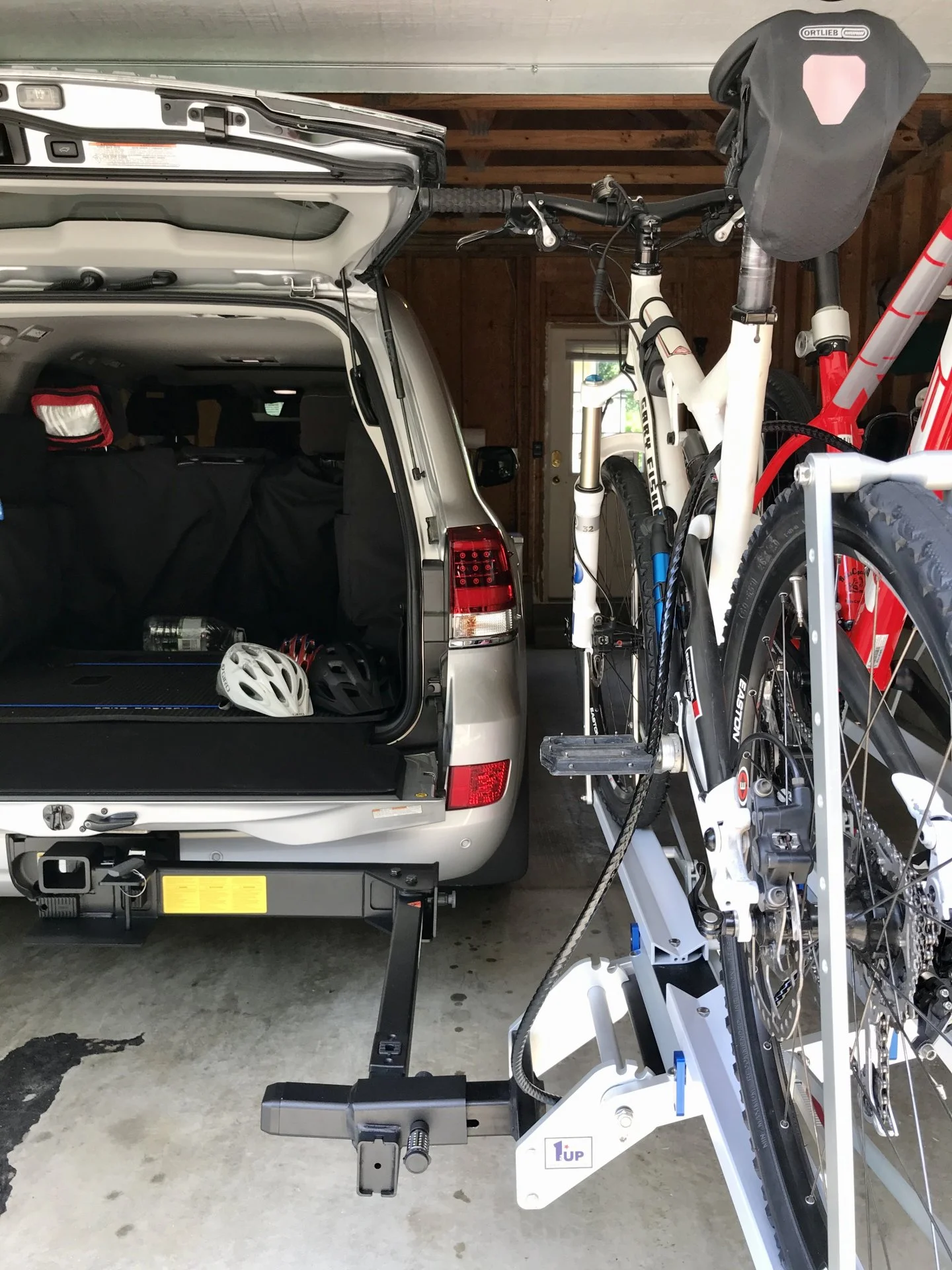

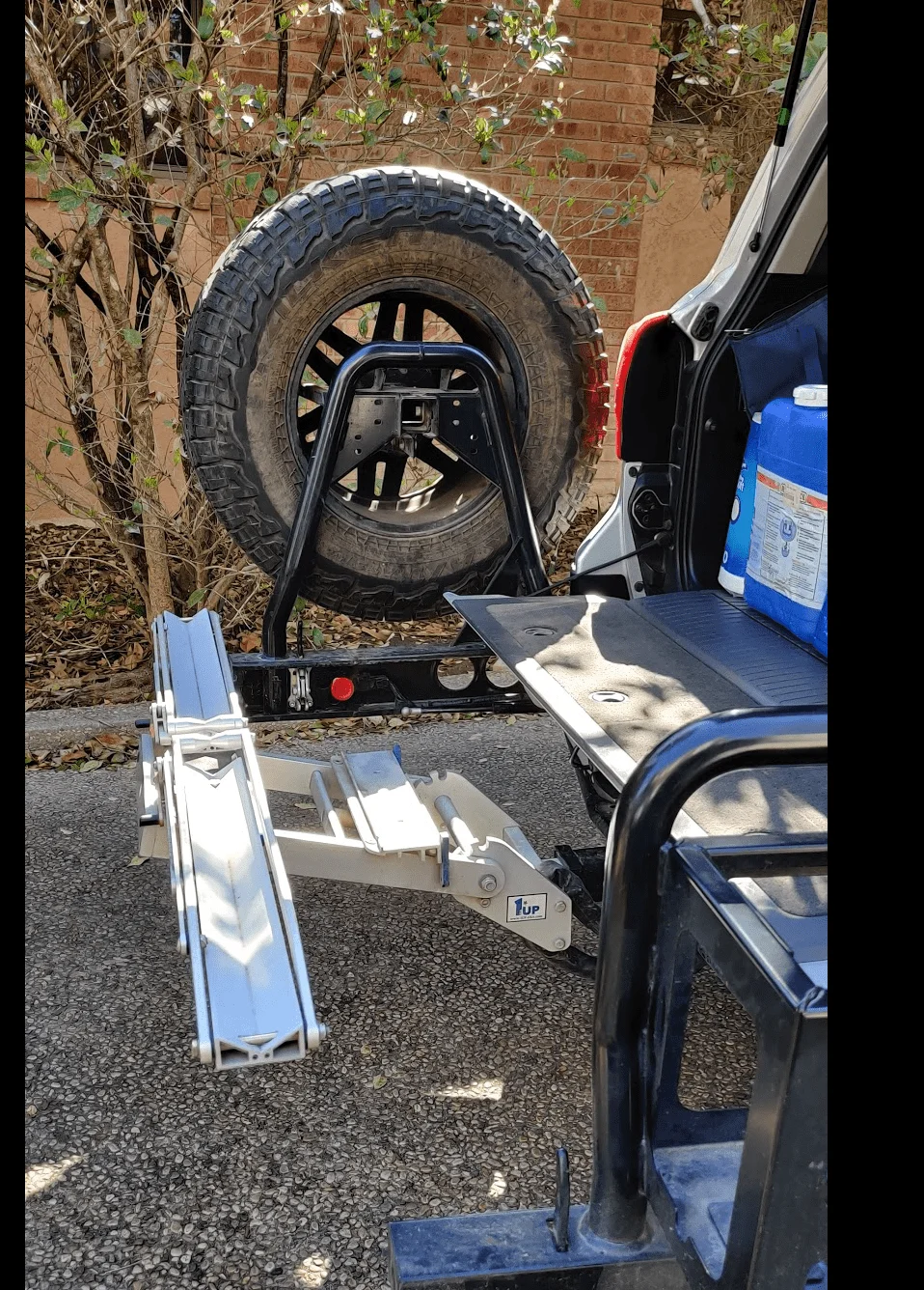

My current setup and a separate long-term solution. Current setup shown in image 1 and 2. Hitch extender plus the removal of the inner tray gives me access to the back without removing the rack. In image two, you can see I can position the rack so I can use my axillary back up light. I could also completely tuck the rack under for a pretty clean look ...didn't try it, but looks totally doable.

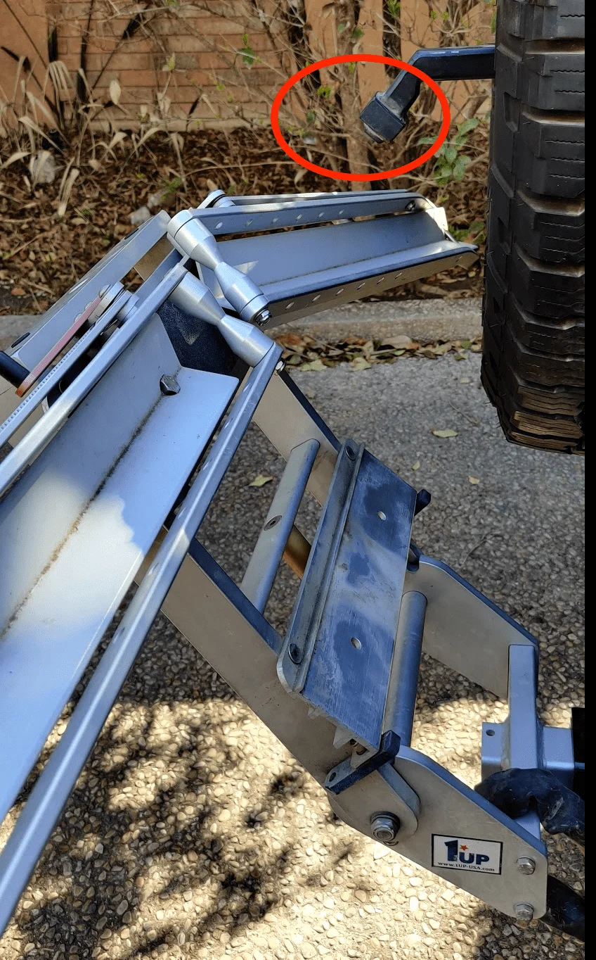

Third picture shows a potential long term solution: remove all four trays from the rack, bolt two trays to one swing arm replicating the fold stop plate. Mount the other two arms to the heavy duty bracket that currently hold the useless-to-me Jerry can holder (getting an auxiliary tank soon). The upper arms could easily fold down too ...and I might get something useful attached the rack to replace the Jerry can holder. Wife is pushing for outdoor shower/bike washer.

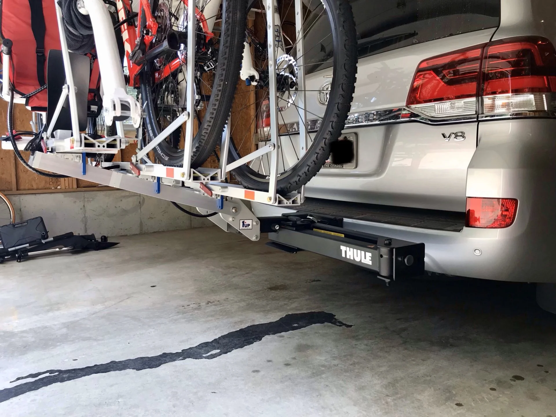

Update: purchased the Thule after testing fit at a local outdoor store today.
The Thule fits perfect!
No contact with the tailgate when the arm is open OR closed.
1up racks interface perfectly as well.
The Thule is rated to 350 pounds and is solid and rattle free. Even the pin doesn't rattle. I love it.

I recently received the 1up hitch rack, and it is very well made. Installed the rack in the 2, 3, and 4 bike configurations to check everything for proper fitment. I didn't take a picture, but in the 2 bike setup empty, the tailgate slightly contacts the rack. Now if bikes were in the tray's, you would have to use the tilt feature to gain access to the back of the truck. I'm unsure the tilt will be adequate in the 3 or 4 bike to clear the hatch alone.
Still learning the rack, but I think I'll be missing the swing away feature of the Yakima hitch mount it replaces. That said, I'm wary of the added stress any attachment that adds distance to clear the tail gate. Just

Thank you for posting this photo and the direct user feedback regarding the fitment of the Thule 9037. After reading your above post, I decided to go with the Thule - it has the most capacity and I did not want to modify anything to make a swing-out fit without interference. I found one locally BNIB and scored it for a considerable discount off of retail - these also seem to be out-of-stock like everything else right now.
This evening I test fit it in the garage and can confirm no interference with the tailgate or any other component on the 200. Plenty of clearance all around. I’d also like to echo your comment on the rattle free design - it is absolutely solid with no rattles. If installed correctly, the 9037 feels like it’s welded to the hitch tube.

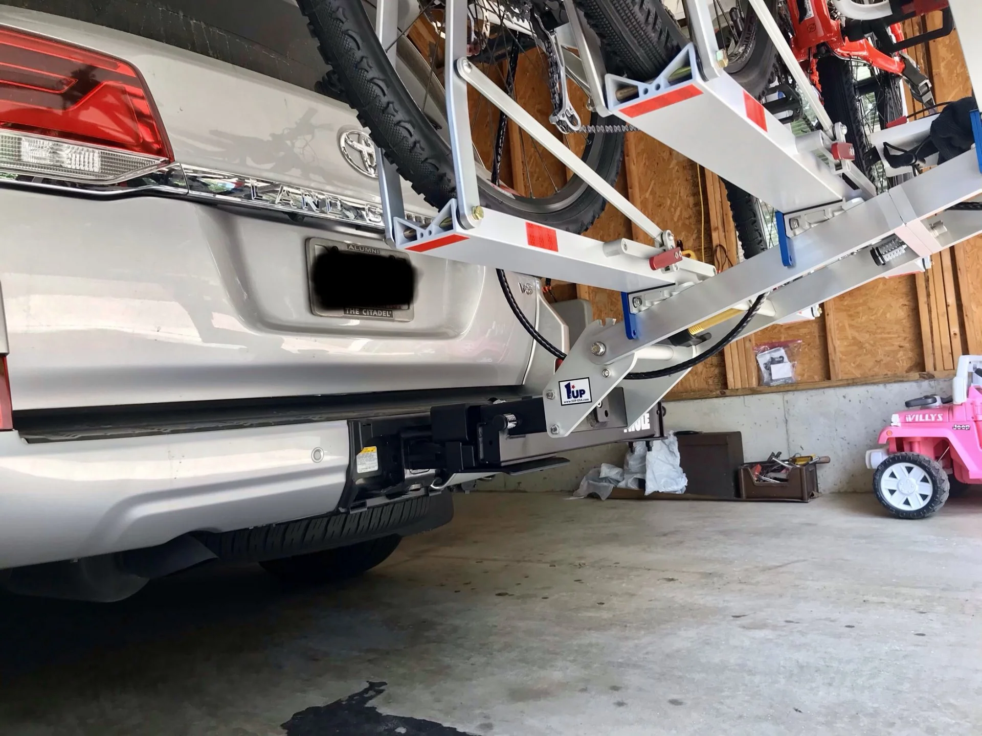

As promised, some shots of the Thule 9037 + 1Up Super Duty Double + Super Duty add-on single. Solid as a rock with no rattles. As mentioned above, the 9037 has plenty of clearance between it and the dropped tailgate. No modifications need to be made to the Thule to make this happen. The entire rack swings out of the way of the tailgate and rear hatch - no interference whatsoever with any component on the 200-series (tailgate, rear hatch, bumper, taillight, etc.).
Thanks for the discussion in this thread and for recommending the Thule. I’m very satisfied with this configuration.
As promised, Thule 9037 + 1Up Super Duty Double + Super Duty add-on single. Solid as a rock with no rattles. As mentioned above, the 9037 has plenty of clearance between it and the dropped tailgate. The entire rack swings out of the way of the tailgate and rear hatch - no interference whatsoever with the 200-series.
