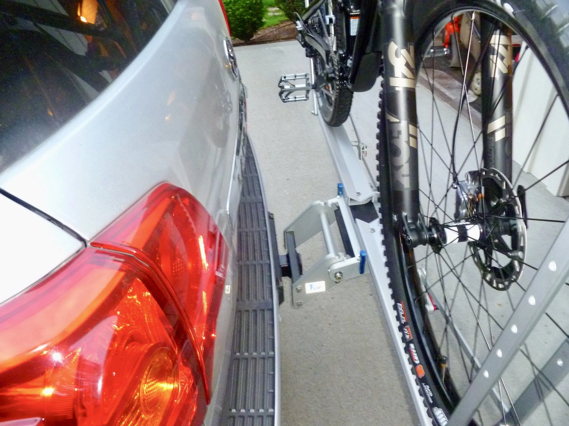

Hey all,
Recent convert from a '19 4Runner ORP to a '15 200 series here.
Went to install my 1up hitch rack and a (medium size) 1Up Rak Attach to my Cruiser, and realized the Rak Attach is in the way of the tail gate (when dropped, tail gate would hit the pivot point of the Rak Attach).
My question is, has anyone here tried the size Large Rak Attach with success on a 200 series land cruiser? Does it allow you to drop the tail gate when the rack is swung out of the way? Here's a link to the product, FYI.

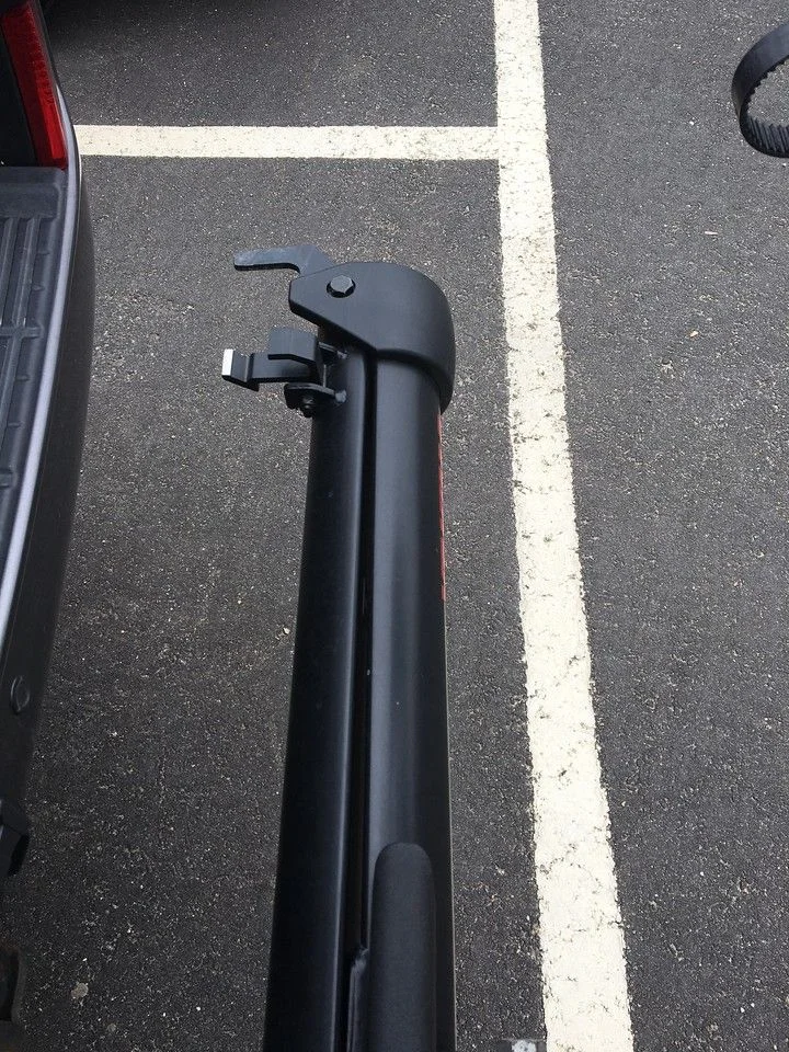

I use the Yakima version as i tried all of the others and the Yakima worked the ‘best’. Love the ability to swing my Kuat 2 and 4 bike racks out of the way.

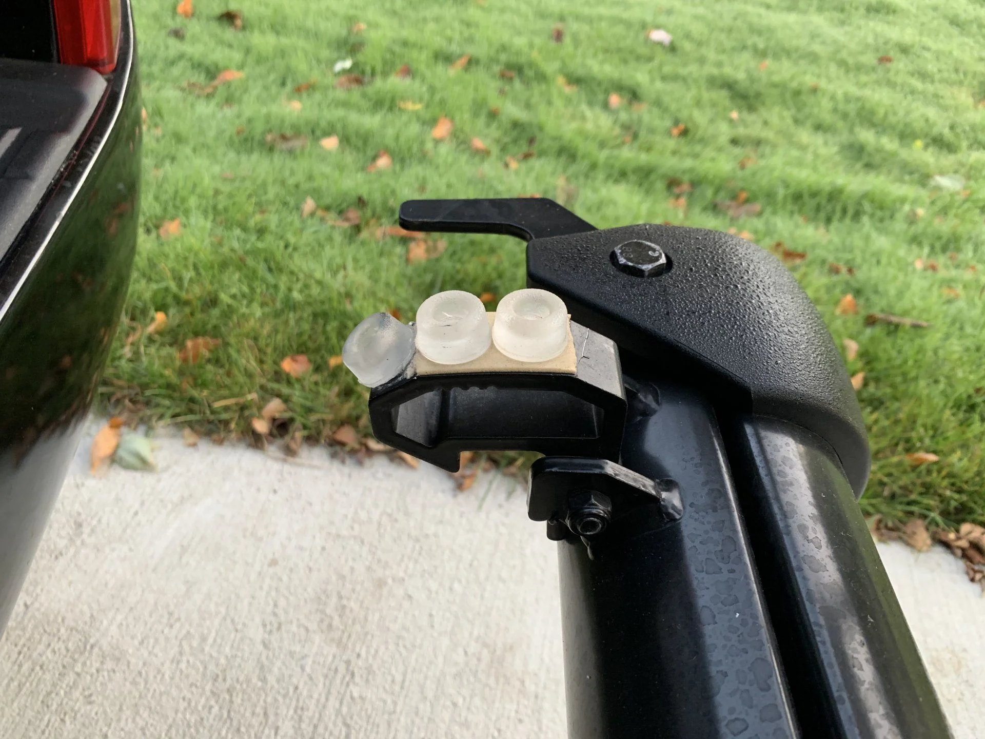

Still had to put a pad on the swing lock handle and it still dented my tailgate. Oh well.

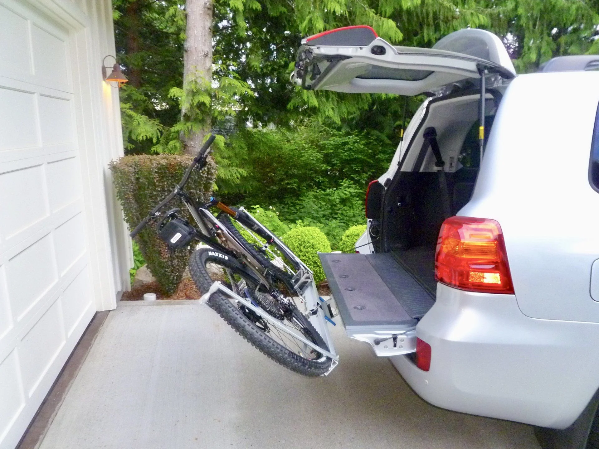

I run a standard 1Up 2 bike unit (no Rak Attach) on my LC with no problems. The 1Up folds down and allows complete access to the cargo area, even with 2 MTBs loaded. The Rak Attach would certainly be easier to use as lifting the 1Up while loaded takes effort, but it’s doable. Hope this helps....

I have the Kuat Pivot. Basically the same thing. I think RakAttach might actually make it for Kuat. Anyway I cannot drop the tailgate on my 200 without interference From the pivot when I swing my rack all the way out. I only need a few more millimeters and it would clear. No issues on my pickup. I was super bummed. The Kuat Pivot only comes in one size so I’m not sure if it would be considered a medium or large compared to the RakAttach. Hope this helps.

As mentioned above the Yakima works but the swing arm release lever hits the tailgate so that's out.

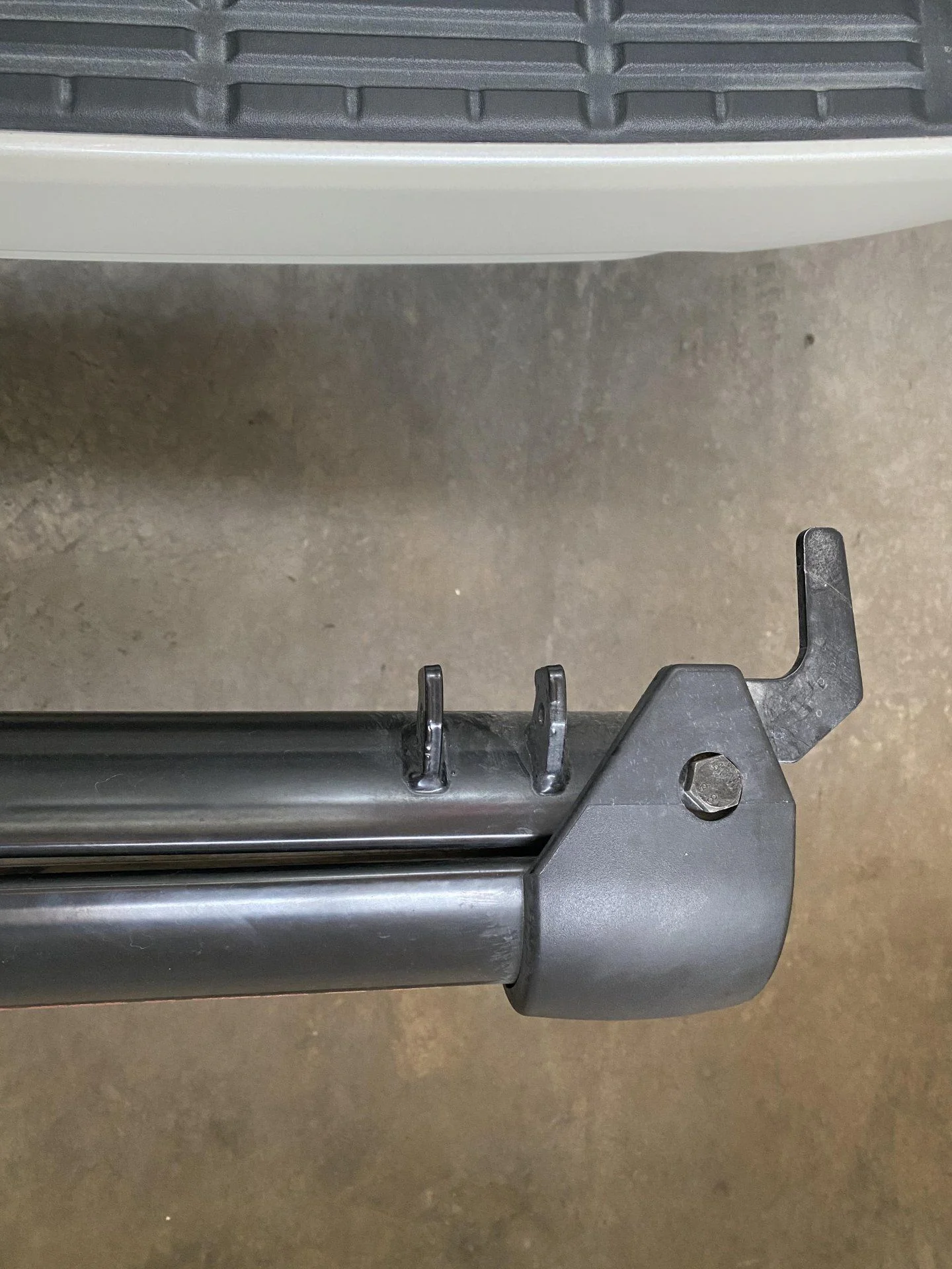

I have a Yakima backswing. I modified the latch so it doesn't hit the tailgate. It's not structural and still completely usable. The backswing is solid, I use a yakima holdup and holdup evo +2. The rack is terribly heavy and with 4 bikes is even worse. not really happy with the evo +2 but the backswing is really good so far.

Sweet idea. I will have to take a look. Right now i have paddling on the latch but still dimple dented my tailgate. I use the Yakima with my Kuat NV every day with 2-4 mountain bikes on the back.
Yes, nothing like getting a brand new part and taking an angle grinder to it! Just make sure you cut enough away, the tailgate sags a little more with weight on it. I think I skimmed a little more off the bottom after that picture.
I run the Yakima swing attachment. For a while I installed it upside down to remedy the interference, but then I just removed the latch, which I haven't missed one bit.
