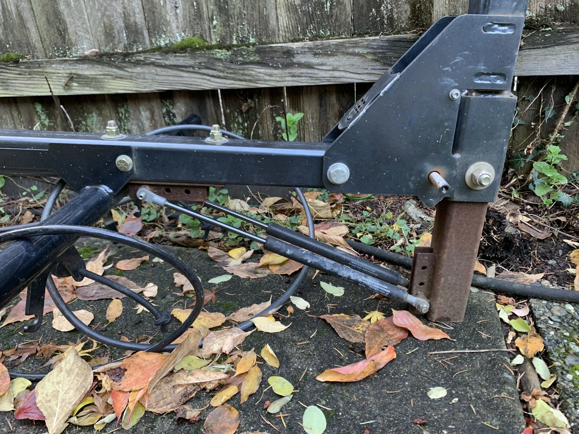

I'll grab a pic tomorrow. Basically I just took some square box that is hitch size and welded some brackets to the top of it. Then made a plate with matching brackets that I bolted to the upright (3 or 4 different holes to change the leverage ratio). Between the 2 are pneumatic struts, same as for the upper portion of a tailgate. With 4 bikes on it (reasonable weight, my racing bikes - road, gravel and XC/marathon MTB, and my son and wife's MTBs) I can lower and raise it one handed. With 2-4 bikes on it it will stay down or up unless you assist it with a little pressure in the direction you want to go. With one bike it won't stay down, but the struts are attached with a ball lock quick release on one end so I can just pop one end of them off. But if I know I will only have one bike I take my One-Up.
I did this because I didn't want to take all the bikes off to let my Golden out of the back during road trips. Works great. It's maybe 4 or 5 years old now? I don't have the newer Recon style with the self latching pin (which is slick!) but I did change out the upright pin to a ball lock quick release. I didn't paint it though so it is ruuuusty now :hillbilly:
@MTKID here you go. When the rack is lowered the struts compress and allow one hand lowering fully loaded. I still have to apply some upward pressure to keep it from just falling, but that allows it to stay down. And then just a little more upward pressure to raise it. Just enough to be an assit.
Nicely done 👌🏼 I love it. Mine has the newer pivot and my family’s bikes include smaller bikes that don’t weight quite as much but that is slick 😉

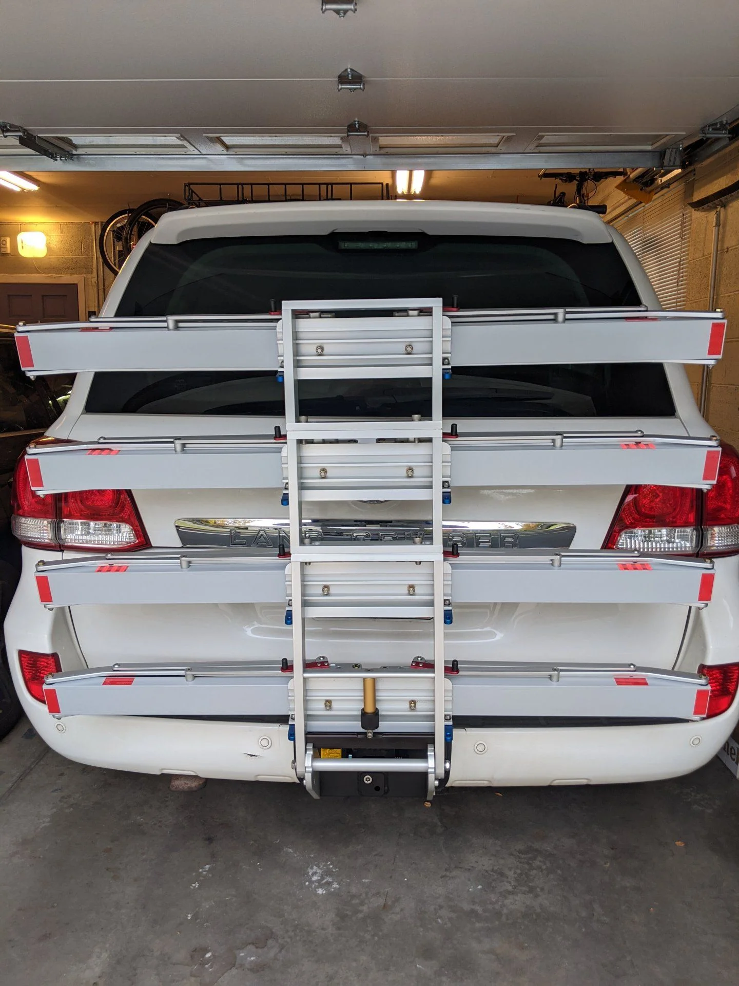

I had a 1up 2 bike for years. Then 4 years ago when both my kids were on adult mountain bikes added 2 more trays. That’s when for me the 1up really started to suck, the rack got huge and heavy. From there I sold both +1 trays and was offered the opportunity to trade the base 2 tray for a a kuat 4. Then went to a north shore-4 and haven’t looked back since. It’s less then half the weight of the 1up, holds the bikes closer to the truck, dosn’t block the brake lights, and is very easy to store off the truck. I’ve got probably 30k miles of hauling 4 enduro/trail bikes on the north shore now (almost 10k miles this past summer) with no issues at all. For more then 2 bikes can’t beat the functionality of the vertical rack.
Agree, the 1up rack is really only good for 2 bikes after that you got a huge backend.
