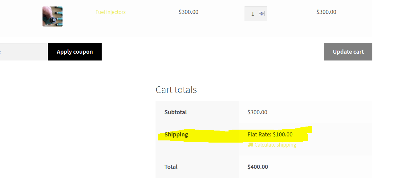

Sheesh....$100 just in shipping alone:confused:So the question becomes, is it worth the $400??

Here is what the website says:
Could be a mistake or something bc it gives tou the Calc shipping option. Im sure @dirtydeeds will chime in.
I can't believe it. There's no way I'd pay that. There are other options.

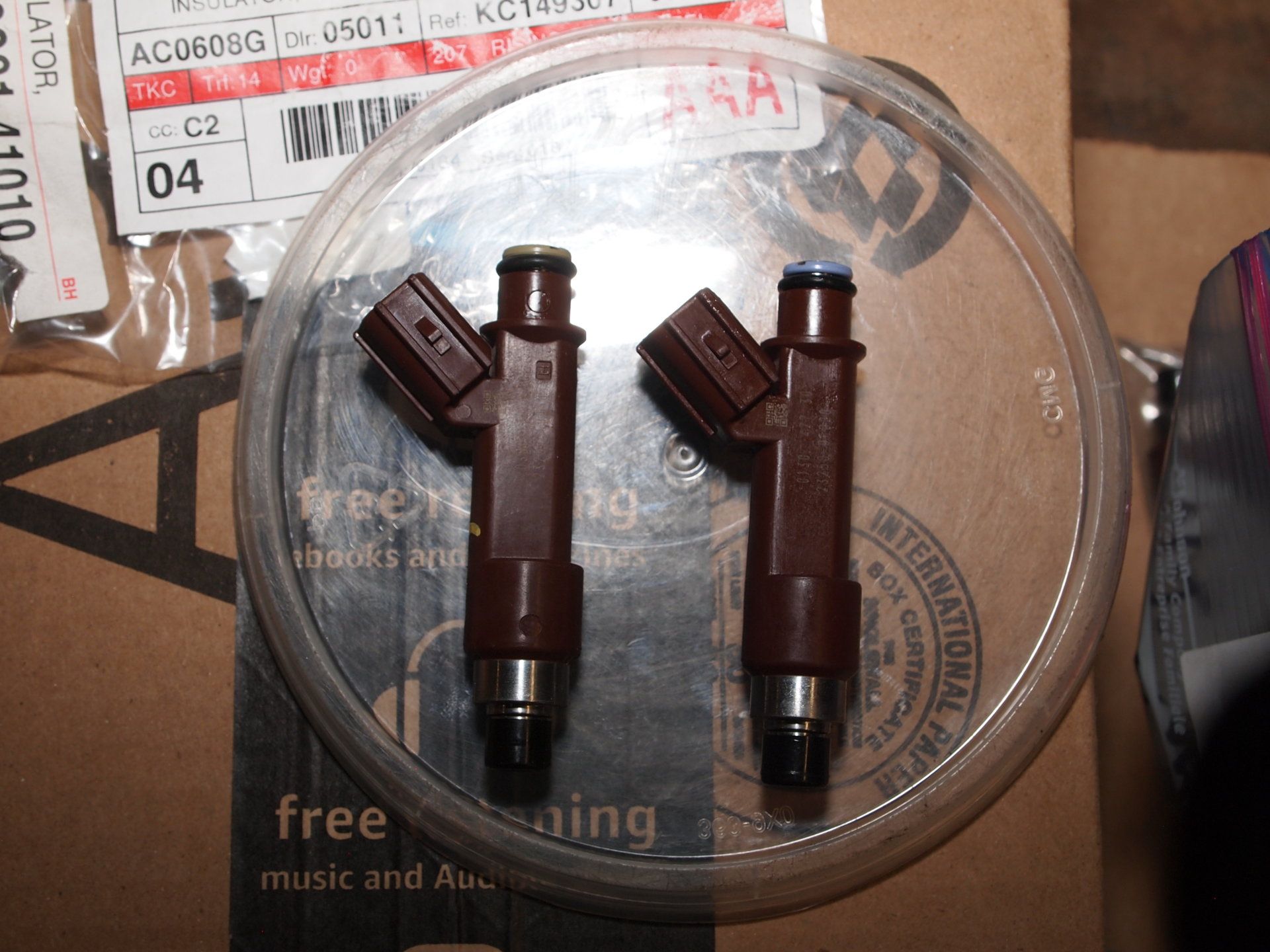

The 12 hole injector at only $37.50 each is cheap, too cheap. Authentic Denso are two to three times that. My guess is these are chinese made. Even Standard of USA Denso (see below) are ~$35 (retail) and then you'd have equipment, time and materials to modify to 12 hole.
We bought a set of Standards (4 hole) last year and they look the same as Denso except they have a blue ring at top.
View attachment 1747057 View attachment 1747055 These are Standards.
