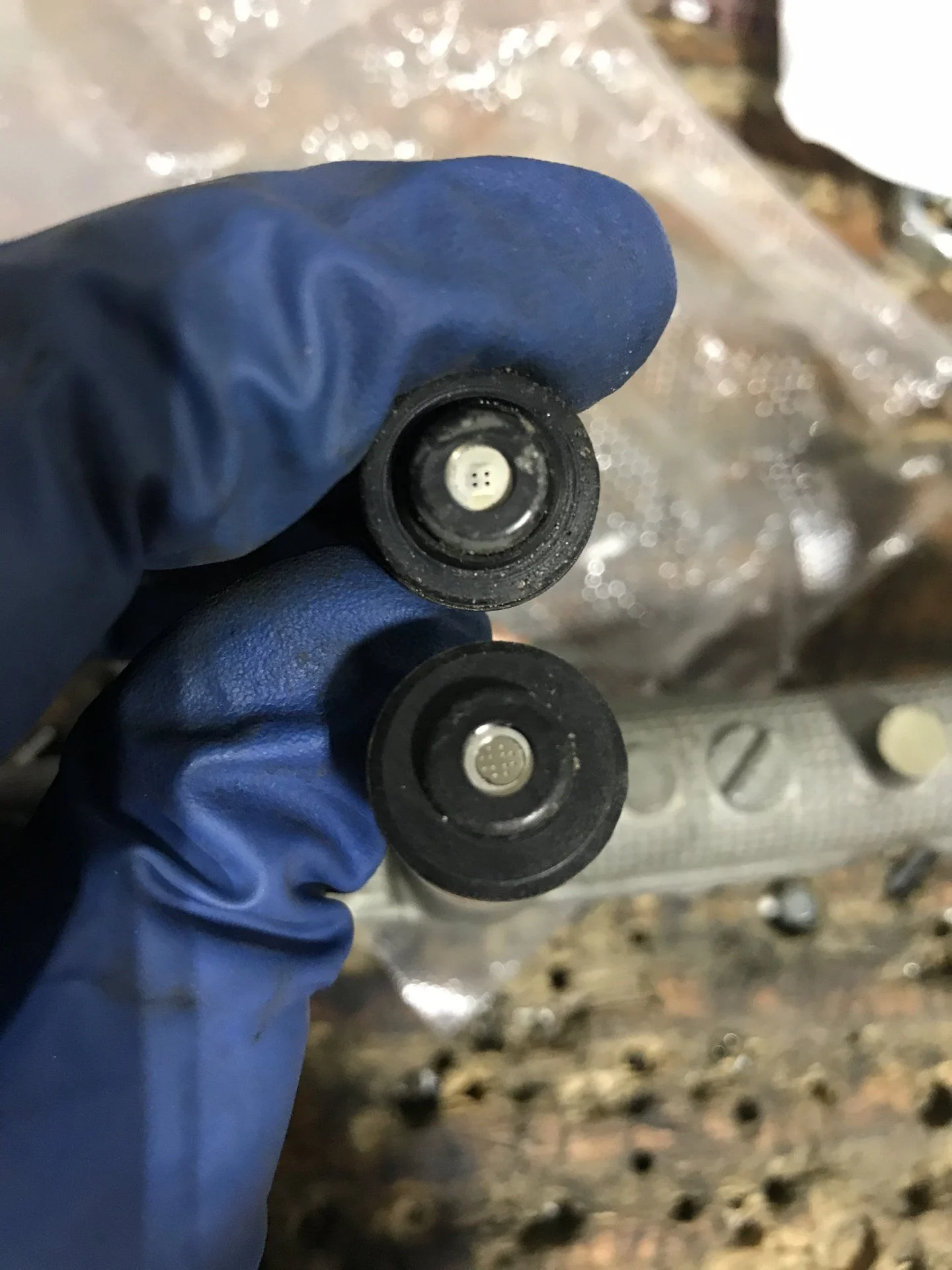

Injectors are in! Passenger side took about 15 minutes. Driver side took about an hour. Taking it easy on the way home today making sure they are seated well and no leaks. Ill fill up in the morning and then give a first tank rundown.

Hope you changed all the seals before installing. I didn’t... ended up spewing fuel all over the place when I was trying to leave for work.
Anyway I “upgraded” my 1UZ from the stock 2-hole injectors to the basic 2UZ 4-hole. I feel more torque for sure, but that’s likely because of the taller manifold.
However, it does idle noticeably smoother.
Did you install the Tundra intake on a non-VVTi model, and if so, did you remember to use a wire or something to tie the ACIS butterflies shut?
I actually bypassed the vacuum solenoid and run a straight vacuum reference to it. The valves open whenever there is less than 4” of vacuum.

I wouldn’t run a v6 injector on a v8. You want an injector meant for your vehicle. And flow balanced.
Flow matched for sure, but the v6 vs. v8 injector doesn't matter. An injector is all about flow rate and application. The tune puts them to use. There are 6 cylinder motors that require more fuel than some 8 cylinder motors. Thus, they use an injector with a larger flow rate.
Agreed. Without going into detail, What would sway me from FJ VS Tundra is ohm’s. Dead time. And all the other stuff listed on the label on the injector package. I’ve never seen FJ injectors and what their specs are. With similar Hp to our trucks they may be close. But I’ve had these injectors made specifically for our trucks. Not a v6 FJ and vice versa
