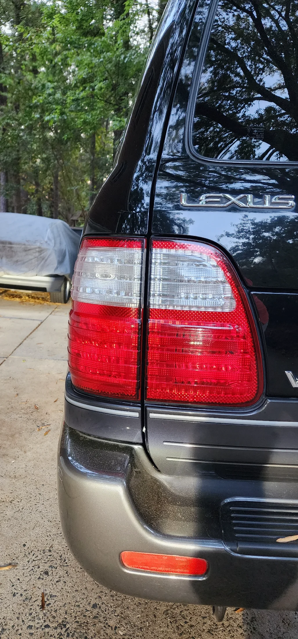

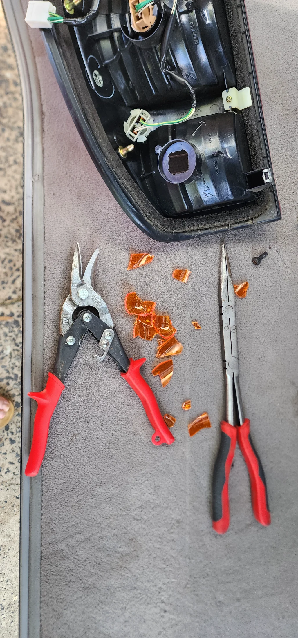

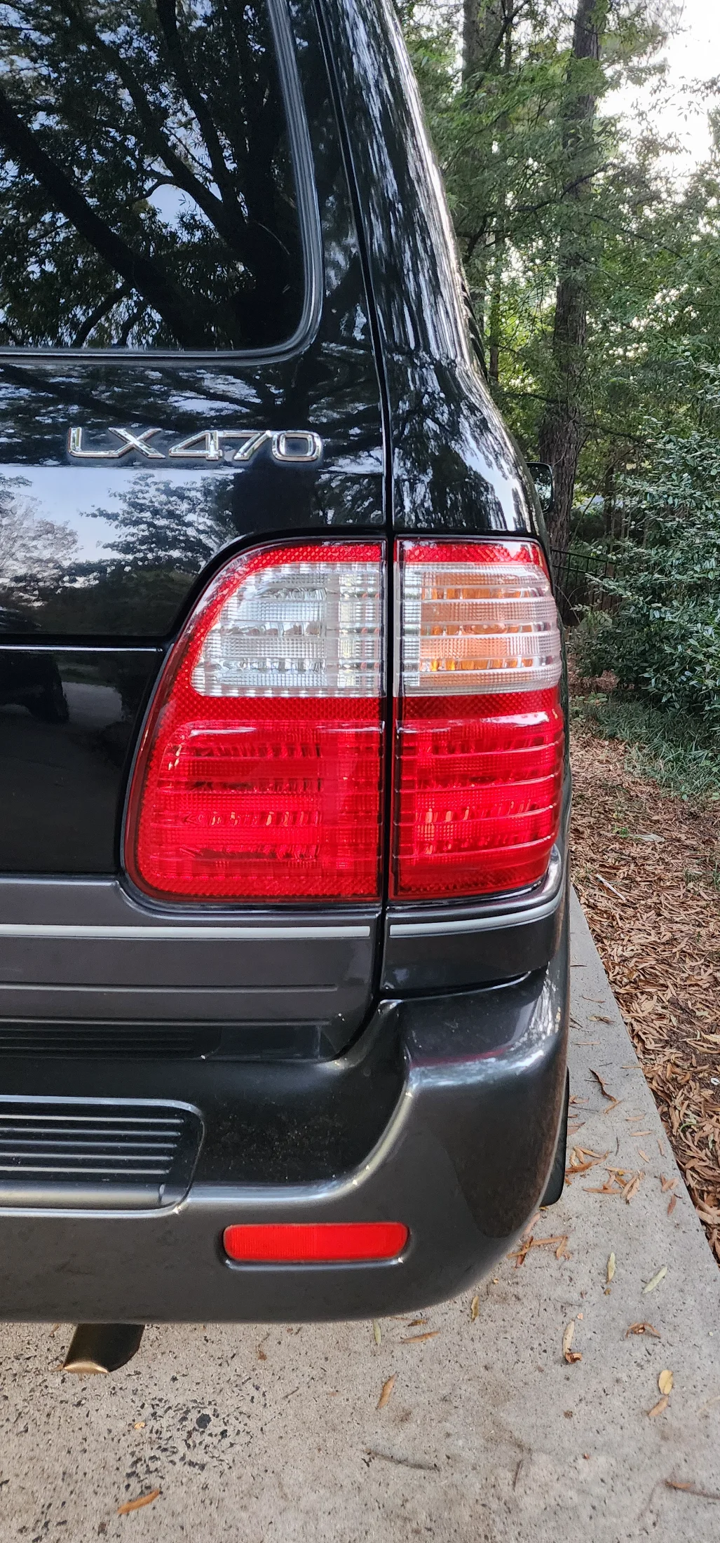

Well, I finally got around to trying this... It wasn't TOO difficult, but getting the last bit out that was attached with a screw was challenging. I has to drill it our from behind and epoxy the hole back. I'll do some more detailed pics when I do the passenger side this weekend, but overall I'm pleased.
