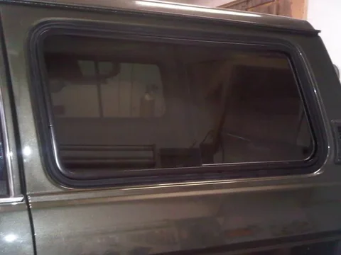

I got the SOR sliders and am really happy with them. I ordered the new single piece rubber molding with them. Installed in about 20 min each. I use the pull cord method with a guy pushing from the outside and pulling the rubber molding around from the inside with the pull cord. LOTS of glass cleaner sprayed on the rubber and window edge for lubrication, otherwise the rubber just binds right up. Don't worry about excces fluid from the glass cleaner, it wipes right up. They look great too, and my Rhodesian Ridgebacks can now stick their heads out and get some fresh air. IMG00279-20101230-1623.webp

THOSE LOOK GREAT!!!! OK so I think I have a few issues. My first being that the sliders I got from them are g lawrence??? They don't even look the same. Second would be that I have two black dogs and I clearly need atleast one brown one to make them fit.

Please put up some more detailed pics of the sor sliders...inside shots, latches, close up of the trim/seals, pics of the windows open, full side profile of the whole vehicle...you get the idea.
Very encouraging to hear someone had a good experience with the sor's. What do you think of their overall quality & finish??

Hence the word pilot, I am away from home for a few more weeks. I looked at the almost 200 pics I took of the restoration, but unfortunately no inside slider pics on my computer. I was very happy with SOR. The slider is a one piece aluminum frame, it was surprisingly rigid. My original window moldings were cracked and crappy . The ones from SOR were in a Toyota box. OE. The sliding window is in good quality felts, I think the window could be a tighter fit, personally, it will move kind of up and down, but it doesn't move from whatever position I put it in. So if I leave it open only 2 inches it stays at two inches all day. No screen! Big disappointment about that. I have an idea about glueing velcro around inside window frame and having a removable screen. I wanted tint, and this is dark to see in but I can see out and have great visibility. I will email home and see about having my wife go and take a few pics, and will try to get them here.

"I think the window could be a tighter fit, personally, it will move kind of up and down, but it doesn't move from whatever position I put it in." Does that mean it moves in the window opening or does it move in the frame of the slider. Mine don't fit in the stock opening. I actually ground 1/8 inch off the outer flange of the slider and it still doesn't fit exactly and that's without the gasket in place. Did you have to straighten the pinch weld also?
for tat2matt - the glass moves in the opening, just a bit. I had no issues the pinch welds on the window opening. I don't recall about the size of the whole slider unit in relation to the window opening. I do remember wishing I'd sprayed more glass cleaner as a lubricant in the groove of the gasket BEFORE I installed the slider unit in the rubber gasket. Then I slid the whole unit against the upper edge of the window opening first. I slid the top in first because I wanted to minimize the damage to my new headliner which as you know wraps around the top edge of the window opening. Then with Scott pushing from the upper outside we worked the gasket around as I pulled the cord out. Hard to describe if you can't see it. There is a lot of working the inner lip of the window gasket to smooth it, and pull it up and around the steel window lip.
I've asked for better pics from home, will see how they turn out and will post them to a link. I can say that there is a tremendous amount of binding and resistance between the aluminum slider housing the rubber gasket and the outer window edge all at the same time. I can't stress enough, the rubber gasket needs a lubricant, and glass cleaner is clean and residual free and works like a charm.
