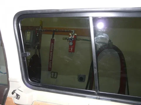

I had a couple of pics earlier, but didn't put in more as I was away. Since then I've been on a big road trip/hunt into northern BC. Snow, sleet, rain and sunshine - normal Sept/Oct weather. I slept in the back with the sliders open, and I couldn't be happier. They work really well, and the latches are solid. Good security since I had a truck full of guns too. I did get a bit of water in the from the tracks the couple of times it snowed that wet, heavy 2" flakes stuff that is so thick the headlights wouldn't melt it, and I had to stop to clean the snow so my wipers would work. Enough talk, I've got pics from in the shop tonight. SOR Rear Sliders 004.webp
I seem to have run out of attachments. I had one more of the window open and one more of the dogs too. I'll send this and try to see if I can attach a second message. I hope these pics help you guys out. I can add, it takes two to install these well and properly. No way I could have put them in by myself.
The windows are a great fit, and the Elk is what the dogs saw from the back. Really glad they weren't out of the truck, would have been hours getting them back!! They are the greatest for the dogs, they love em!:D

Great looking truck Pilot, question did you adjust your pinch weld at all? I adjusted my DS and I'm thinking about taking the window out and doing it over with less angle. I'm wondering if that has anything to do with leaks.

I didn't touch anything on the truck. When I installed the windows, I put the window in the opening without the rubber moulding. There wasn't much clearance, the trick I believe is to not have any 'bunching' of the rubber moulding. I have a bit on one point of one window. I think I should have pushed the window out and redone it.
