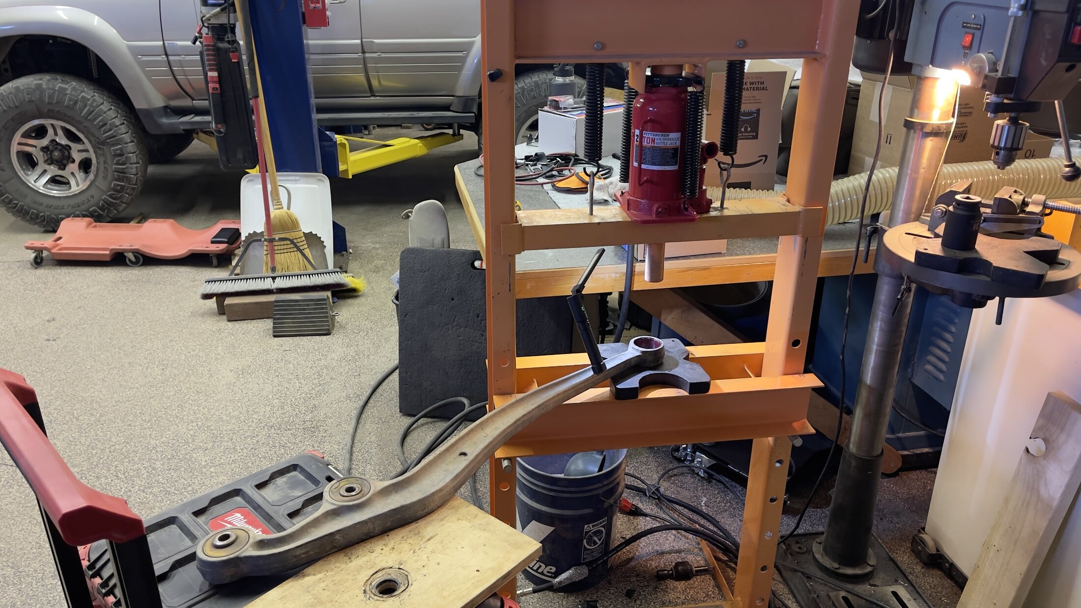

I hole sawed out the bushings in a drill press, hacked the thin shell, and used a 20ton pneumatic Harbor Freight press with foot pedal (key if you’re soloing this adventure), and a couple Pittsburgh metric sockets. Vice won’t work, other than to hold the arms…
This was the front radius arms, but process was the same for all ten in the rear.

I wouldn't do it with anything less than a 20 ton shop press, a good set of press plates and properly sized press dies. I'm happy with the set I got from Trail Tailor.

I did it with a 12 ton as well, but at full load the bushings didn't budge so I swatted the top bar of the press with a deadblow hammer and that got things moving.

Properly sized bushing sleaves to press out the old ones is critical. A set of sockets will generally get you close enough.
Tap the control arm with a steel or brass hammer gets them moving too.

Nice move. If you also have an engine hoist it's a great way to hold the other end of the control arm at the right height (especially when it comes to the front arms). Stacking things to the right height works too but When the old bushing starts to move it sounds like a shot gun and anything not secured on the press/arm is gonna take flight. wear ear protection.

Like everybody said, these suck to press out. I like to push out the rubber with a press, cut the outer metal sleeve of the bushing with a sawsall, and then pressing the new bushing in. You can do it with a 12 ton
I did this method today and nicked where the bushing goes in with the Sawzall. Should I fill this in with steel stick or something? Don't want to sand it down. See pic below.
