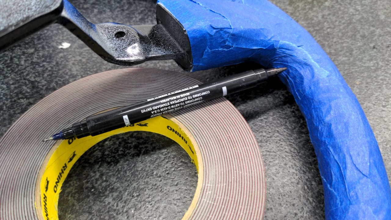

This time I thought I would try making a pattern with several layers of painters and masking tape.
Here is the wheel I am going to cover--actually for the first time because this wheel never had leather on it--just a textured foam in grey. I've de-rusted and covered the wheel with blue painters tape.
I hate rust, even where I cannot see it, so I primered the metal.
I ran a little short of time and rushed the finish coat, leaving an interesting mottled grey-black finish, which I actually kind of like.
Then a layer of regular masking tape
And another layer of blue

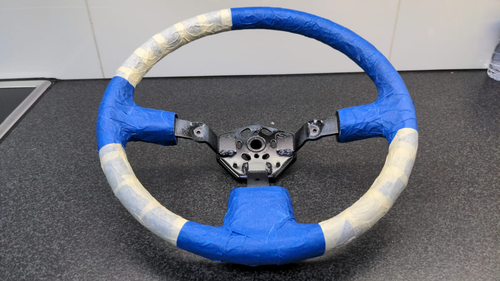

Here is the wheel with the several layers of tape on it.
Then I used a pen to mark a cut line towards the back of the steering wheel to be a little more out of the say.
And then marked it up each spoke.

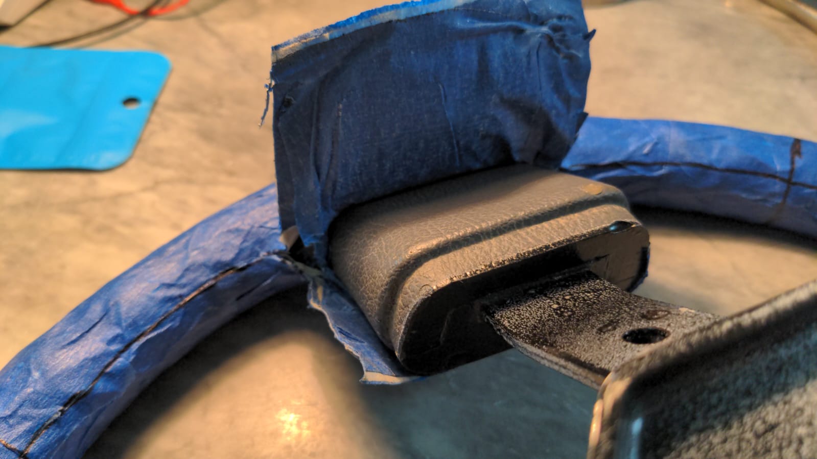

And then after cutting through with a scalpel, started teasing the layers of tape away from the wheel
In retrospect I think I would leave a little liquid soap on the steering wheel the help the bottom layer to release.

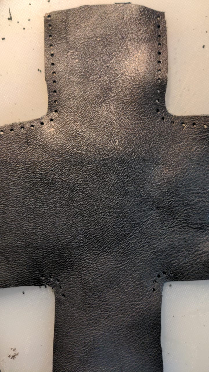

Here are the patterns laid out on a small camel leather skin
Then tracing around with a black pen
I try to leave about an extra quarter inch on the inside edge of the spoke so the leather overhangs just a little
The next process is to lay out the sewing holes.

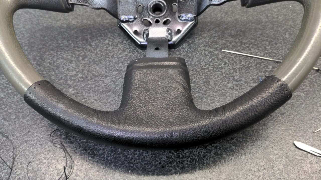

Re seams, yes. I wanted them towards the back side of the wheel and I decided to have one piece for each spoke and then the long strip across the top. From past experience sometimes you have to adjust things a little and this gives the most flexibility. I will start by covering the bottom, wide spoke, then do the two side spokes, leaving the strip on the top for last.
So here is the raw material:
I then generally start in the corners and work outward

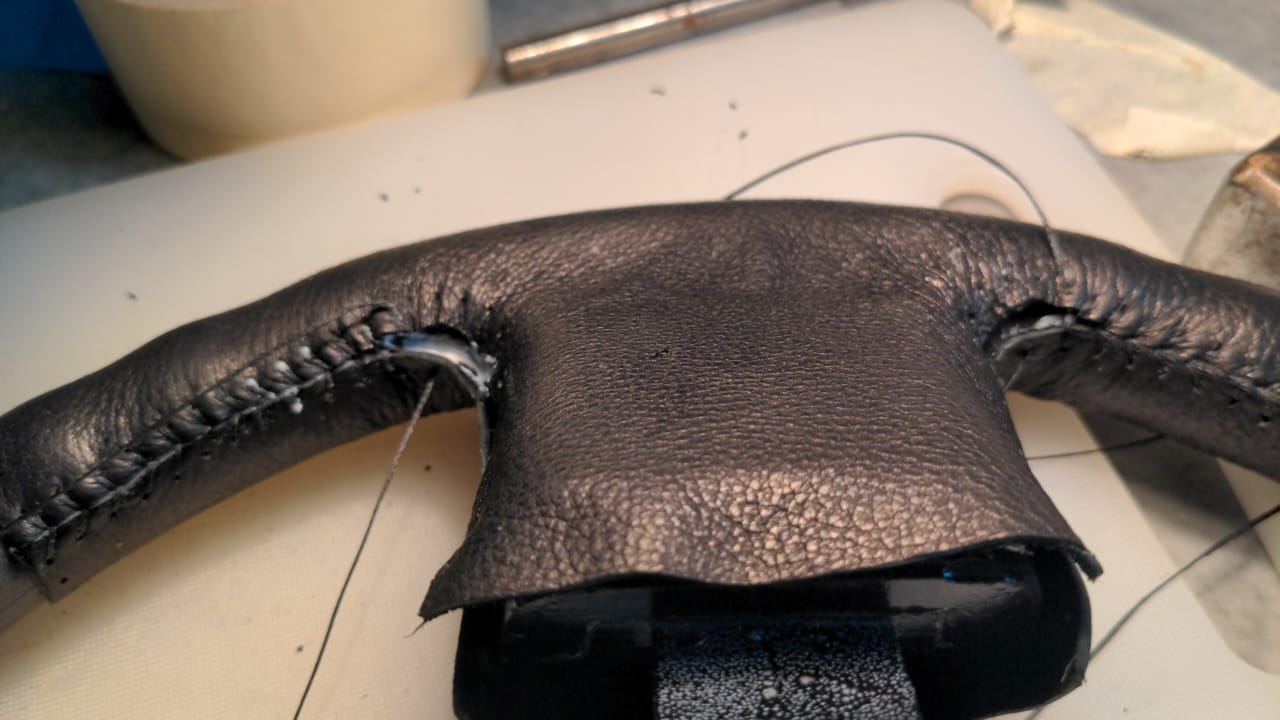

Now that I am ready to sew, I coat the backside with PVA glue. This is commonly used for bookbinding because it stays flexible and dries clear. Not sure how PVA works but is stays workable for some time and cleans up with a damp cloth.
Then it is time for the moment of truth
Leather, particularly thick, soft leather, is pretty forgiving stuff. It is elastic enough to deal with minor imperfections, especially with PVA glue backing it so you can slide things around a little.
I begin sewing at each end and alternate every few stitches.

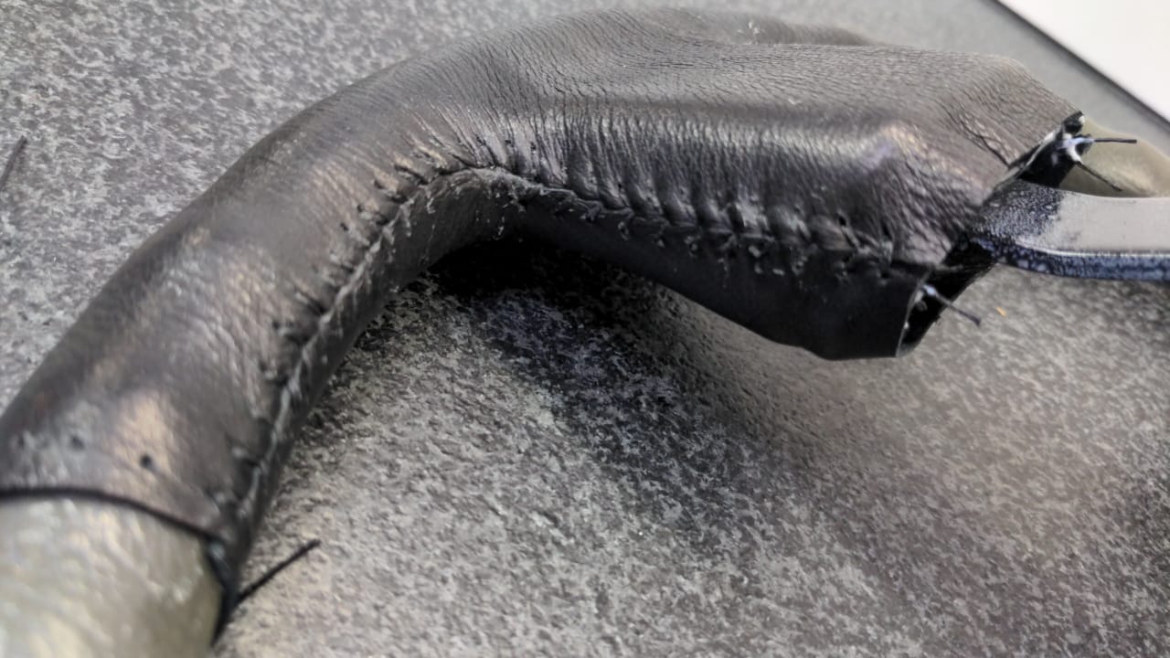

And with some fettling, the first segment is done:
Here is the backside:
And a close up:
To be candid with you, right in the corners I had to double up use of the holes despite taking care with the hole count. But as you can see, it is hard to tell--I'd say even impossible to see or feel when it is on the car.

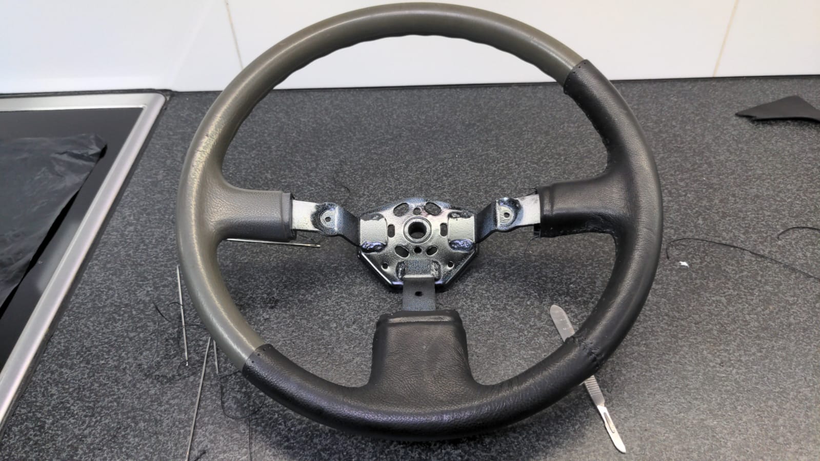

Yes for the simple just around the rim recovering. The generic without coverage of the spokes. Better than really awful old leather, but still not all that great. Here is a photo of an example of this:

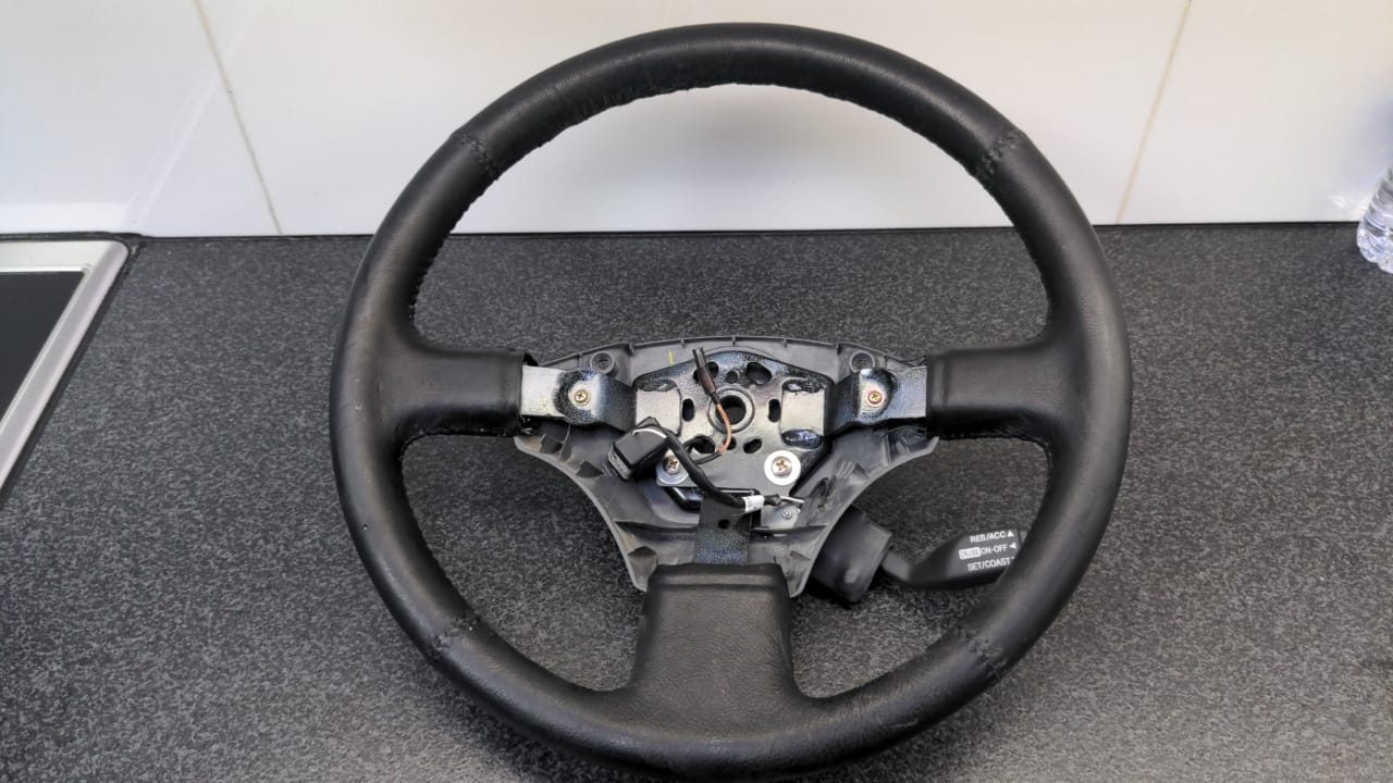

It is not perfect, but I like it.

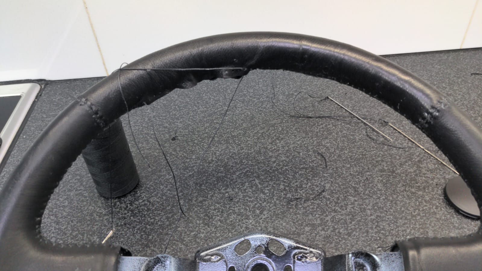

There is a bit of a learning curve. I, for example, managed to attach the wrong end to the last segment so I had to remove the left hand segment and do the sewing over again!
I finished covering the wheel yesterday
