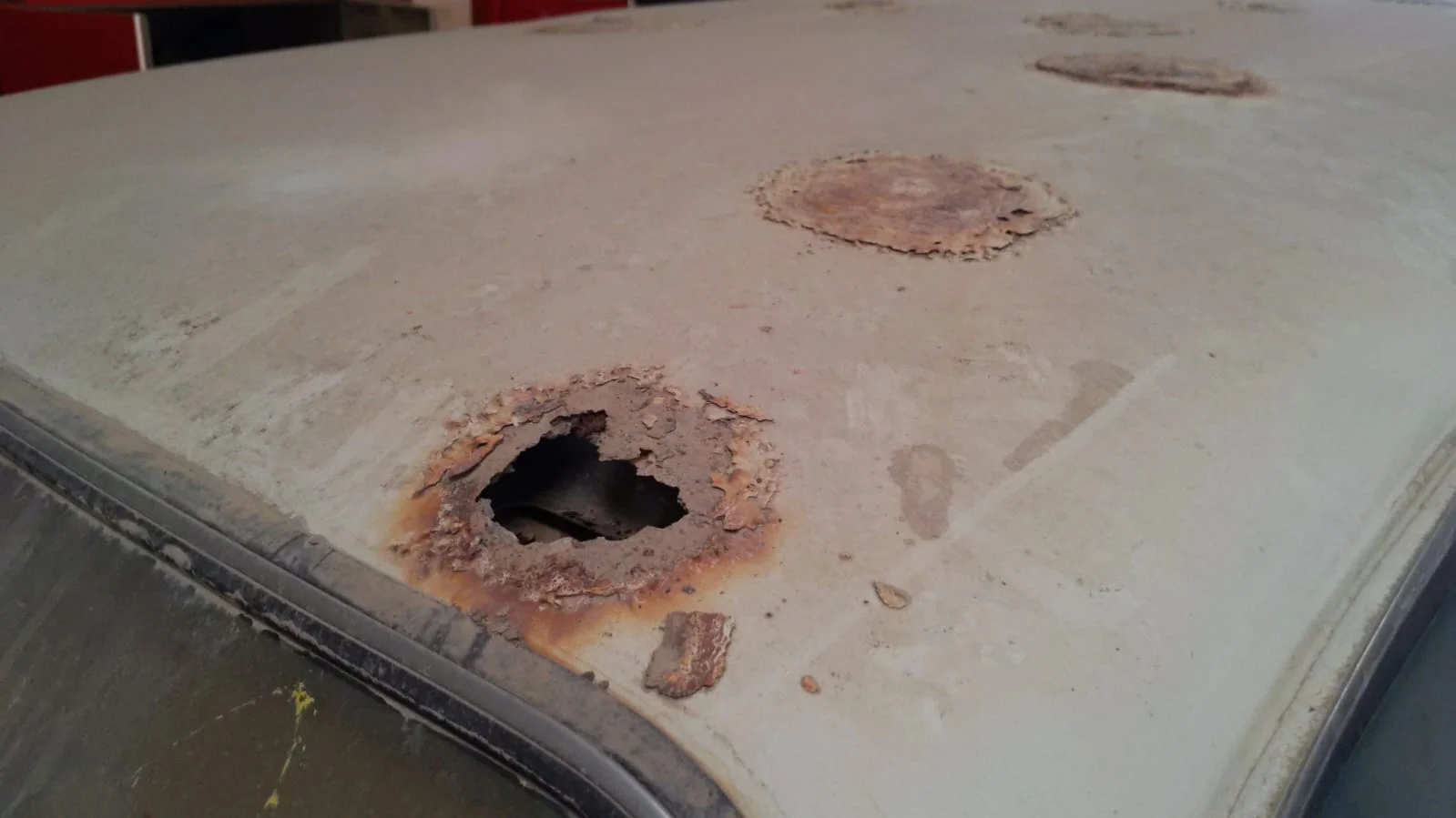

I've spent the last couple of days pulling stuff from a donor 80 in preparation for having the junk man come and drag off the remainder. The last thing is the roof.

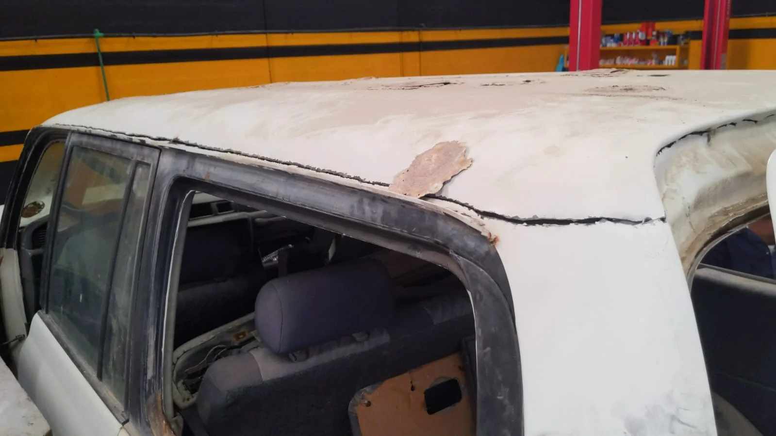

I made a mistake recently at an auction for a manual transmission 80 that turned out to have holes in the roof.

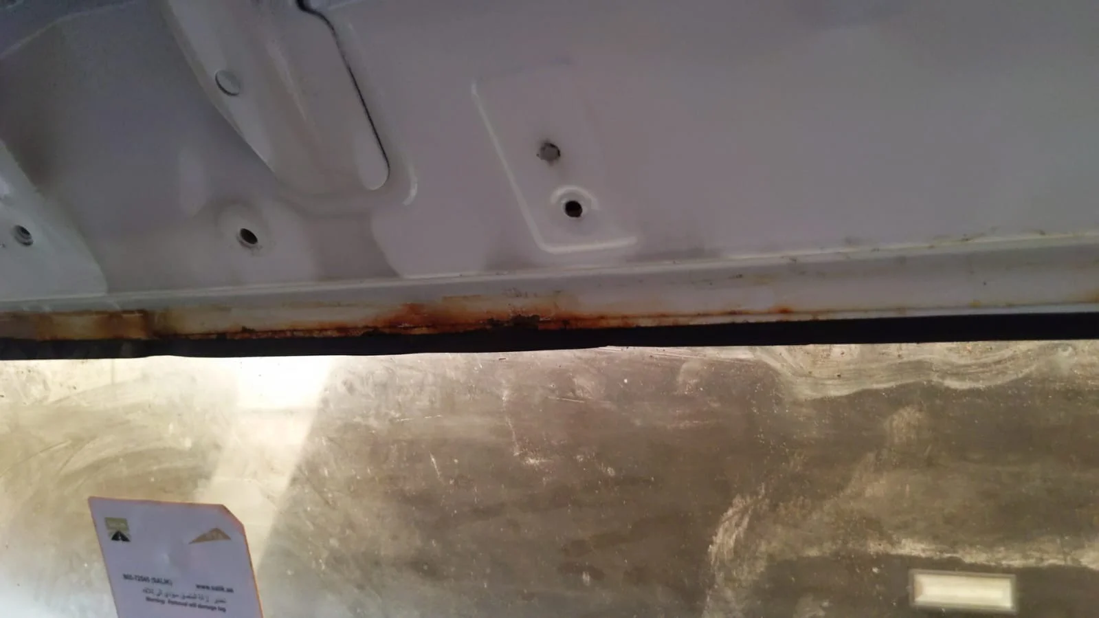

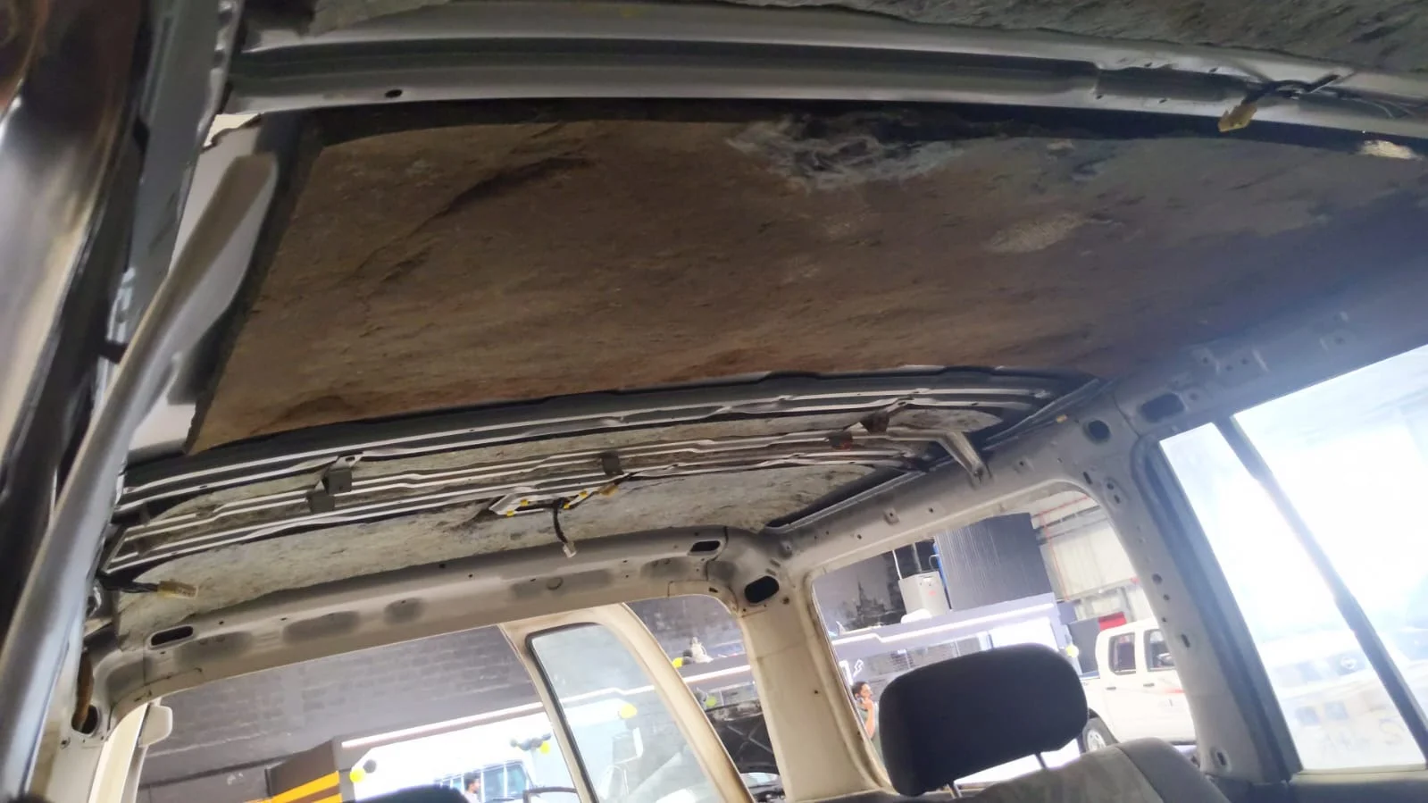

Everything else including the interior was pretty nice but the roof.... I call it the 'holy truck'.

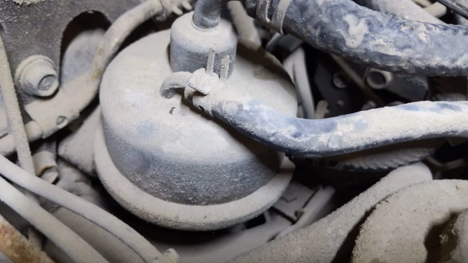

What to do.... Over the past few weeks we drained the tanks and changed the oil and the steering column to put in a new ignition lock -- the truck came without a key, and then it sat for quite a while. On Saturday the column went back in and I put a couple of jerry cans of fresh gas in the main and sub tanks, and we tried firing it up. No joy. This 1FE has a mechanical fuel pump and a carburetor. No gas being pumped.
I used a handheld vacuum pump and pulled the gas into the engine bay but even when primed the mechanical fuel pump did nothing. Resorting to squirting brake cleaner into the carb throat we succeeded in getting it to fire up immediately enveloping the entire warehouse in a thick cloud of desert dust. The radiator must have been completely loaded with it. The engine sounded pretty good and with a manual transmission there is less uncertainty about getting the driveline going so it kind of settled it in my mind that I am going to try to bring this poor old truck back from the brink.

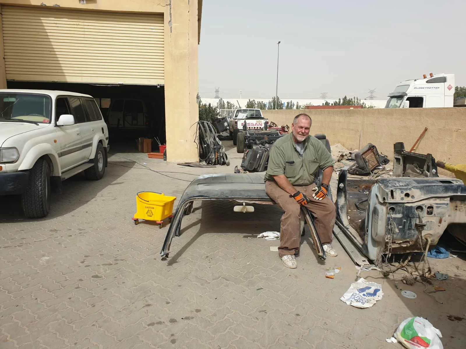

I went online and got an angle grinder (in retrospect a reciprocating saw might have been a better choice) and I spent yesterday clearing out the donor and today my friend came up from Abu Dhabi and we set to work.
The garage owner friend asked that I cut as far down as possible. Even though I suspect that his body guys will just use parts of the roof itself, I did as I was asked. The A pillars were by far the hardest to deal with.
The next most difficult was the D pillar (if that is what it is called), but even the C pillar had its challenges. There was substantial internal sheet metal in each pillar.
But eventually after most of a day of work and a dozen metal cutting disks the donor gave up its roof.

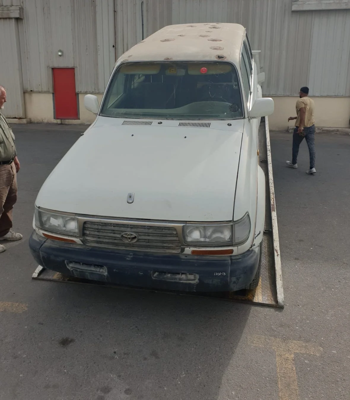

We then pulled the holy truck out and called the recovery driver to bring it to the other garage.

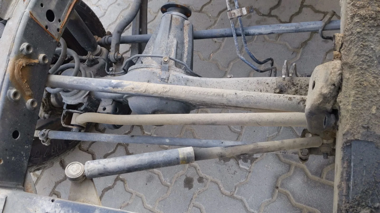

When it was up on the flatbed I had my first look under it and found some bent rods in the front end. This gave me the idea that perhaps the old parts from the original frame from the turbo diesel could be used. I had replaced all these early on in the turbo diesel project so they were in good shape, even having new bushings and all.
To top that off, the donor, being a 1991, had drum rear brakes and I had not been really happy with the stopping power now that I've been driving it around a bit. CruiserMatt suggested that I pull the disks off the original turbo diesel frame and replace the drums. But I don't have the heavy tools to do all this and the guys at the garage next door are short-staffed right now, so I can't really ask them for help.
I was getting pretty tired by this time. And we still had to move the detached roof. I asked the owner of the garage that is going to do this work whether he minded if I brought the entire old turbo diesel frame over--and he actually thought that would be a good idea--to let his guys pull the parts from it, rather than me.

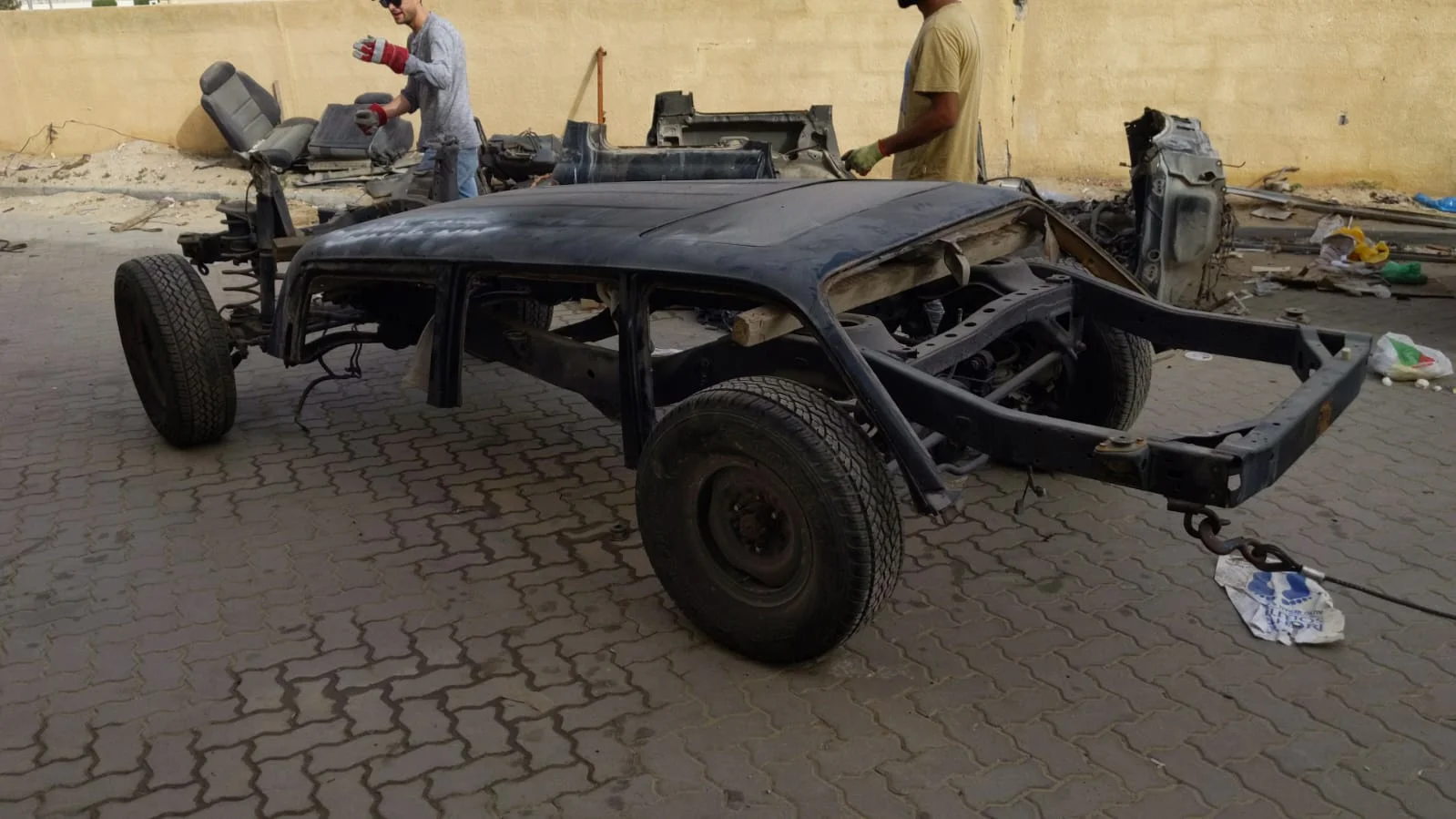

so here's where the chopped 80 comes in... Why not use the old turbo diesel frame to transport the donor roof?
I believe this meets the technical definition of 'chopped and channeled' if not the spirit of the concept. Notwithstanding even that the roof has been reversed front to back.
"To chop a roof, the pillars and windows are cut down, lowering the overall roofline. "
"To channel a car, its body is temporarily lifted off of its ladder or perimeter frame. After cutting the floor loose and refastening it higher inside the body, the body can then be lowered back over the frame. Thus the modification causes the entire body to rest closer to the ground without alterations to the suspension."
-Wikipedia
Well there you have it. An 'extreme' chopped and channeled Model 80.

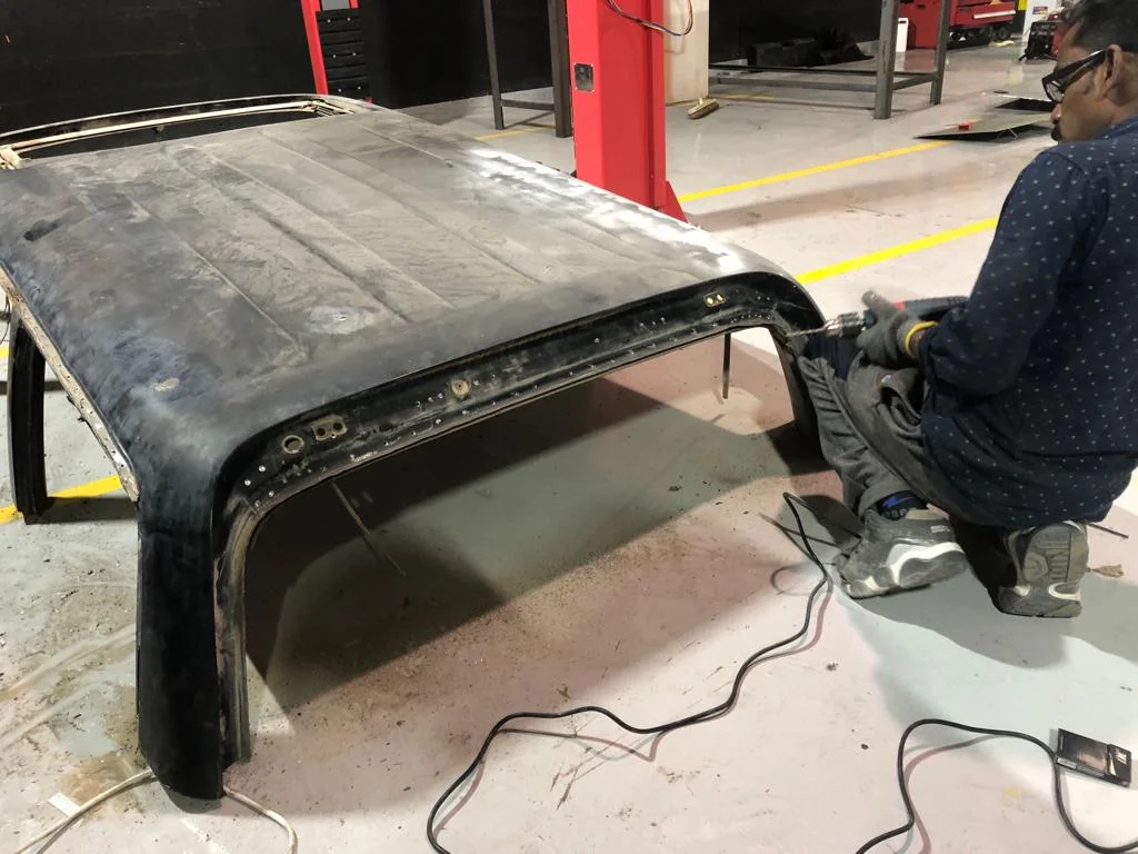

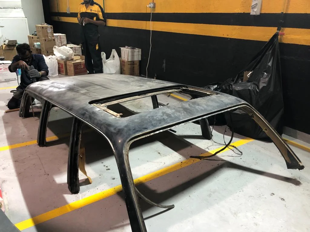

So the body man is getting busy on the donor roof. I -think- he is drilling the rivets out in preparation for pulling the center section. Time will tell.

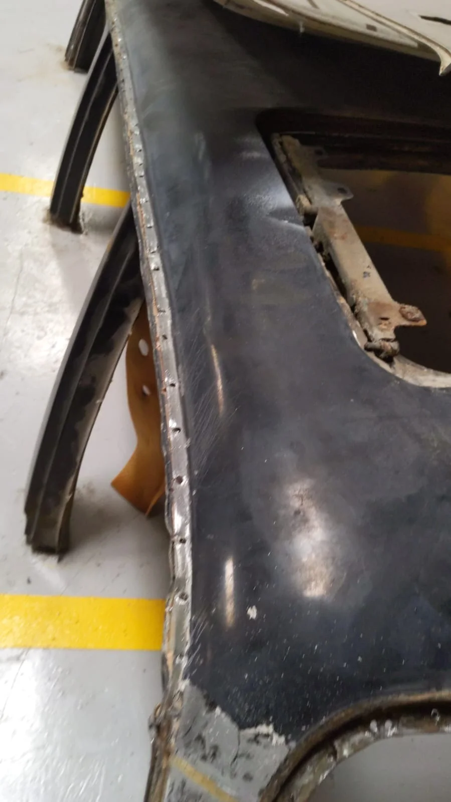

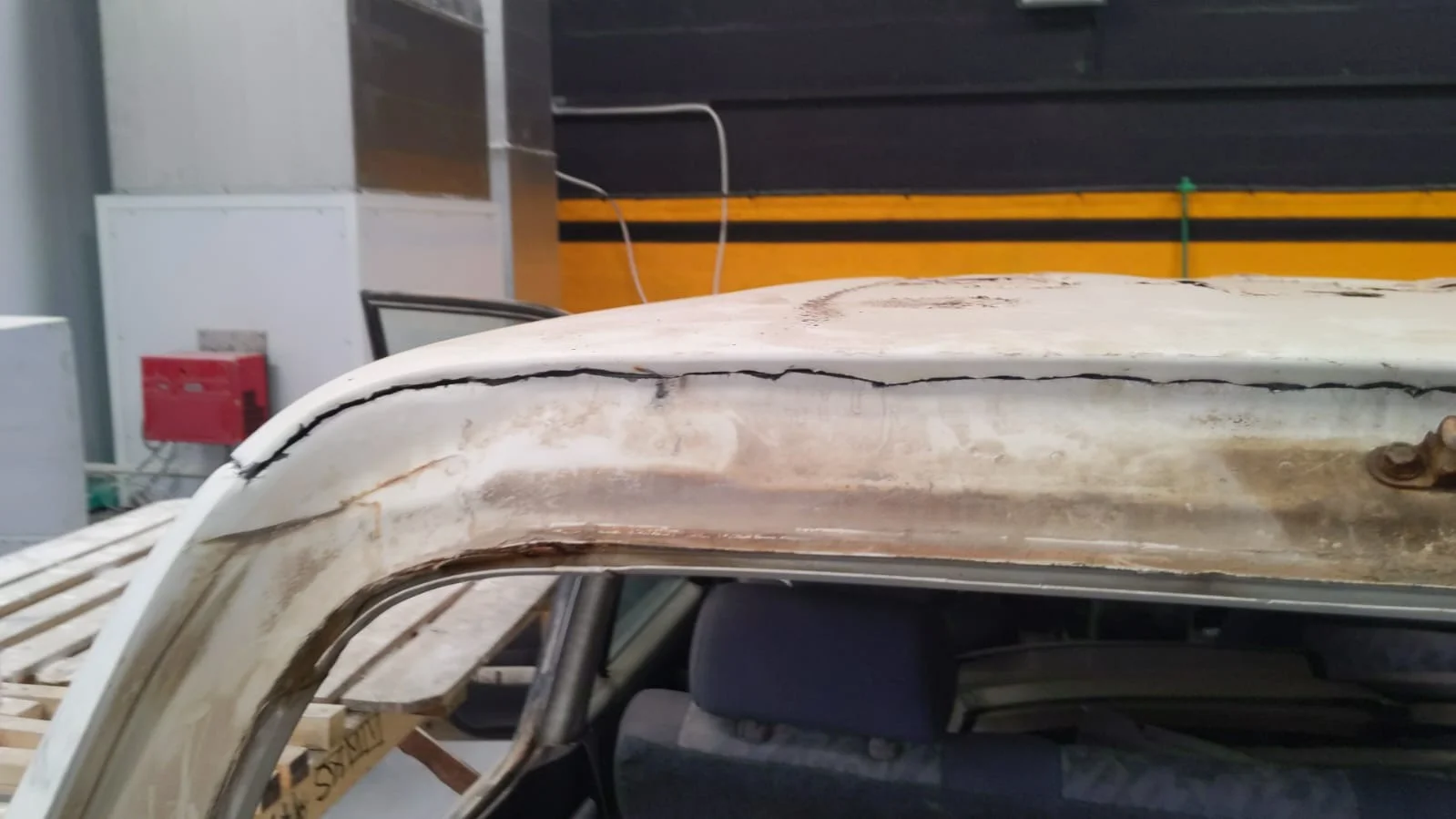

Any idea what happened to that roof? I've never seen anything quite like that.
None. Although one Mud member felt it was sun damage. I don't seem much more than surface rust anywhere else. A friend thinks it may have been parked under something dripping...but so many holes?

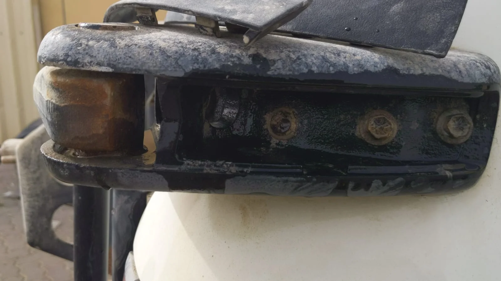

There certainly is a lot of finish damage. There is where the tire carrier bolts in

Anyone ever seen a security bolt like this?

Coastal, loading a boat or surf board that is fresh out of the ocean will do that to a roof.
The security bolts are probably for a rear seat so they cannot be removed. Appears to be a UK/EU things.
You can cut a slice with a hack saw 90° to the current "slot" and then you can unscrew them with a screwdriver, assuming it's not too rusted.
Thee was a recent thread about these from someone over there.

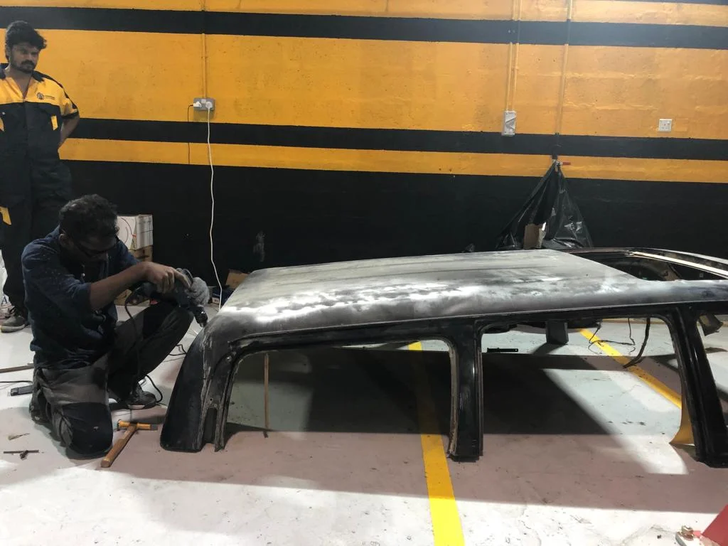

Well, the guys somehow managed to cut the security bolt and free up the carrier. I took it over to the powder coater for blasting and coating, along with a bunch of other small stuff. And I saw what was going on with the Holy Truck.
and the donor roof
Yep. The structure over the windshield was badly in need of attention. I'm glad it is being removed and replaced entirely.

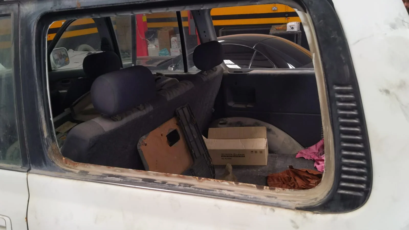

Regarding the rear windows I have a cunning plan...
The other side was better, but even this was not too bad.

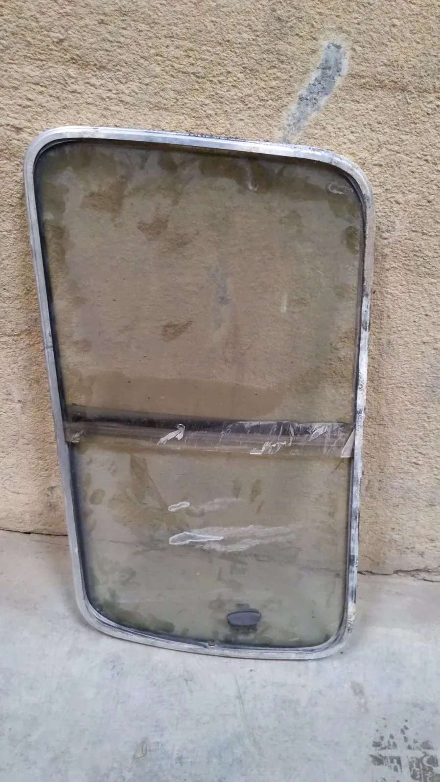

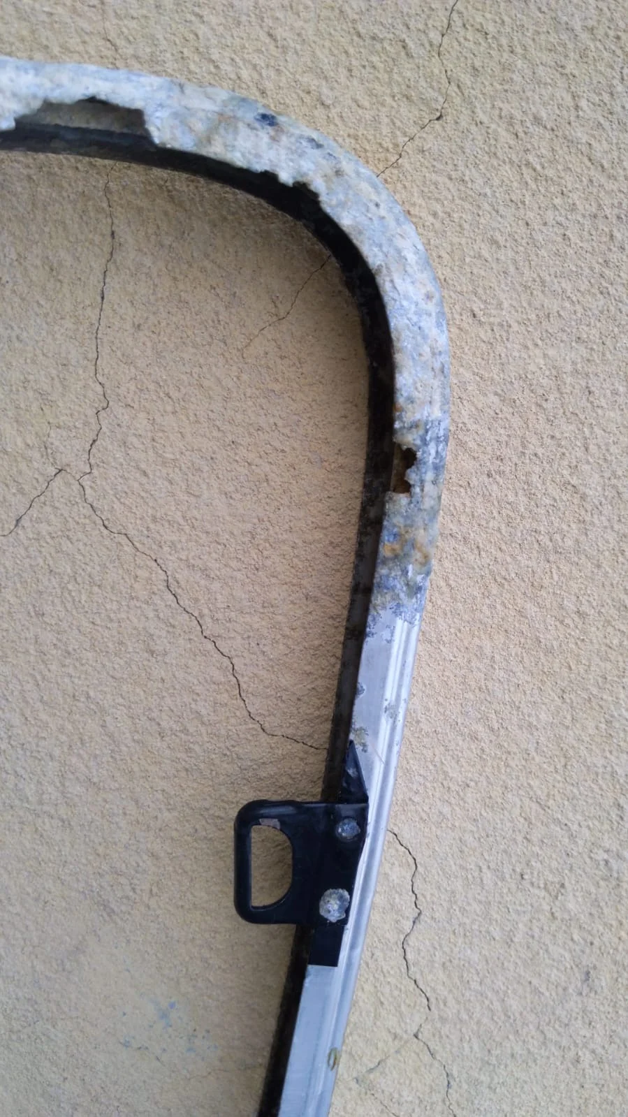

Most of the 80s I see out here have badly corroded rear window bits. It turns out that the rear windows are made up of a rubber outer gasket, a thin aluminum frame for the glass, and an inner rubber track for the glass to move on, plus a sealing bar in the middle. All can be disassembled.
This is a window from the donor truck with the outer rubber gasket removed:
Here it is taken apart
And here's the frame
As an experiment I have given it to the powder coaters and asked them to sandblast and coat in black. It will be a challenge to the sandblaster. But in any event I am sure I can find better frames in Sharjah for not too much. The point is that I think I can manage to refurb the rear windows to useable status. One of my 80s has fixed glass, which I prefer because of the leakage of sliding windows, and I may see if I can locate enough sets. I've actually got to re-do two 80s rear windows because of the frame corrosion problem.
