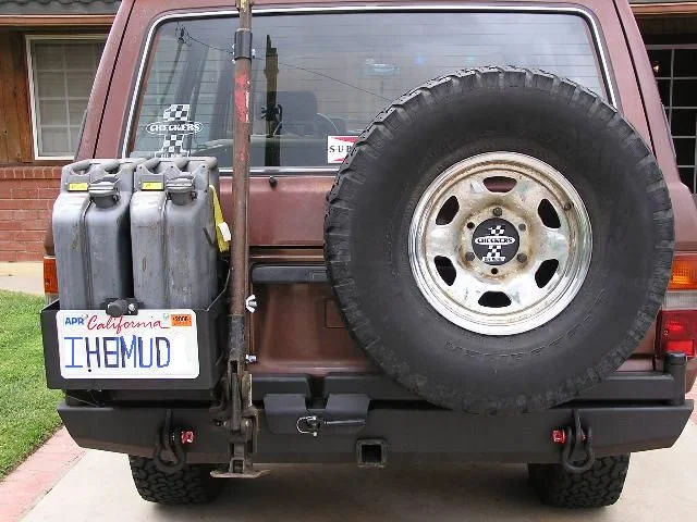

Here is a pic of my truck with a 4+ bumper. I ordered it unpainted to save a few bucks and just primed and painted it flack black. I really like the design and it is way beefy. I had them switch the tire mount to the right side (personal preference). It usually comes with tire on left, cans on right. (2 NATO cans, 48" high lift (a 60" will fit), and a BFG A/T 33x12.50x15 on a stock rim.)
You do have to remove the rear cross member (what a bitch) and all the rivets for the rear body mount (another bitch) Then all the rivets are replace with Grade 8 hardware.

:cool: Looks nice! Do the swing outs have locking pins on them? Also, did the bumper come w/ the light and rear plate bracket?
TIA-
The bumper does not have any pins to lock it in the open position just the lock down to hold it shut. The plat bolts to the can carrier and the light does not come with it. Mine is a NAPA special I think it was 7 or 8 bucks.
