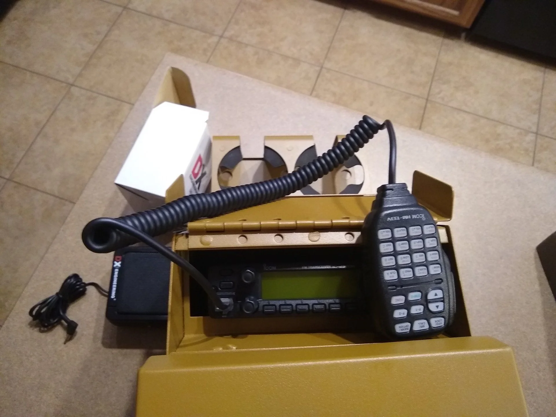

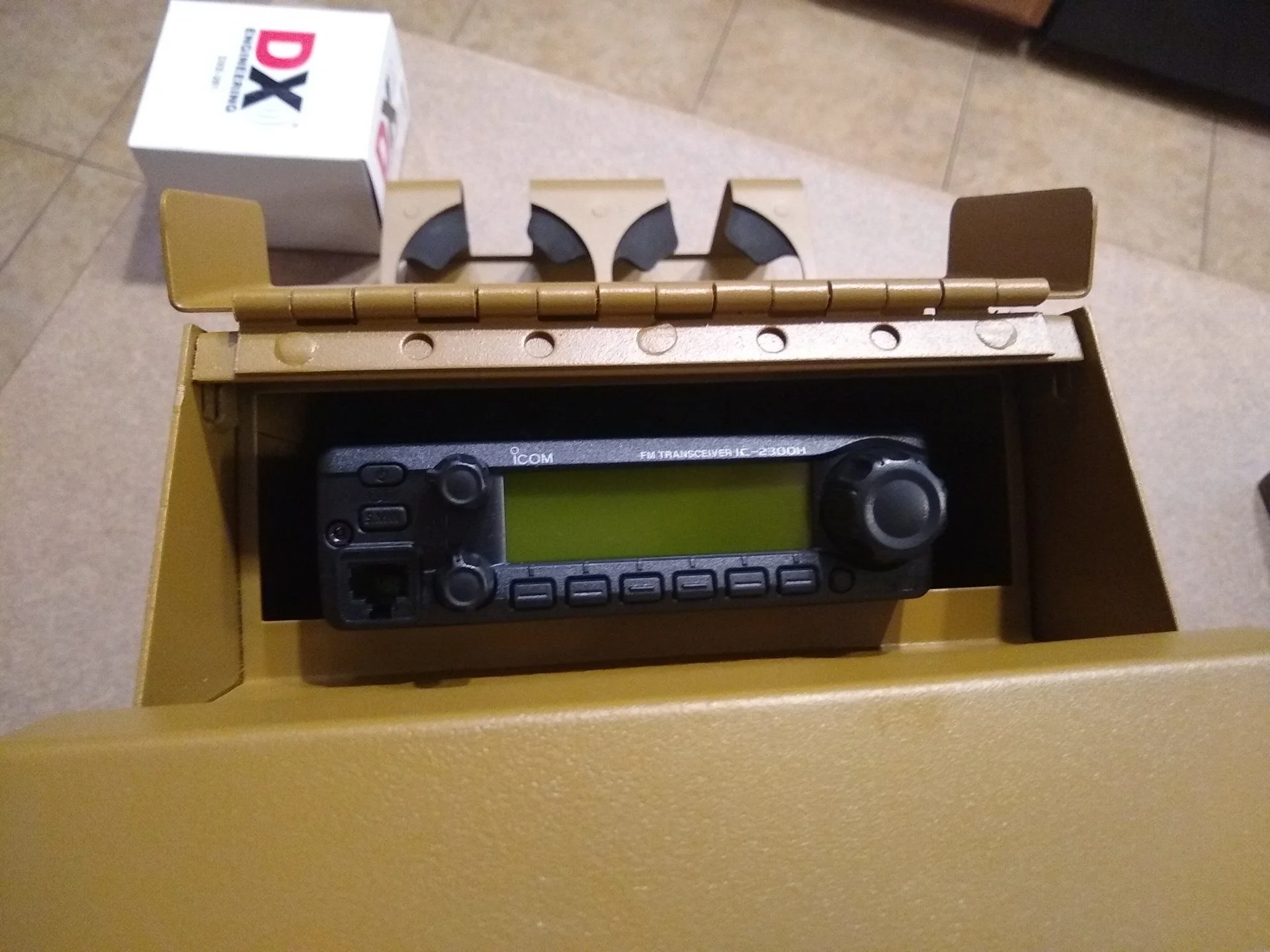

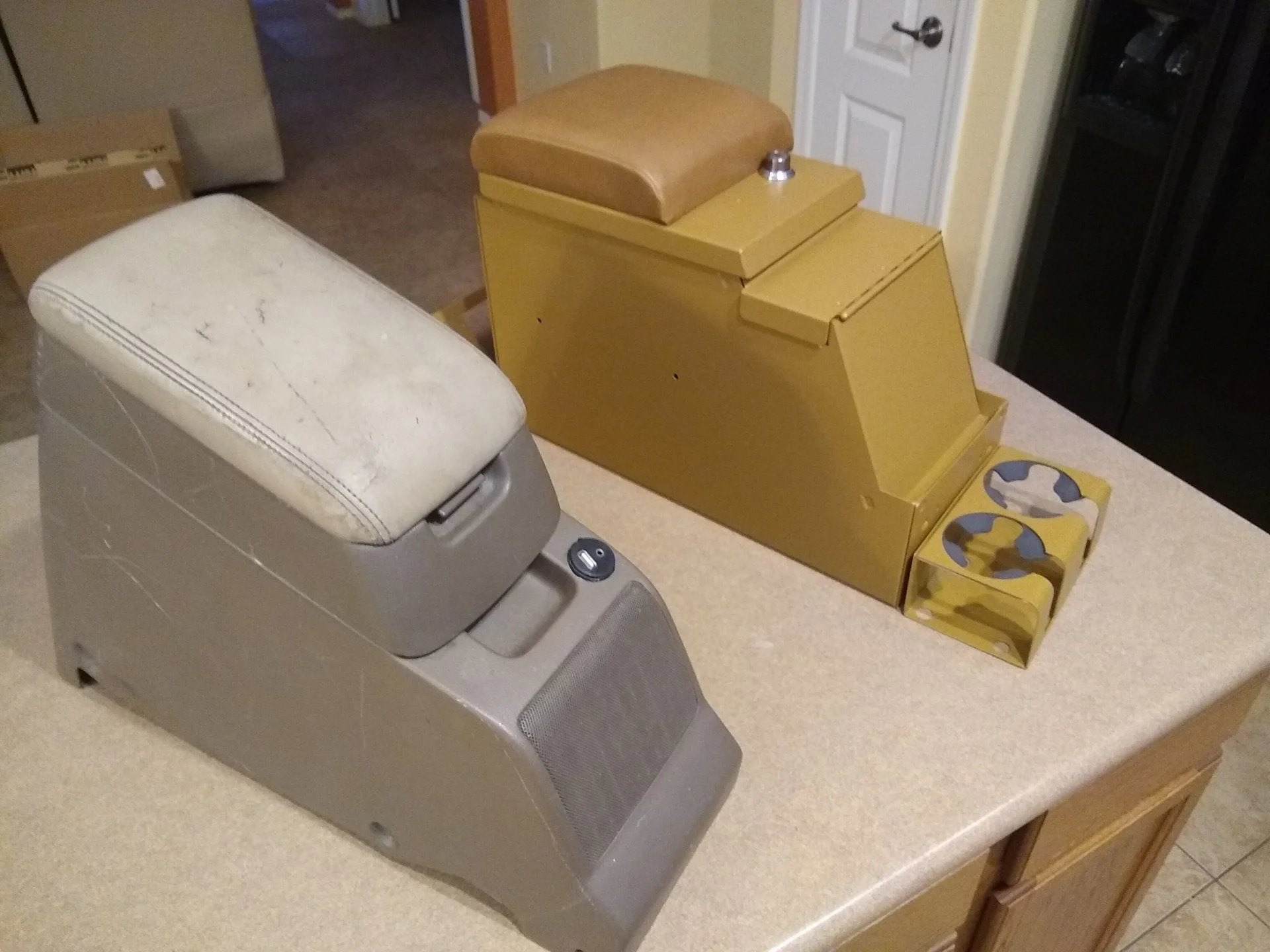

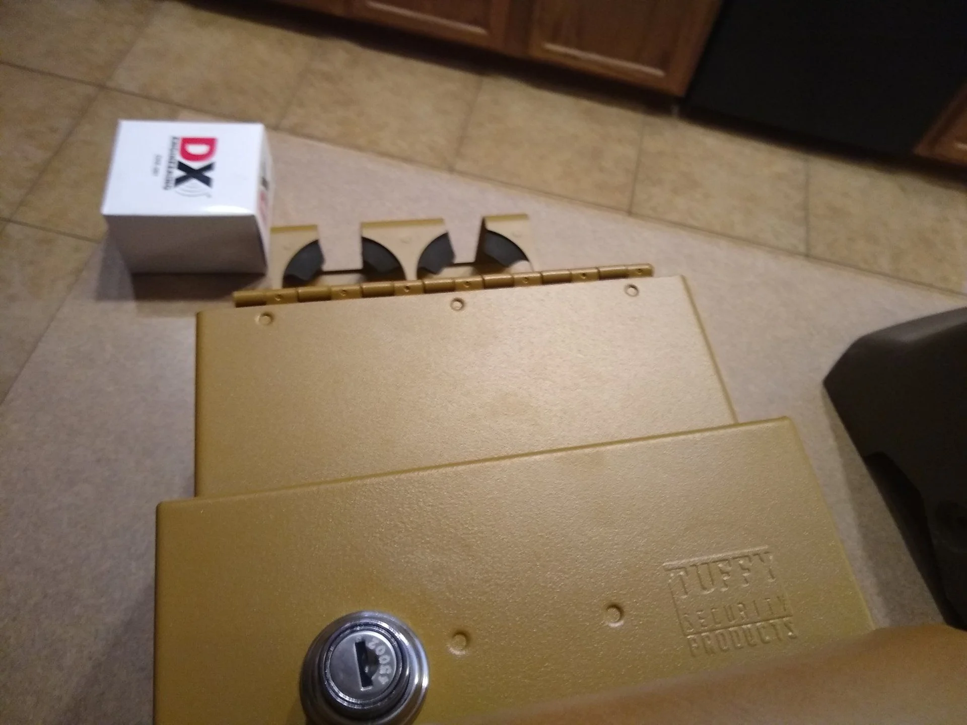

I got another goodie for the build on Friday. I wanted something actually usable as a center console and since I have it all apart swapping the tcase, I pulled the trigger on an 8.5 inch Tiffy radio console. This is one bomber unit. The shipping weight was 29lbs and I see why. I also have an Icom ham to throw in there courtesy of @D_Web. Many thanks my friend. I will have the tcase wrapped up tomorrow and will be hammering on the wiring cleanup and console install. I am sure I will be working down to wire right up until the Casner run. This is such a bigger project thanni ever thought or planned it to be, but I am gettting short on mods to perform. Still left are the on board air system, BIO step sliders, water tank, and a bunch on misc items like SS brakes lines, and better rotors....maybe a brake booster if needed. I am so deep in it at this point, what's a little more?.?.?

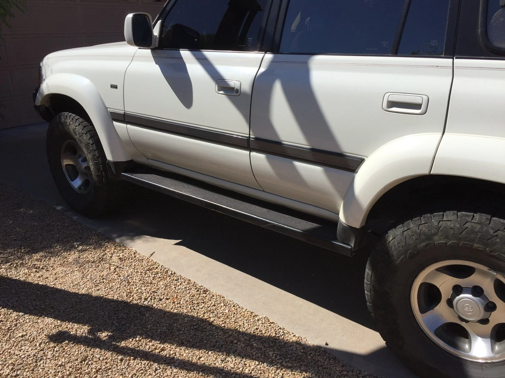

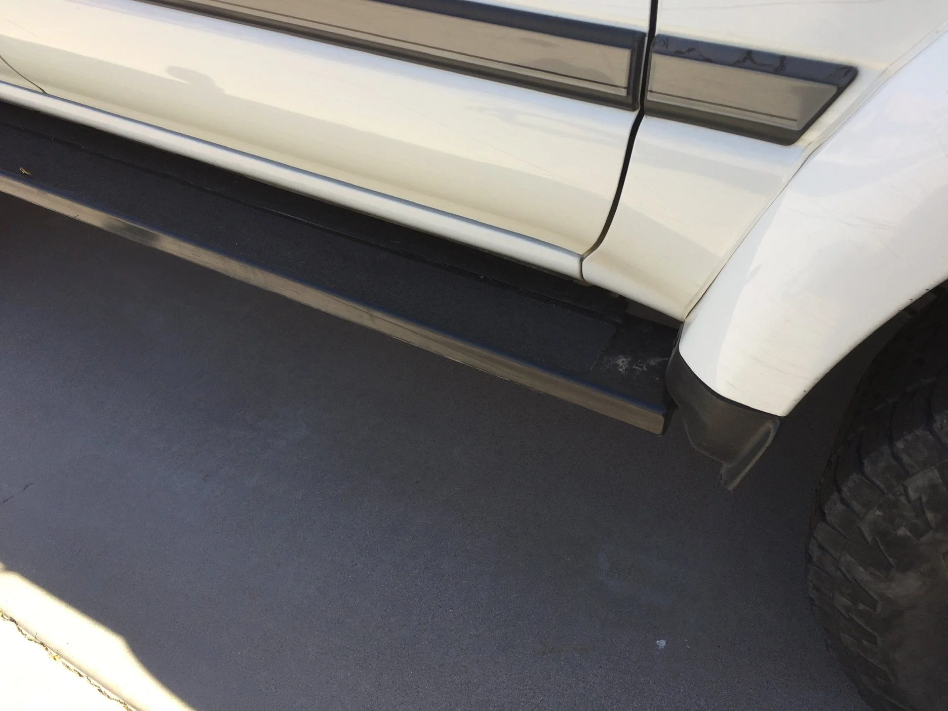

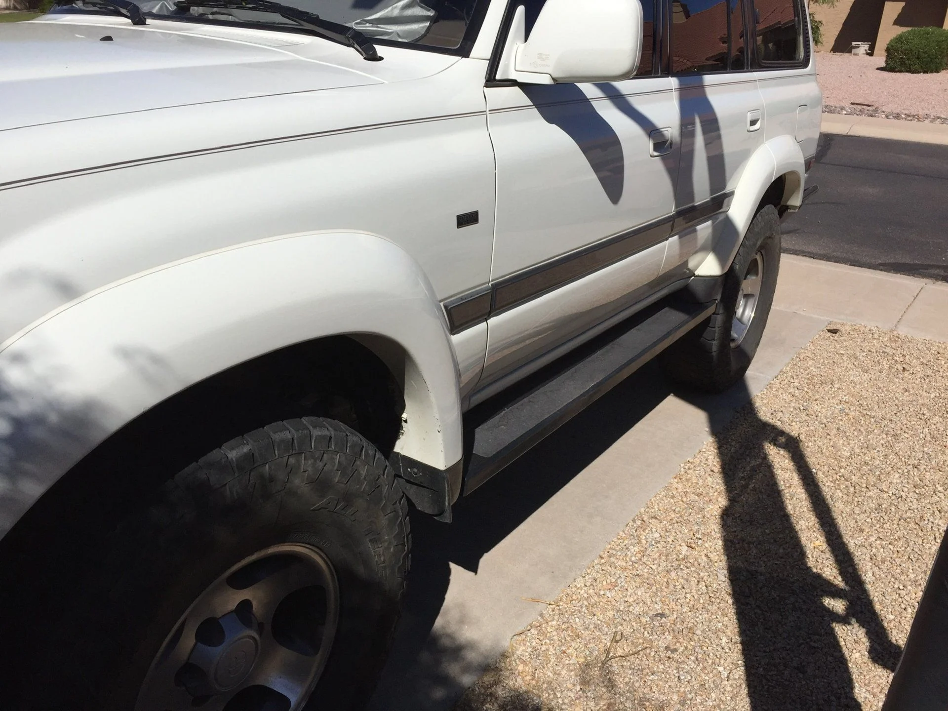

@Saddletramp are you still happy with your BIO Step Sliders? I have been talking to Mike there, and they are 8-10 weeks deep on orders. I really like them, but I am not a fan of waiting so long for them. I hope to be putting real miles on the rig soon.
Mind posting a pic or three?
First, I think that @Cruddz has the press and the bushing die but not sure that works for you. @ARJMN I believe someone in Tucson has the dies as well but not entirely positive.

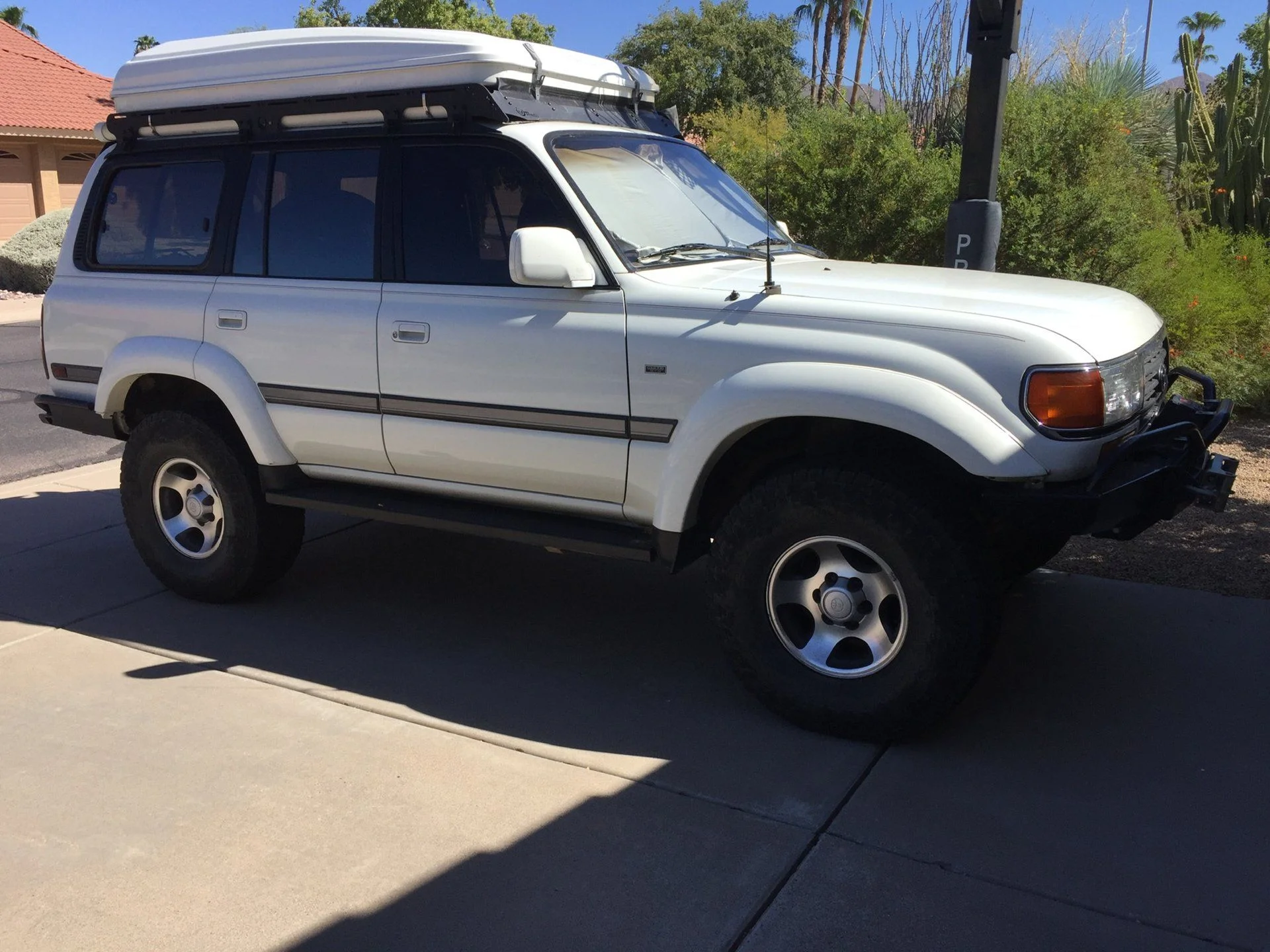

Regarding the BIO step sliders, love em...could not be happier and I love using the step whenever I set up my tent. This also keeps a bit of the original look that I like.
I will post a picture or two.
Very cool. That reinforces my decision to order them. I am on Mike's build list, and hopefully it wont be a full 10 weeks to get them.

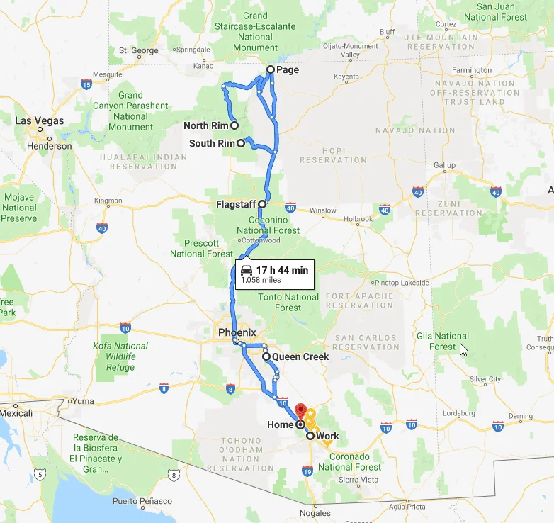

I took the old girl out for her first real trip last weekend, and it was a great success. No majors, only a moderate list of minors to resolve. We did over 1000 miles and hardly a hiccup. The 6.0 LS is such an awesome motor and it really wakes the rig up. Doubling the HP and getting better fuel economy is a win-win. Across the board I got 3 mpg better than the 1FZ it replaced. I am not sure how bad off my 1FZ was, but when the current owner of it did a tear down, the #5&6 pistons were pretty bad off. The best I ever managed out of it was 13.5 mpg and I got 16.5 mpg on the leg from Flagstaff to the South Rim and around. That was mainly cruising at 55 mph or so, and it was very happy to lope along in 6th gear at low rpm. Once out on the highway at higher speeds, the mileage dropped off a good bit, and it averaged about 13 climbing the hills from Phoenix to Flagstaff, and from Page to the North Rim. The plus is that it can do it at 75 mph now, so if I had the patience to be calm and keep the speeds low, it'd get better mileage. One serious complaint I have, which is the same on most the GM trucks I have ever driven is that the cruiser control is too aggressive. If speeds drop 5 mph the dang thing will shift from 6th to 4th, or even third and rocket off to get back to speed. I looked over and the tach read 5200 rpm once. Not a pleasant sight. Another note, is that I installed a Mark's Part Time kit. I have no way to tell if it made a difference in mileage, but by god it makes it so much better to drive. The trade off is that I had to get out and lock the hubs when I couldn't pull out of some muddy ruts in 2WD, but that is a small price for how much better it drives. Overall it was an absolutely fantastic weekend and the sights, the drives, the food, and the company was much appreciated. Thanks Rod, Marlotta, and @D_Web.
The only hiccup with the rig was coming back down into Flagstaff. After coasting down for a few miles and just getting to the city limits, the check engine light came on and I lost throttle control. The engine went to idle and I coasted off the road and came to a stop. I checked the codes and I had a "Bank 1 Too Lean" and a "Throttle Voltage Correlation Error". We had seen the 2nd one before, and a quick check of all the throttle connections revealed that the connection to the throttle pedal had backed off. I checked it, pushed it on until it clicked, cleared the codes, key cycled it, and it came to life and hasn't faltered since.

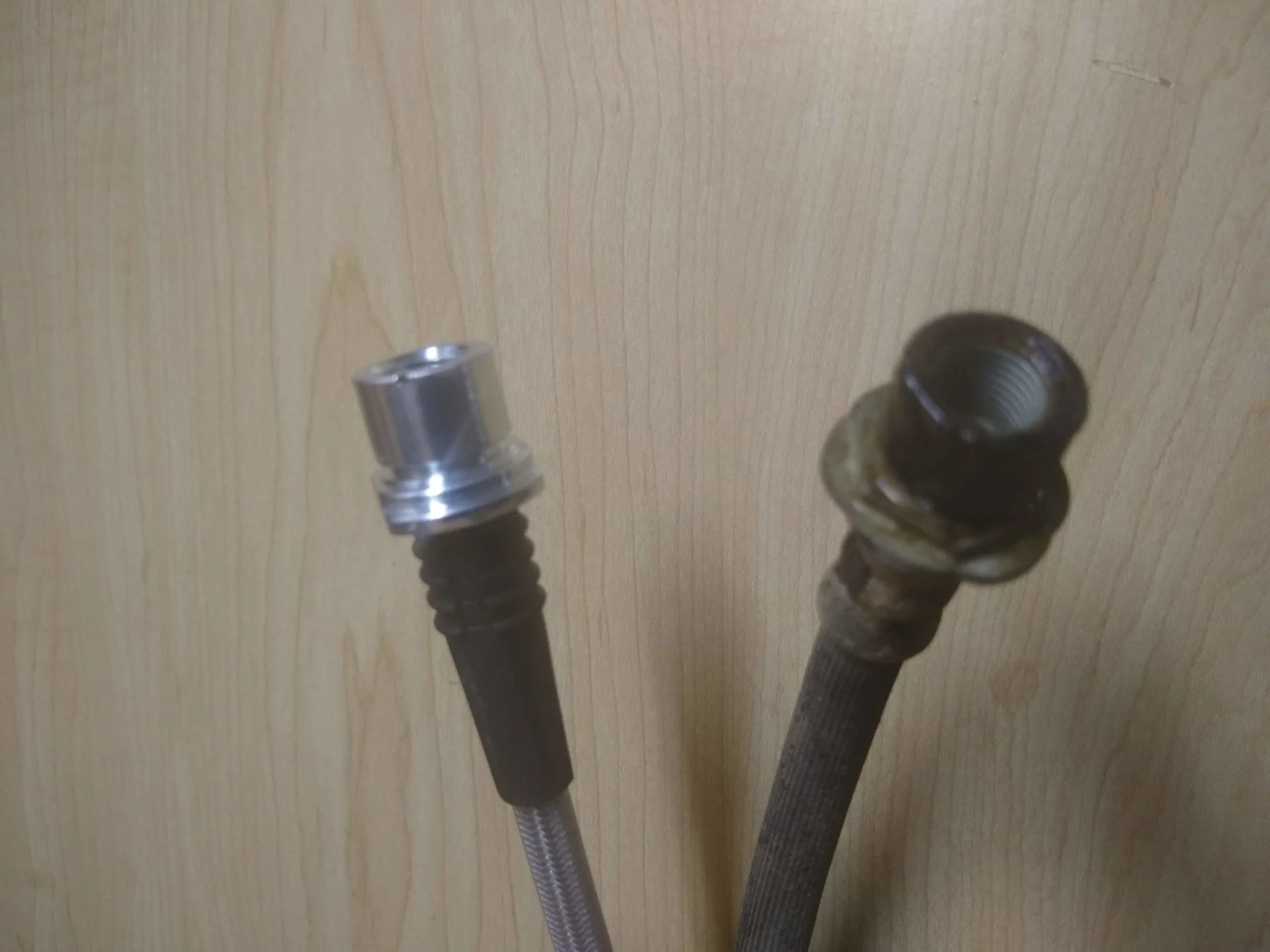

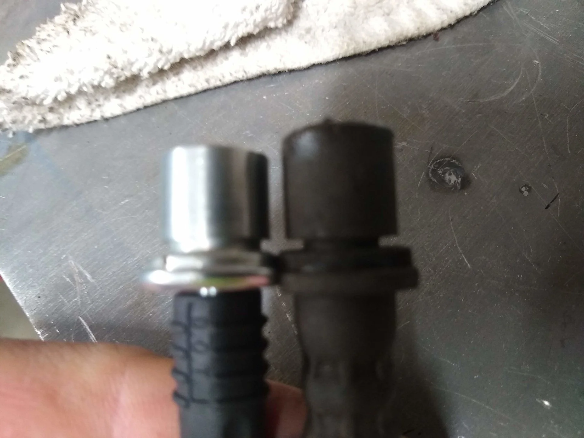

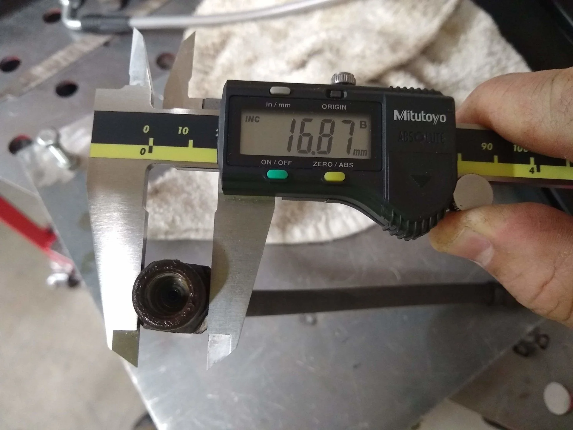

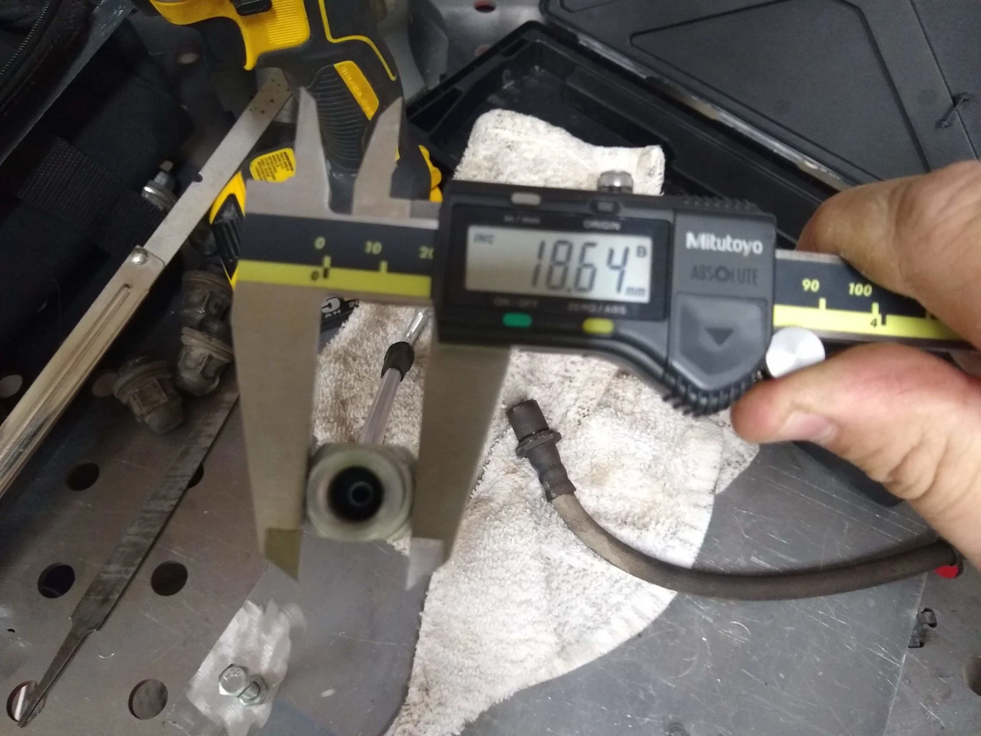

The swap began by getting the whole thing on jack stands and the wheels off. After taking a close look at the original flex lines, I was amazed at how bad they were. They all had cracked outer layers and some had the braiding showing. The lines I got from Wits End are great quality and they are longer to accommodate up to a 4 inch lift. They were not a direct fit, as shown below. The factory lines on my 97 LX450 had a hex formed into the female ends that mated up with the mounting brackets., while the new ones have a round profile with flats on two sides. I took a look at the differences and decided that a file could quickly resolve the interference. About 15 minutes on each and they fit up just fine. I was able to creep up on the 17mm dimension and ensure it was a snug fit. Not a direct fit item, but the quality of the lines overall makes them worth the effort. I forwarded the feedback on the the guys at Wits End, so maybe a change can be made. I did twist one of the factory hard lines trying to break the fitting loose, but $11 and a few days wait and I had a new one from Precision Toyota.
After getting them all installed, torqued, and clipped in position it was time for a bleed. I pumped almost 2 quarts of DOT4 through the lines before they ran clear and the pedal firmed up. I buttoned it all up, cleaned the rotors, reinstalled the wheels and off the jack stands she came. A quick test drive yielded the best braking performance I have had in out of the 80. Huge improvement. Still on the list is a set of upgraded pads and rotors.
