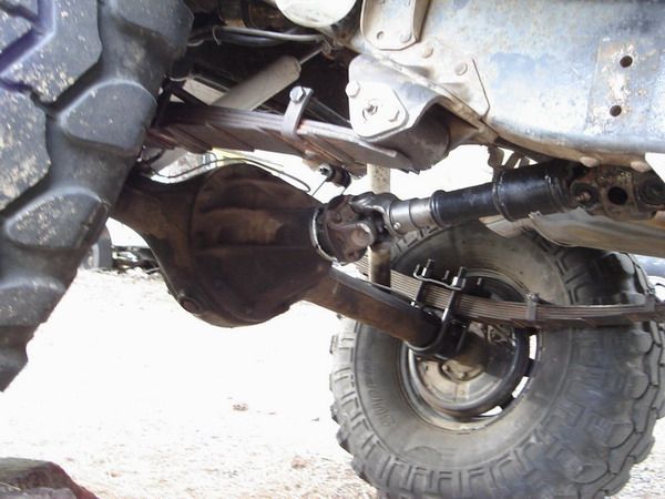

I did all mine on the garage floor. Used a big chisle (spelling?) to bend them away from the spring and a big punch and big hammer to straighten them all out. Then drilled near the end for 3/8 bolts through some small tube. Lots of work for the outcome but I can take the springs apart as many times as I like now without worrying about the wraps breaking from bending back and forth. I did weld some cross pieces on once, then couldnt take the springs apart without cutting them off- oops. Heres a poser pic...
awwww c'mon, cutting and welding is fun! :D i do admire those spring wrap bolts, nice work.
