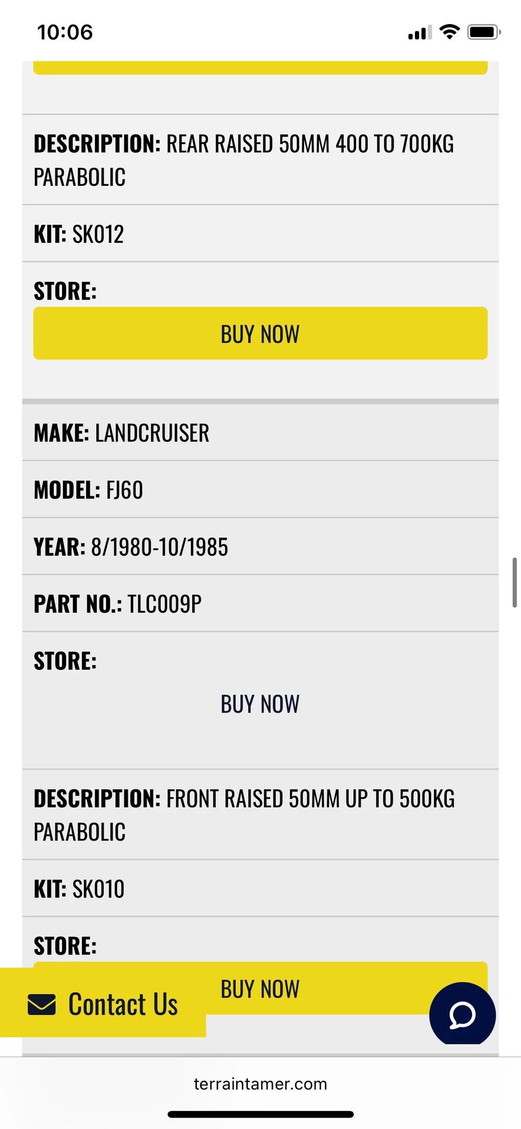

I think they can handle it but I would check the specs.
From what I am gathering, if you get past a certain weight the Terrain Tamers go from Parabolic to normal style leafs.
When I build trucks I build them for what is normal use versus the hardest use.
Hardest use I'll add Boss Airbags to supliment.
No reason to bash yourself up 90% of the time just for fully loaded trips

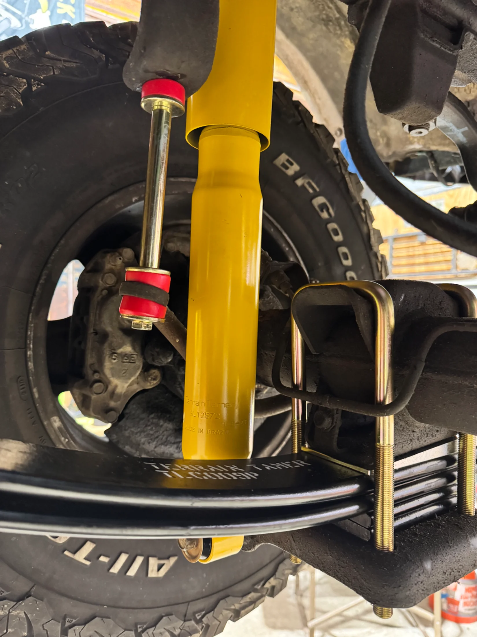

I added a set to a FZJ70 a week or so ago. Discovered some "tech"

Looks like there are several versions with increasing Weight capability. I’m sure Georg will set me straight.

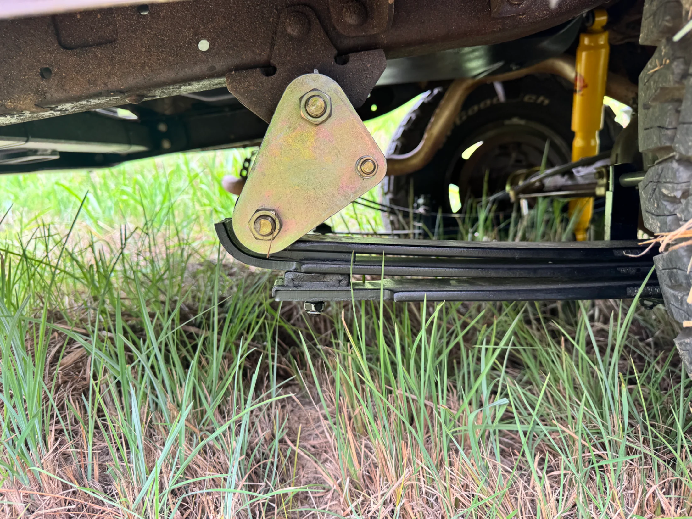

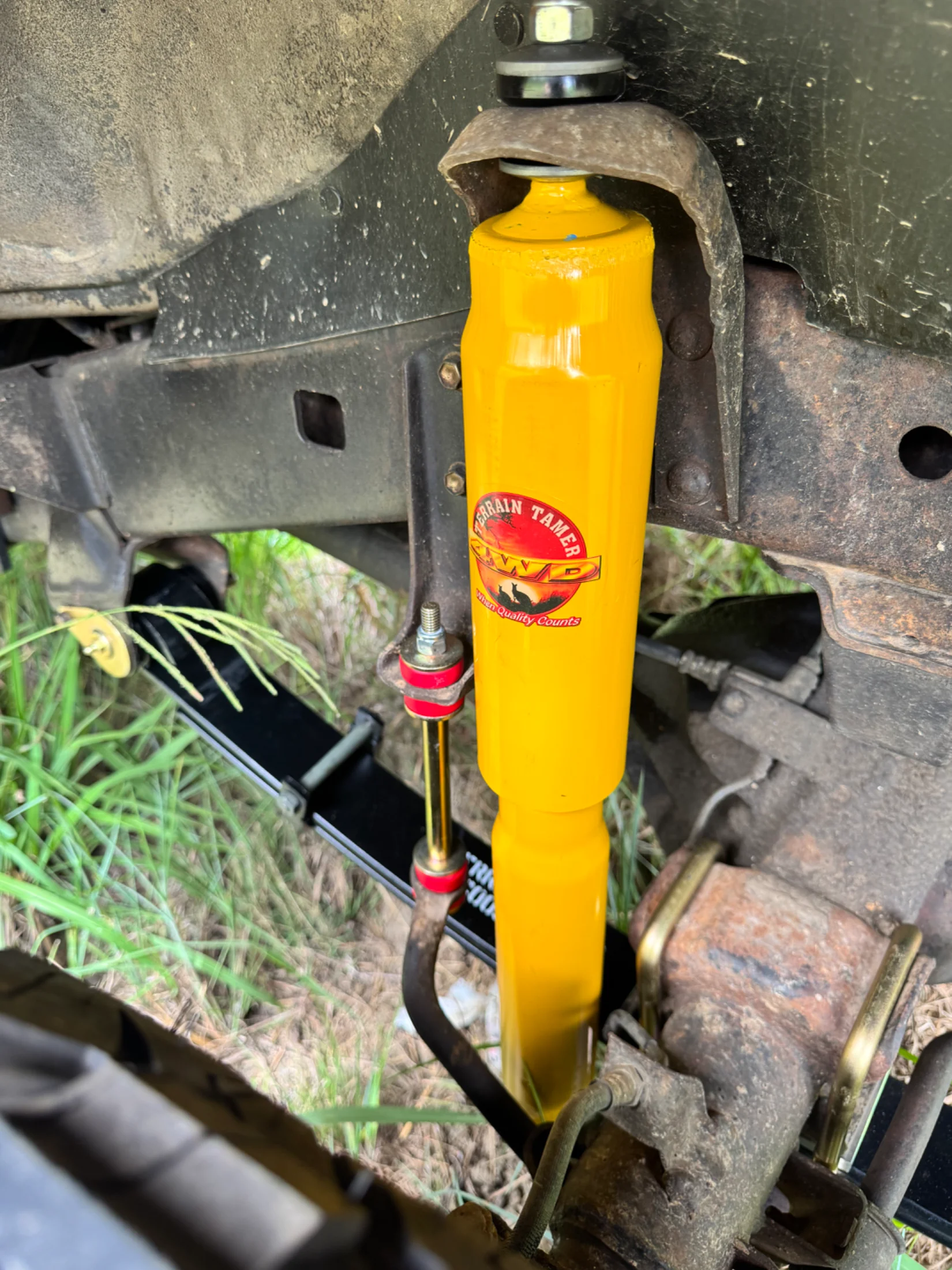

Got a set put on a 60 today. I removed a clapped out OME kit with 3" longer shackles
Total game changer. Ride and handling are greatly improved.
Did those front sway bar links come with the kit as well? Or did you have to ask? Checking my quote from them and I don’t see those on it
Likely ordering a full kit this week since my OME’s are totally flat
No but every Auto Zone stocks them in this size. Don't remember the PN off the top
Of my head but they stock a shorter one too.

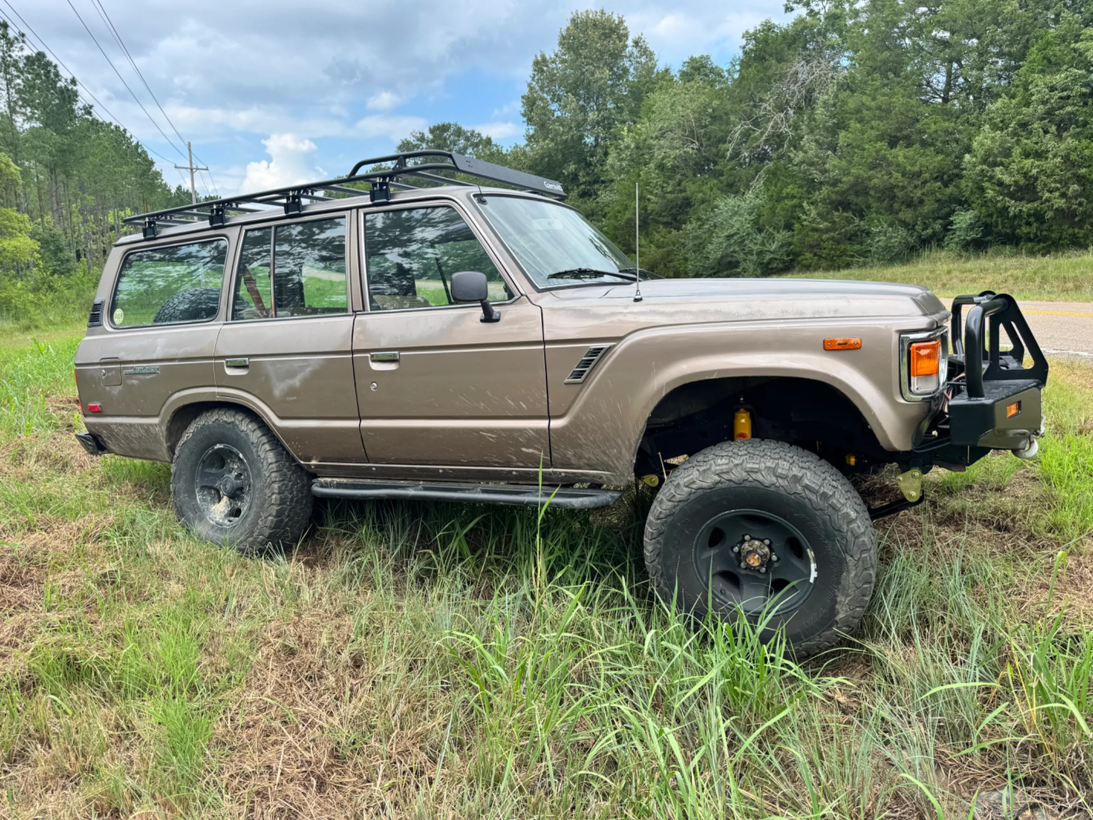

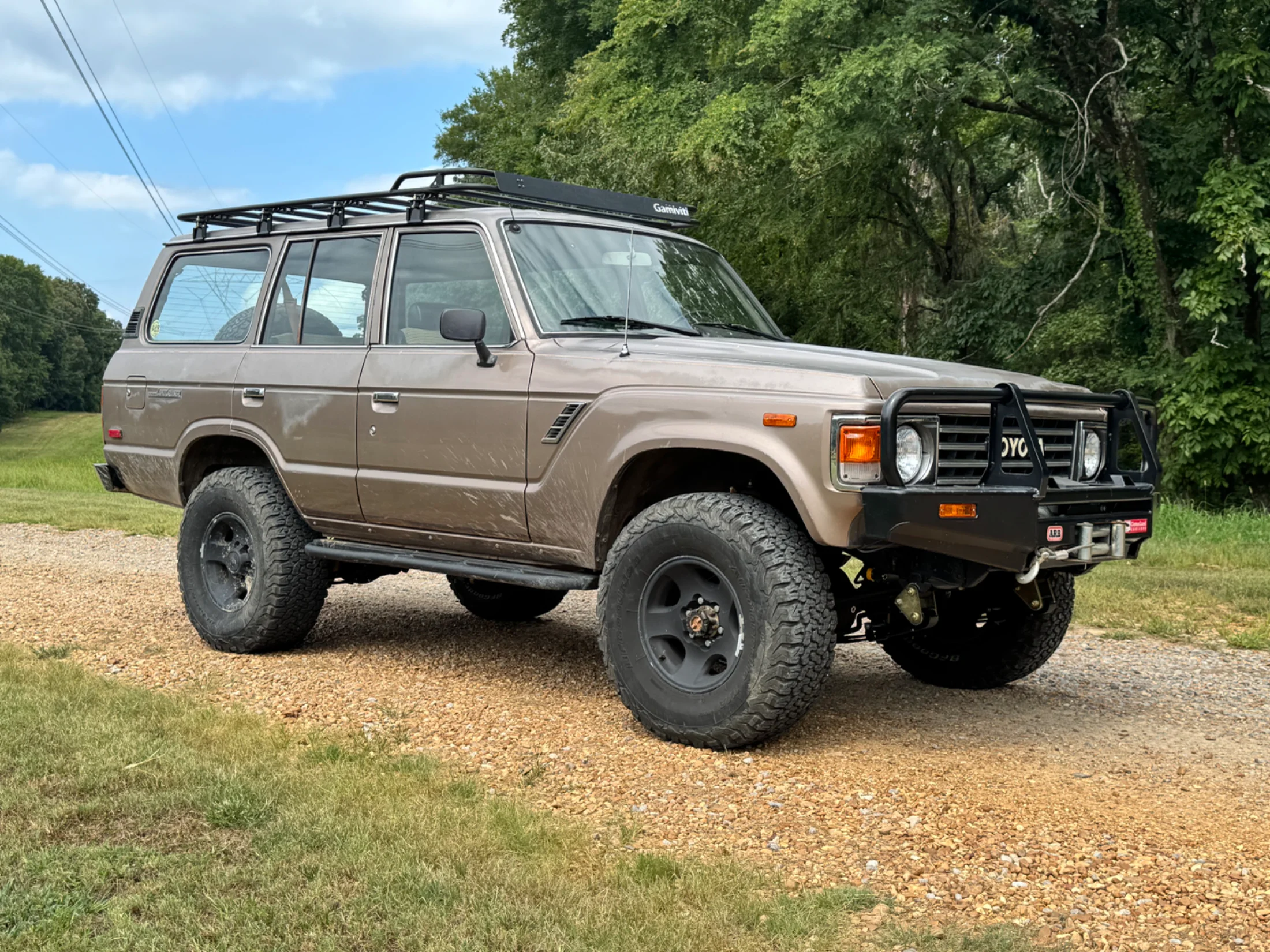

Took me about 3 hours to button up the front and take it for a spin. View attachment 3876633View attachment 3876634
As you can see the truck sits pretty level. It's about the same as my pre lift numbers.
Impressions.
This setup is noticeably better than the OME setup. I honestly did not really expect that much difference seeing these light rear 45s all pretty much ride harsh.
I was hoping to get it to the Dobinsons IMS level of comfort at least so I'm happy to say these springs actually feel a good bit smoother than even those.
Potholes are not jarring. Seams in the road are not felt in your spine at all. Corners are great.
Overall I'll say I'm 100% happy I upgraded.
I don't think I would change out a Dobinsons IMS setup for this setup but I would advise new buyers to strongly consider the Parabolics over traditional leafs for an FJ45.
I look forward to trying them out on different models to see how they do on them. I'll be sure to follow up with any other platforms I get to test.
