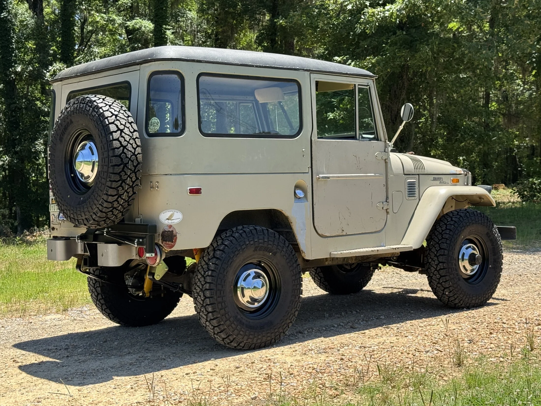

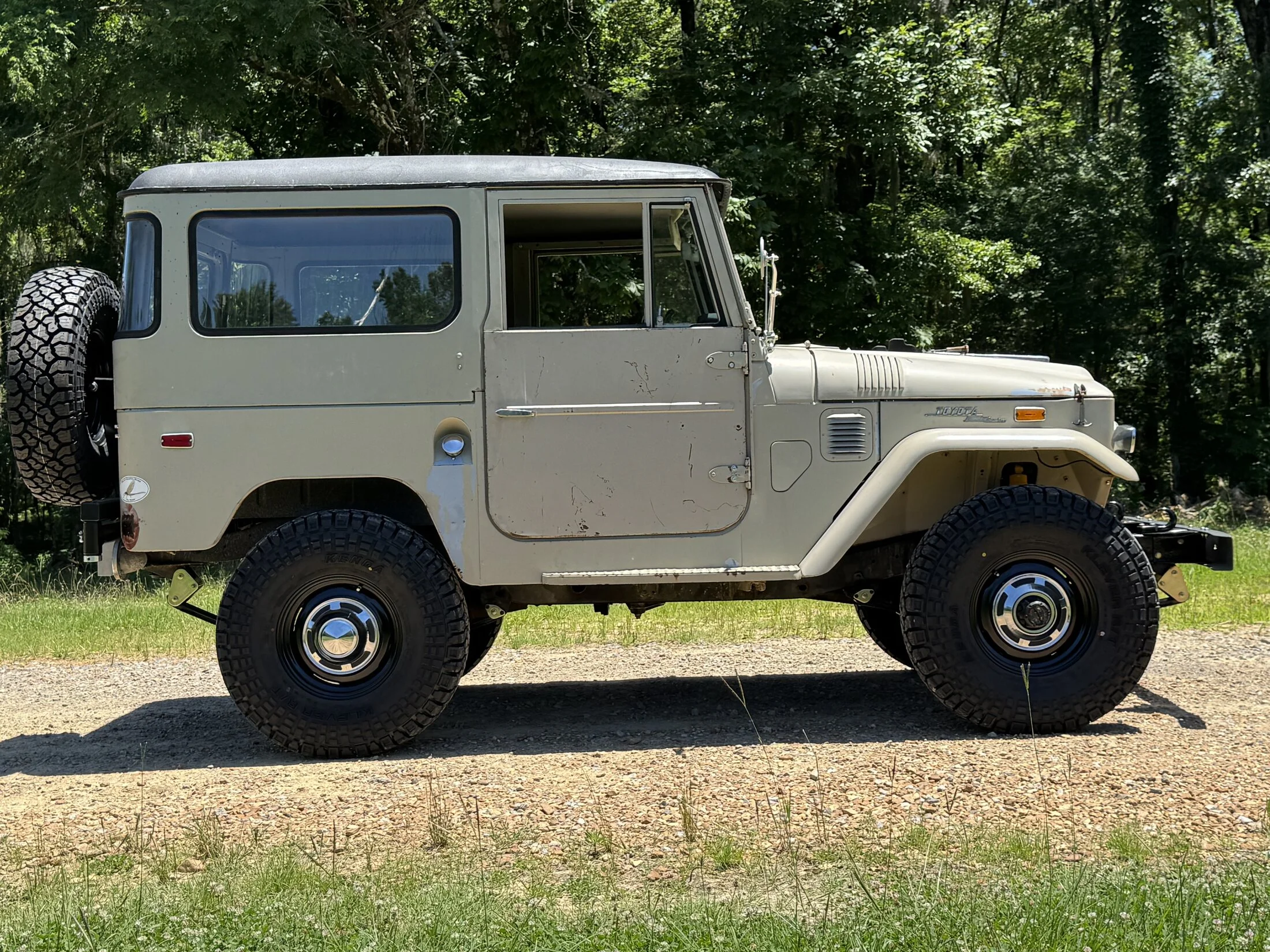

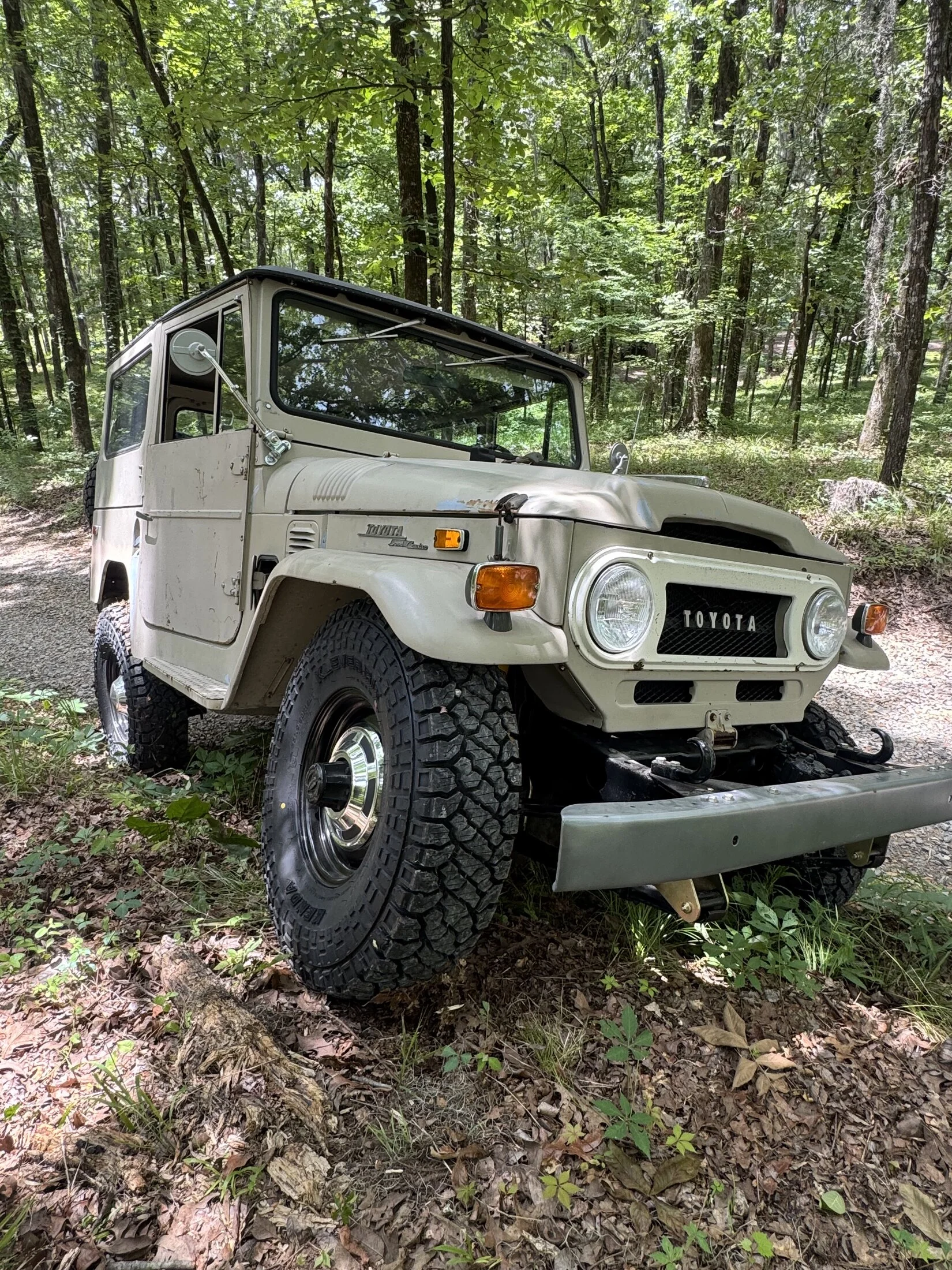

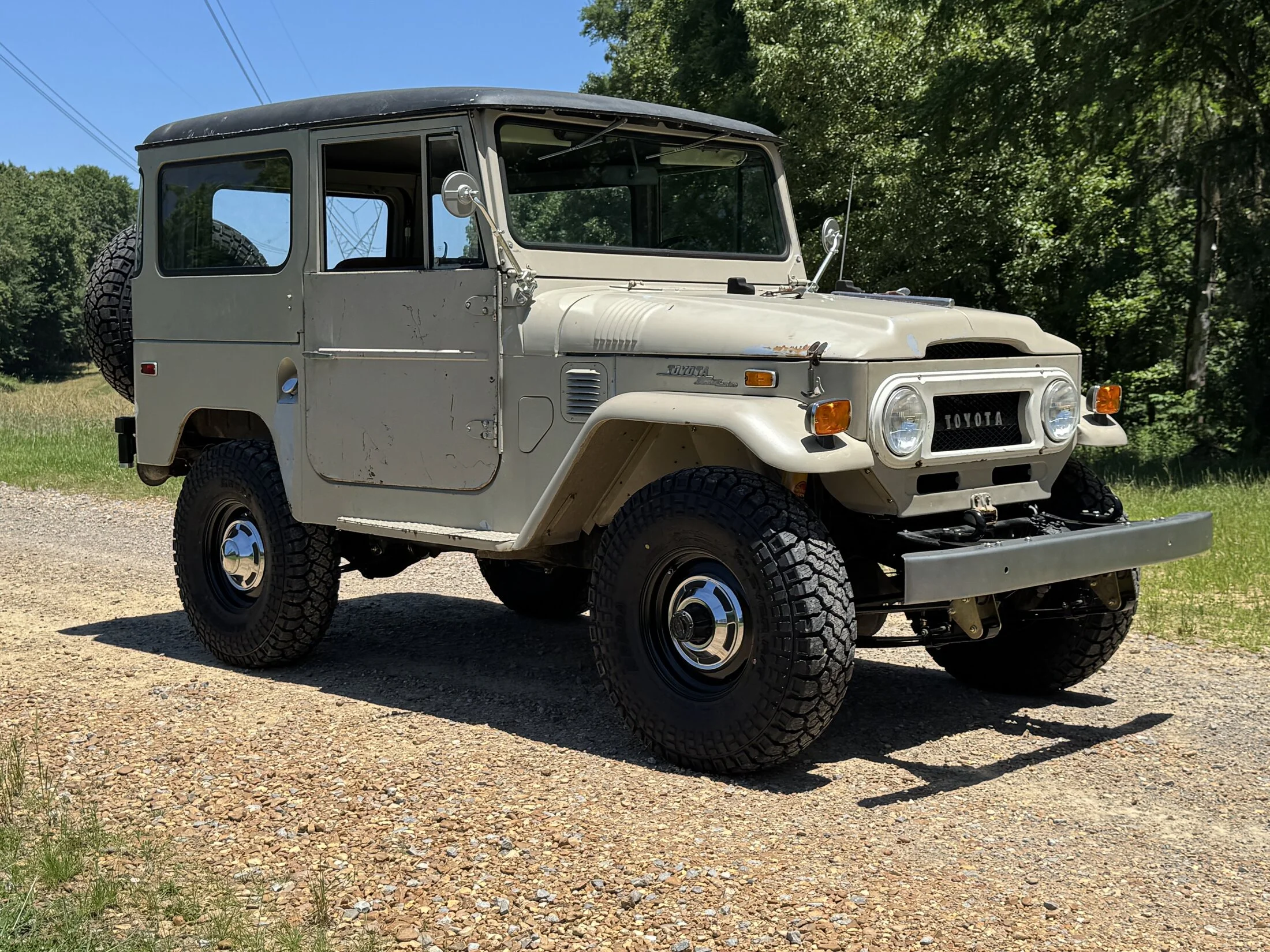

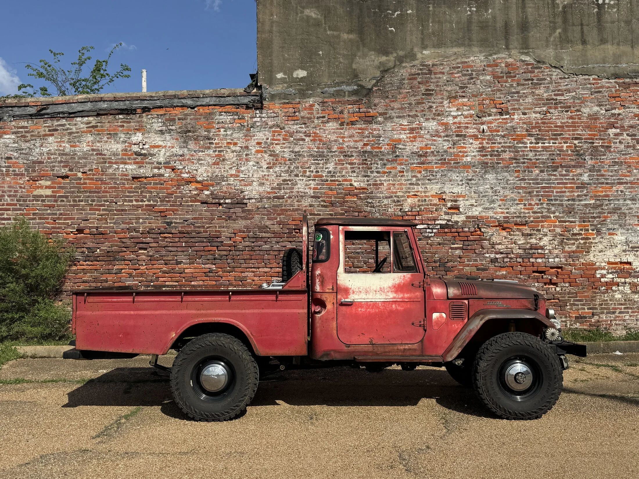

Second set I've installed. This time on a FJ40.
Easy install.
As you can see, it has a perfect stance. No lean.
Rides fantastic. I could immediately tell the difference in how smooth it rides

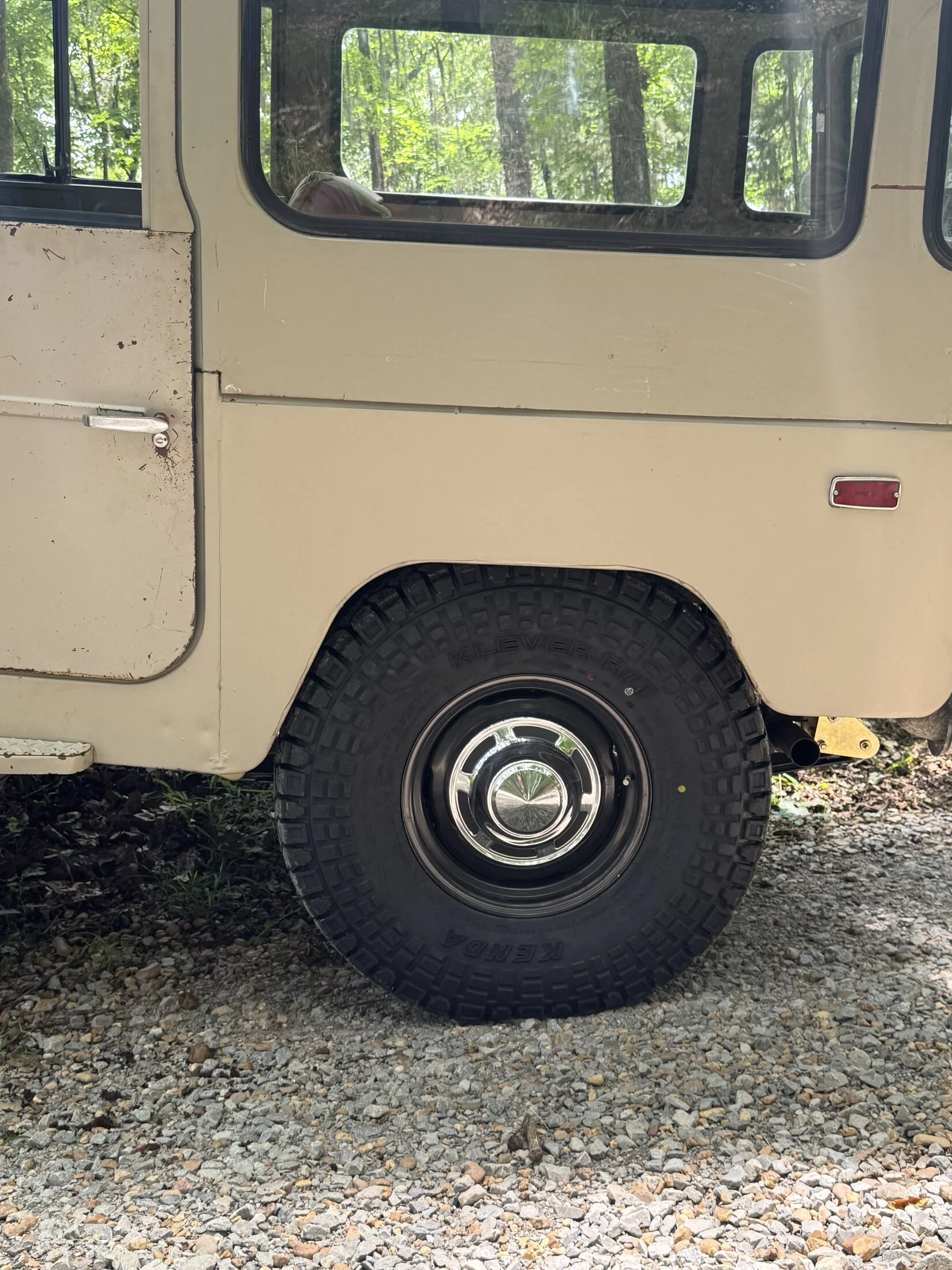

Does it seem like the rear tires sit more forward than with the stock springs? I had to push my rear axle forward about an inch.
People do that thing where they center the axle by redrilling the pack and perch because they like the way it looks.
Suspension manufacturers put them to the front of the wheel well because when you flex out the spring and put it at full stuff it will be in the center where it belongs.
Shackle angle looks decent too, that's nice to see.

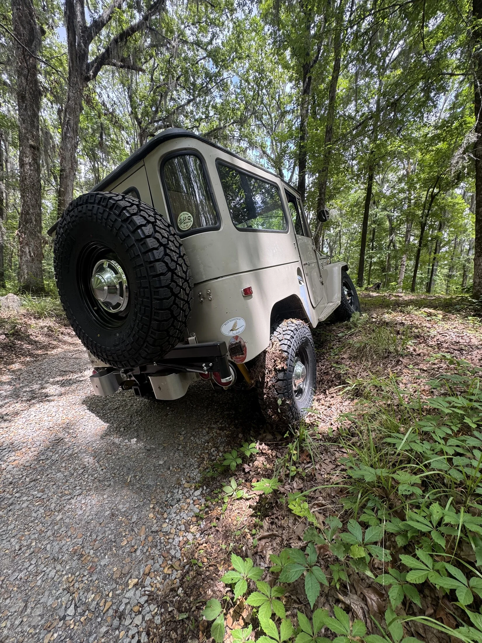

They are correct for this type spring. I'll flex or out tomorow and show where the shackle and axle land for you
As promised. Full stuff. Perfect placement
