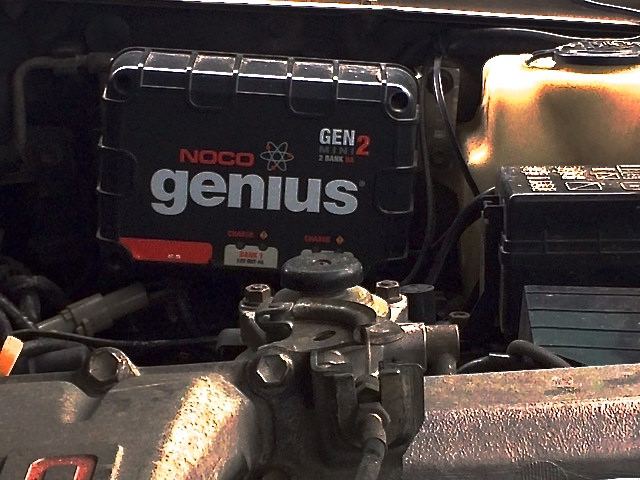

My truck came with a Noco 2 bank charger already installed... if it hadn't I would have put one in:
Waterproof and rated for outdoor use. Very handy.
As someone else said, connect the battery maintainer to the right hand battery. It is the one directly connected to the -ve chassis ground.
