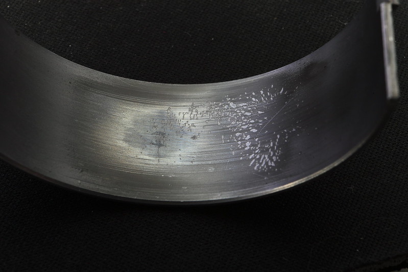

I usually avoid doing anything other than lurking on most forums, but Sheldon suggested that I post up a pic of what the ACL bearings I pulled out of my truck looked like after 150k since a lot of people feel that once you've changed the oem ones out you're safe.
According to the previous owners it was synthetic oil every 5k
Without having the shells in hand, the spot in the center looks like debris on the backside of the shell.
The other wear looks to be fatigue wear.
Red antifreeze mixed with oil will do similar damage.
Just about looks like shells from an engine I am fixing that had coolant mixed with the oil for an extended period.

That is a kewl find Doug. I have suspected cavitation for a long time on these motors. I spent a bit of time last night reading about crank whirl and certain frequencies some unfortunate engines can develop to varying degrees. Can whirl occur on rod bearings as well? Is it like something that affects the entire crank?
One of the many non drastic small scale solutions to address whirl relatd cavitation was to run tighter bearing tolerances, cooler oil, and different viscosity oil (lighter but still with as high or higher film strength),and depending if it is isolated to specific bearings on the crank...as in BEBs... You can tear drop some bearing journals to bias oil flow to the ends of the crank and feed the BEBs more oil. Some even go so far as to groove the bearing to increase the bearing load as most whirl and cavitation seems to happen at part and light loads, but I wouldn't be the first one to try that out on my truck I must admit.

I only thought of the 5-30 as it has some awesome properties in itself, but would also be less viscous to allow for tighter bearing tolerances. Tighter tolerances lessen the crank whirl effect. The fact that the 5-30 had superb film strength is also to fight the whirl in itself as it challenges the film strength tremendously. Specifically at the 5 o'clock position in that bearing pic. The 5-30 also has really low shear viscosity allowing it to run inherently lower bearing temps which in turn also helps maintain the film integrity. It is just overall a better oil. It creates less heat all the time, yet has superb film strength? What more do you want?
Whirl creates such high isolated bearing temps that it can cause cavitation of contaminants. Lower oil temps might lessen the cavitation in itself. I suspect fuel personally as the 1hdt likes to run dirty at idle. Just a thought.
If it does suffer whirl, oil changes mean nothing. The motor would break the film on the first drive. What Dougal said makes since about load in New Zealand vs Aus. In mountain country your rarely part load which is where the whirl develops. It is specific to bearing load, that's why some engineers choose to remove bearing material to run higher loads all the time. It's sort of counterintuitive, but neat.

I'm not sure what you mean by "debris on the backside of the shell" There was nothing trapped between the bearing and the rod.
There is no coolant in the oil either. The motor is in great shape, it's spotless inside, no sludge and 35psi oil pressure at hot idle.
I posted these pictures after seeing a few people on here putting forth the idea that the fault was with the oem bearings, and that replacing them was the cure for this problem.
