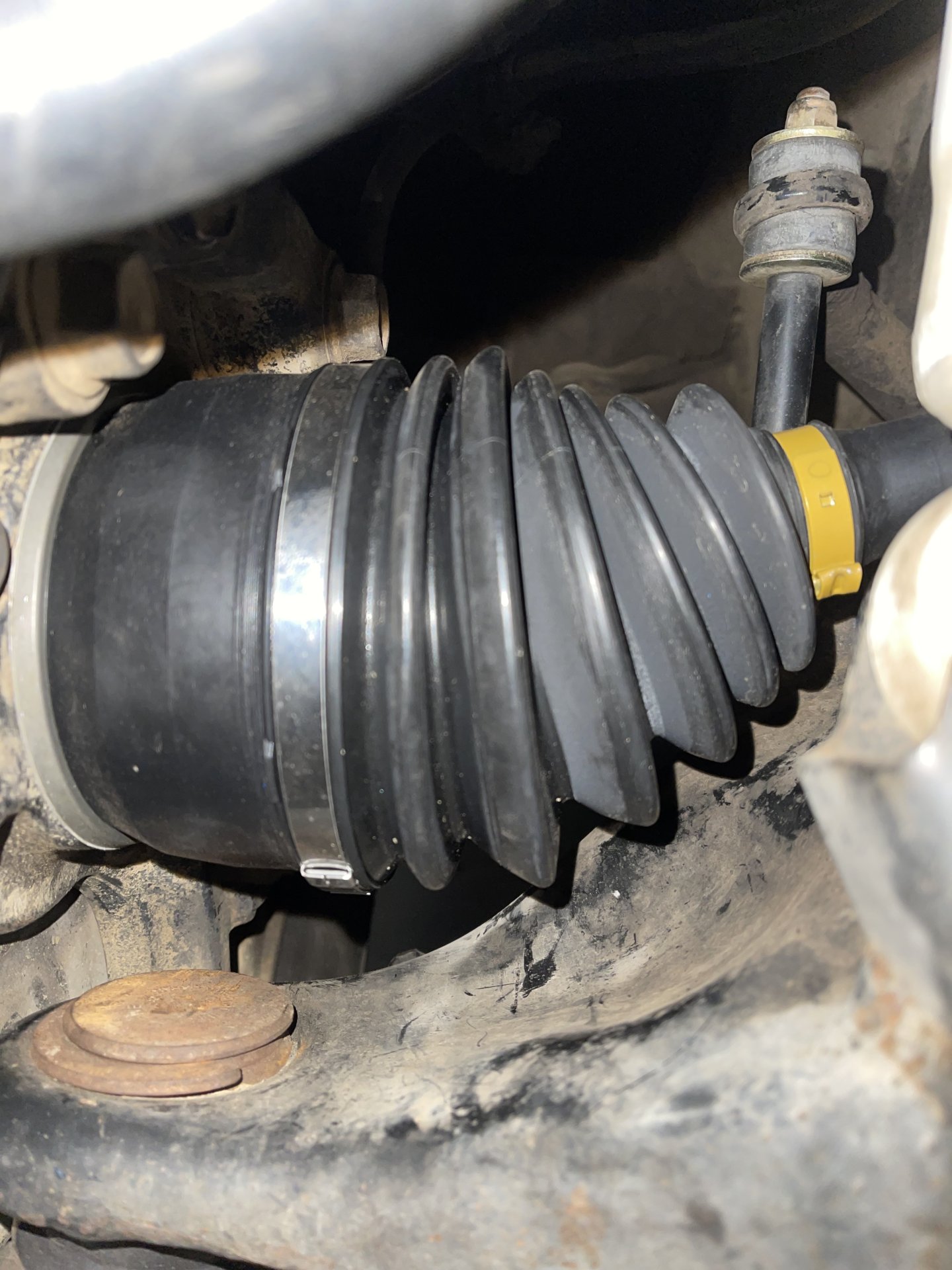

🤔 New OEM axles have yellow bands/clamps on the outer boot.
Like this? ;)
I can take off the snap ring and take a pic if you really want confirmation :)

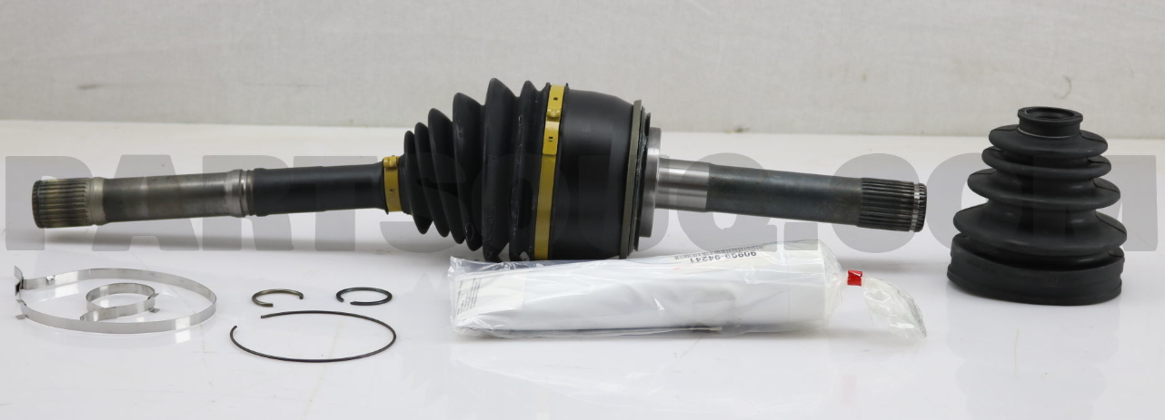

and if your outside spline are not in the best shape, you can buy the new outer joints from Toyota.
That’s perfect actually. Thank you. I’d found the outer shaft but saw the price was only like $60 cheaper than the whole axle. This is a much better price.
there is even a thread on rebuilding with a new outboard shaft!
Thank you, calling my stealer to order the parts today.
That’s a first. Never seen an OEM axle with only one yellow band on the outer boot.
Wonder what's causing the difference. Perhaps supply chain issues having to use alternate suppliers? Gotta admit this makes me a little nervous given the quality of the Toyota reman units that have been determined to be total crap.
View attachment 2851233View attachment 2851232
I think this is the route I'm going to go. I just disassembled one of the axles that had the inner boot torn open. I'm sure it took some more wear than usual, but hopefully, it still has plenty of life in it with 135K miles.
My 2 new OEM axle's from my local dealer (order fulfilled from the Torrance, CA Toyota warehouse on 12/7) both only have one yellow band on the outer boot.
One yellow band on the outer also. Purchased in 2020 from a dealer in WA.
