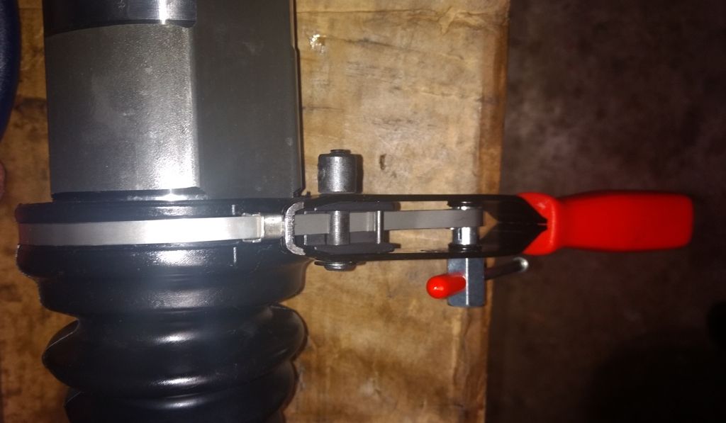

On a new axle I wouldn't change the clamps until you have to- you have at least 12mo warranty on the part, so wait it out. The inner boot small clamp is the one that generally weeps- this clamp is different than the outer boot- and there's really no way to tighten it, since it's a lever type locking clamp. These have been loosening up for some (including me) around the 12-15 month range- so keep an eye on it. My preferred replacement clamp is this Napa boot clamp-
Small CVB6865833
Large CVB6865833
And this tool to achieve the correct crimp: FSM calls for a gap of .8mm to set the correct tension of the clamp.
Amazon product ASIN B005J3L4BW
