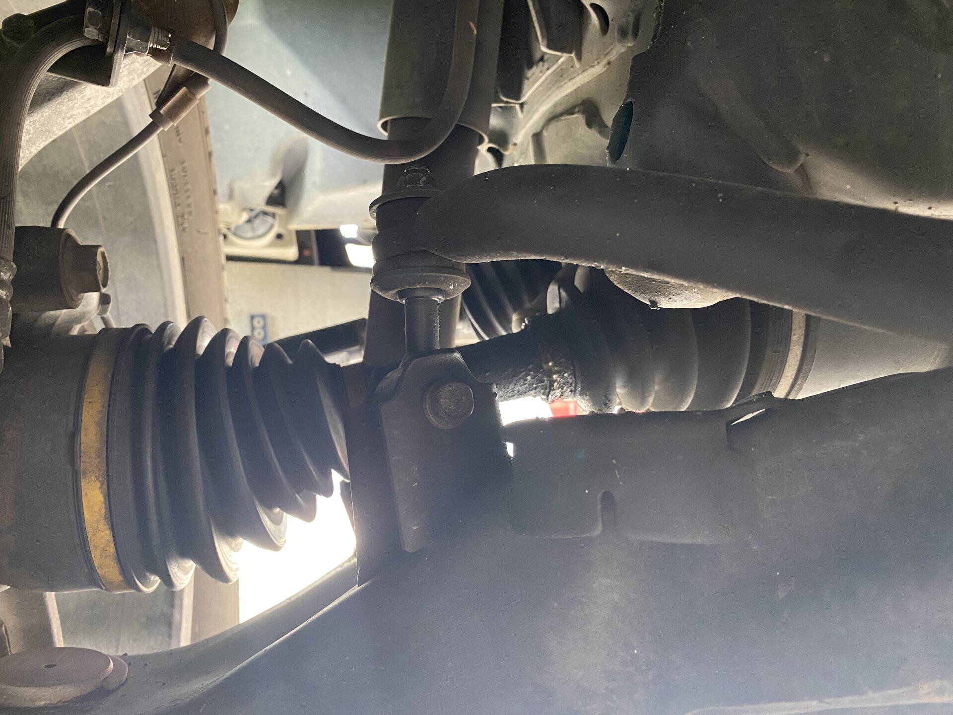

Well I'm no mechanic so I don't really know exactly how to assess. I went out to take some photos with various angles. AHC is in high position and front end of vehicle is on ramps.
From front of wheel
From behind wheel
From underneath wheel
Not sure this is supposed to look like this lol...
There’s a lot to look at which requires taking stuff apart. How do you know it’s the CV axle? Maybe it’s the bearing or loose lug nuts. I’m not too mechanically inclined and ended up in a similar situation as yourself which led to me taking out CVs and installing new upper and lower ball joints. These threads will take you down rabbit holes so you gotta put hands on your rig eventually. Good luck.
Tbh I don't know. I'm just making an assumption based on the service records I posted above... which led me to look at the driver's side axle... where I see grease on the inner boot.

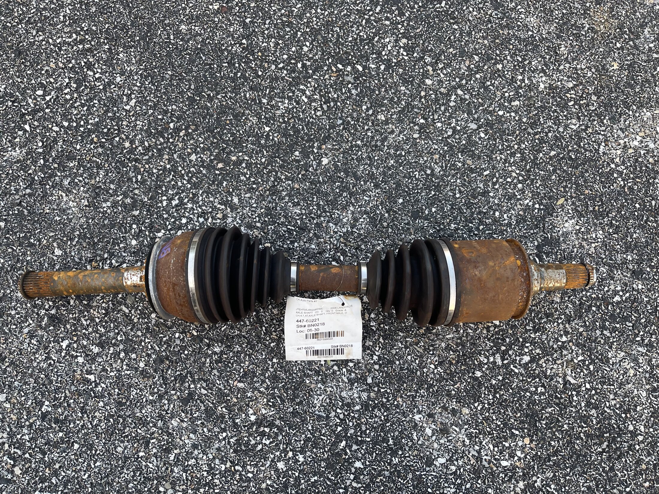

I wanted another axle to have on hand as a spare for my 2000 Land Cruiser, so I rolled the dice with ebay and found a salvage yard claiming to have an axle from an06 Land Cruiser. Here’s a picture of it. I paid $60 plus $35 for shipping. Looks like the boots have been redone. Can anybody tell if it’s original or did I just buy an aftermarket used axle? Worst case scenario I’ll use it as a core replacement and buy an OEM. 175k miles on the wrecked 06 it came out of.
Looks aftermarket.
Rusty areas around boots - Toyota paints those.
No dust shield on outer end as well.
Ufff da the splines…
Looks aftermarket.
10-4. I’ll be trading in that one as core I suppose. Thanks
having a second look, under that rust I see paint. who would trouble themselves with remanning an aftermarket axle? I believe it to be OEM. rust is removable surface rust. I think I'm still buying a new one though, and keeping this one for spare. no core charge around where I am if you buy new.
I would just buy an OEM unit if you can. I killed a CV in Moab last year and replaced it with a Napa unit since I needed one right then to finish my trip and I have always had good luck with Napa parts. I have been trying to track down a light vibration that I noticed several weeks after installing the CV on my way home and kind of assumed it was tires or wheel bearings. Had the truck on jack stands and noticed with all 4 wheels off and in drive that the Napa axle is visibly bent. I will be replacing both with new Toyota axles and hubs.
Better yet, I’m donating it. I can’t see doing all the work to replace an axel to put a questionable one in. I only bought because dealer told me remanned were discontinued and I didn’t ask if new ones were available, and I’d of rather put in a used OEM before an aftermarket. Turns out if you look around you can buy brand new ones for around $375 online from dealerships doing specials.
