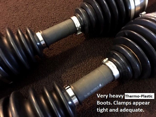

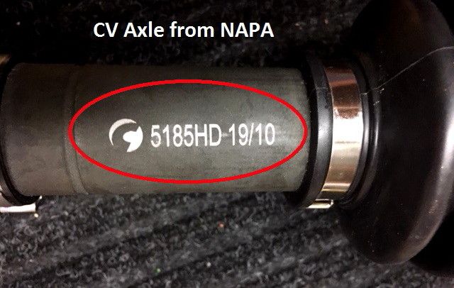

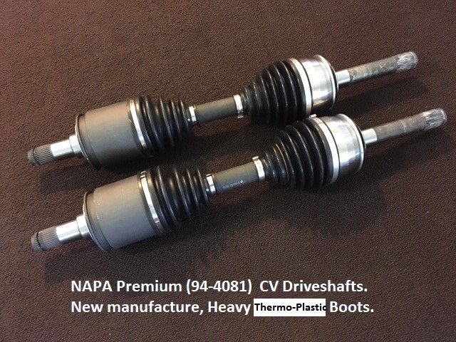

That is correct. The HD (which is what I purchased) have thick Thermo-Plastic boots (supposed to hold up longer).

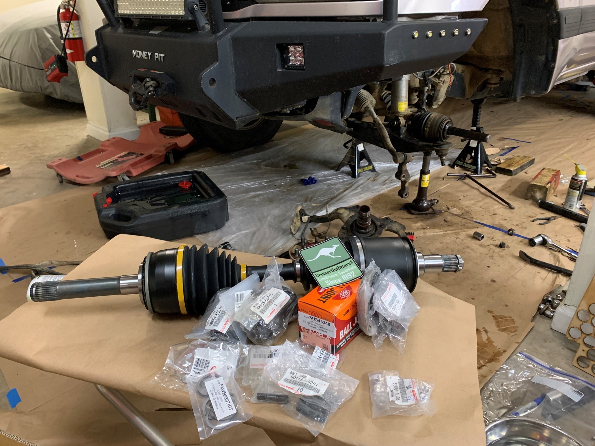

Due to a mishap this evening pulling my f'ing DS CV axle for the third time to address a leaking axle oil seal, the inner shaft popped out of the tulip, jacking up the c-clip that holds it in. So after getting the cv on the bench to address this, I discovered the inner shaft on Cardon CV's does indeed have 6 bearings. Just thought I would share that tid bit with the group.
I'm also happy to report a standard toyota c-clip for holding the axle in the tulip also fits the cardon axle tulip. I believe at this point the Cardon could be rebooted down the road in one chose to do so, using Toyota kit. I have to wonder if the same plant makes the Cardon as the ones for Toyota, just the Toyota ones receive more fit and finish milling etc for a "like a glove fit".

Definitely could be or could be something as simple as the Toyota ones receive a slight higher "quality" material base vs. the others. Could come from the exact same machines and whatnot. Or could be the quality of internals like the grease, ball bearings, races, cage, etc. that are made of higher quality material vs. a lower quality "cheaper" material.

Perfect so far. But only have a few thousand miles on them.
No leaking from differential (some have experienced), no vibration over 65 mph (have had it up to 80 mph).
Mine is mostly a Daily Driver, not much off-road use....so I can't speak to that.
But so far....I am satisfied with them.

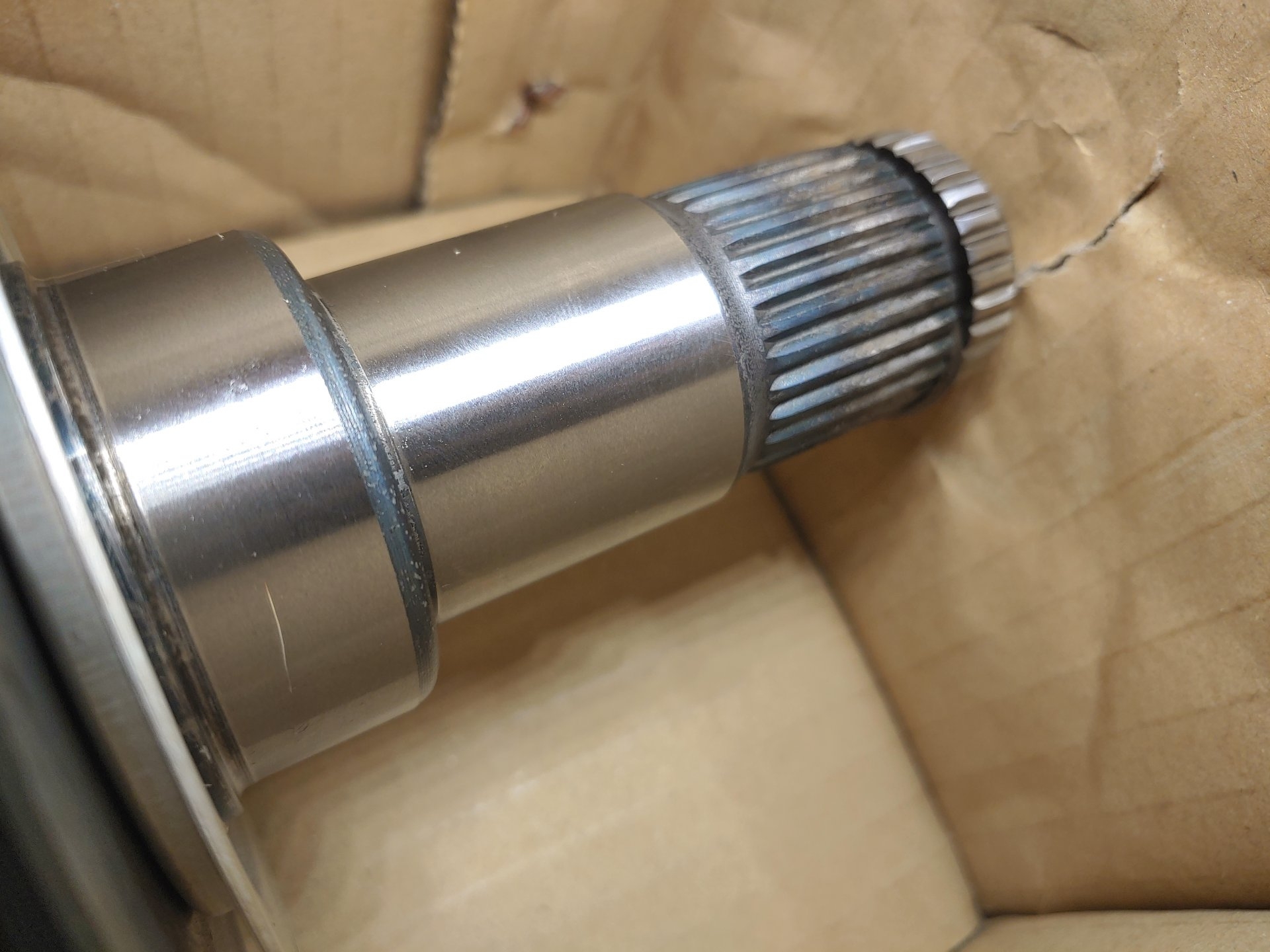

I hope I made the right choice, so far mine have done well. They are on my Wife's D/D (mostly highway use) so are not subjected to any hard use. The only thing about them (so far) that I found a bit troublesome was fitting them to new drive flanges. The 'fit' was VERY tight and could not be accomplished by hand.
Prior to installation I ran the drive flanges on and off of the CV splines quite a few times and that helped somewhat. But IF a roadside emergency were to occur.....I am expecting to have to wedge something under the drive flanges to remove them. Now....perhaps with use... they will wear 'in' and loosen up, I don't know. But you'll not have any 'clunk' with these if you also have new drive flanges, I can tell you that. ;)

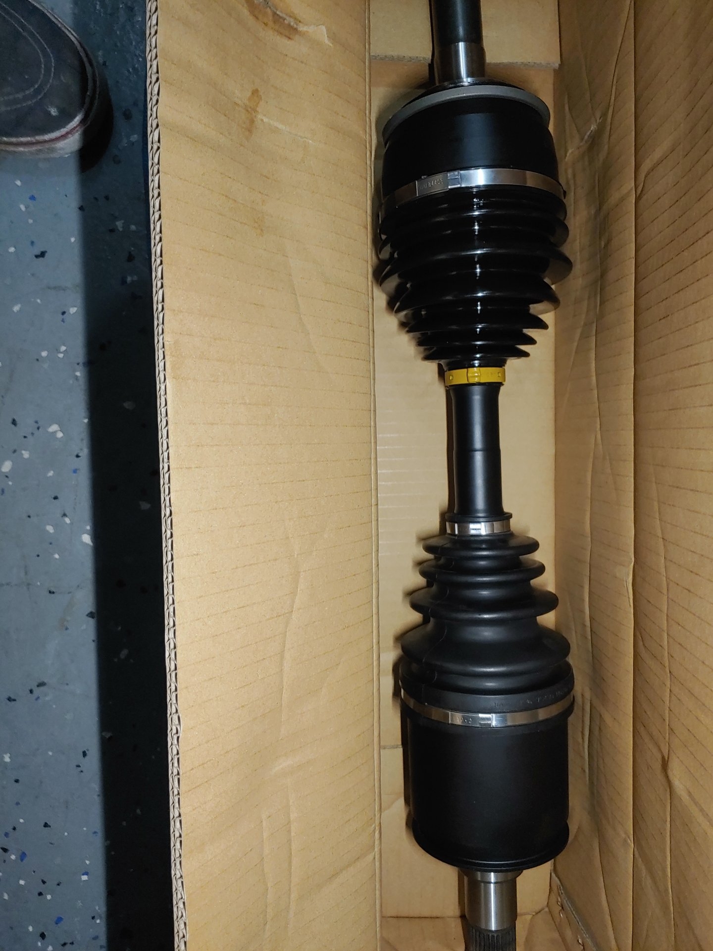

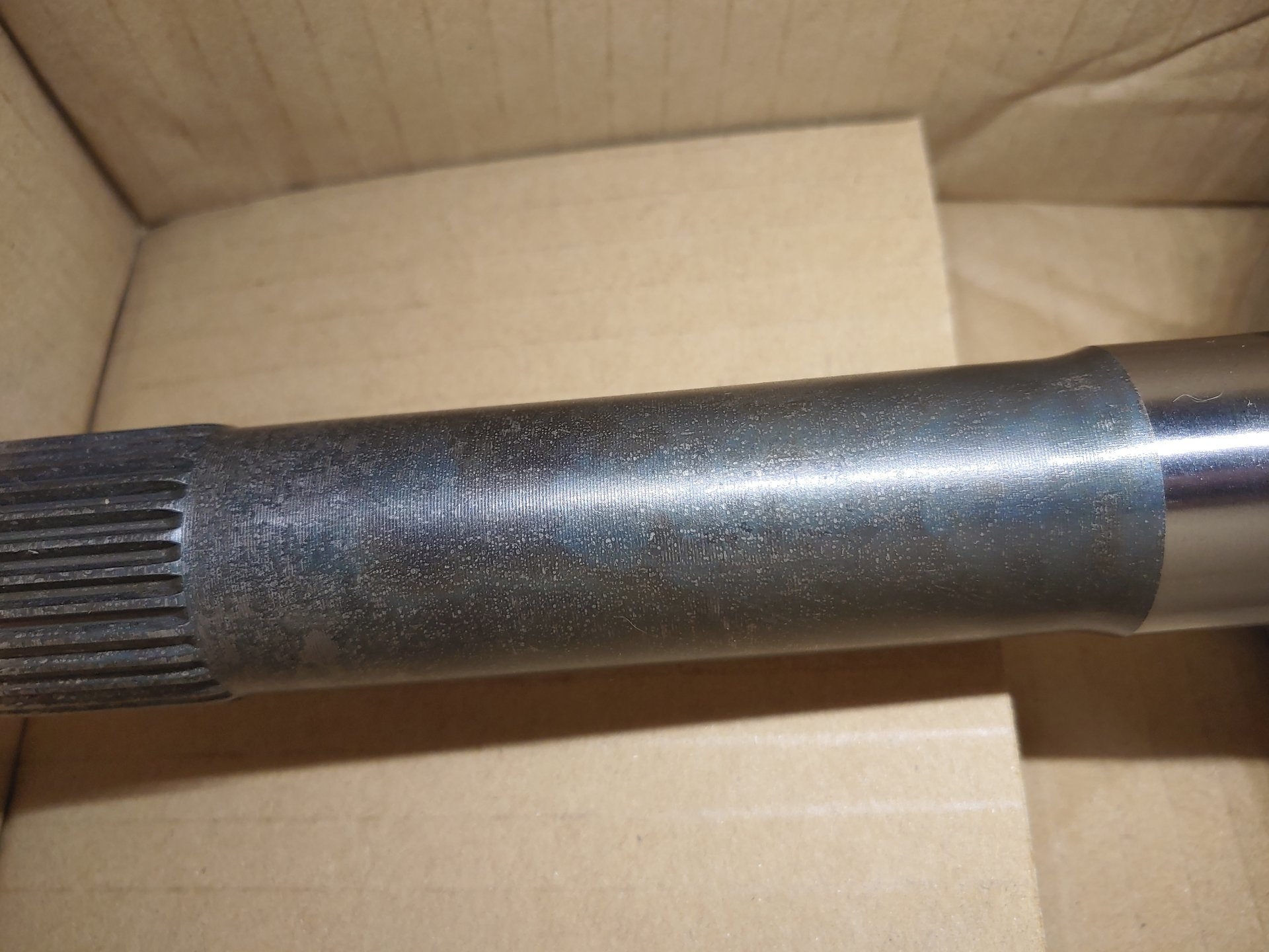

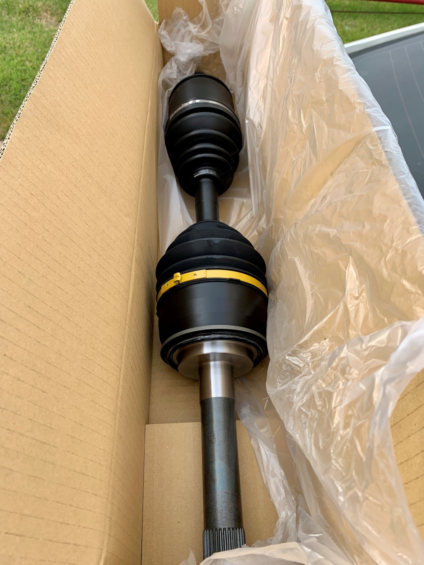

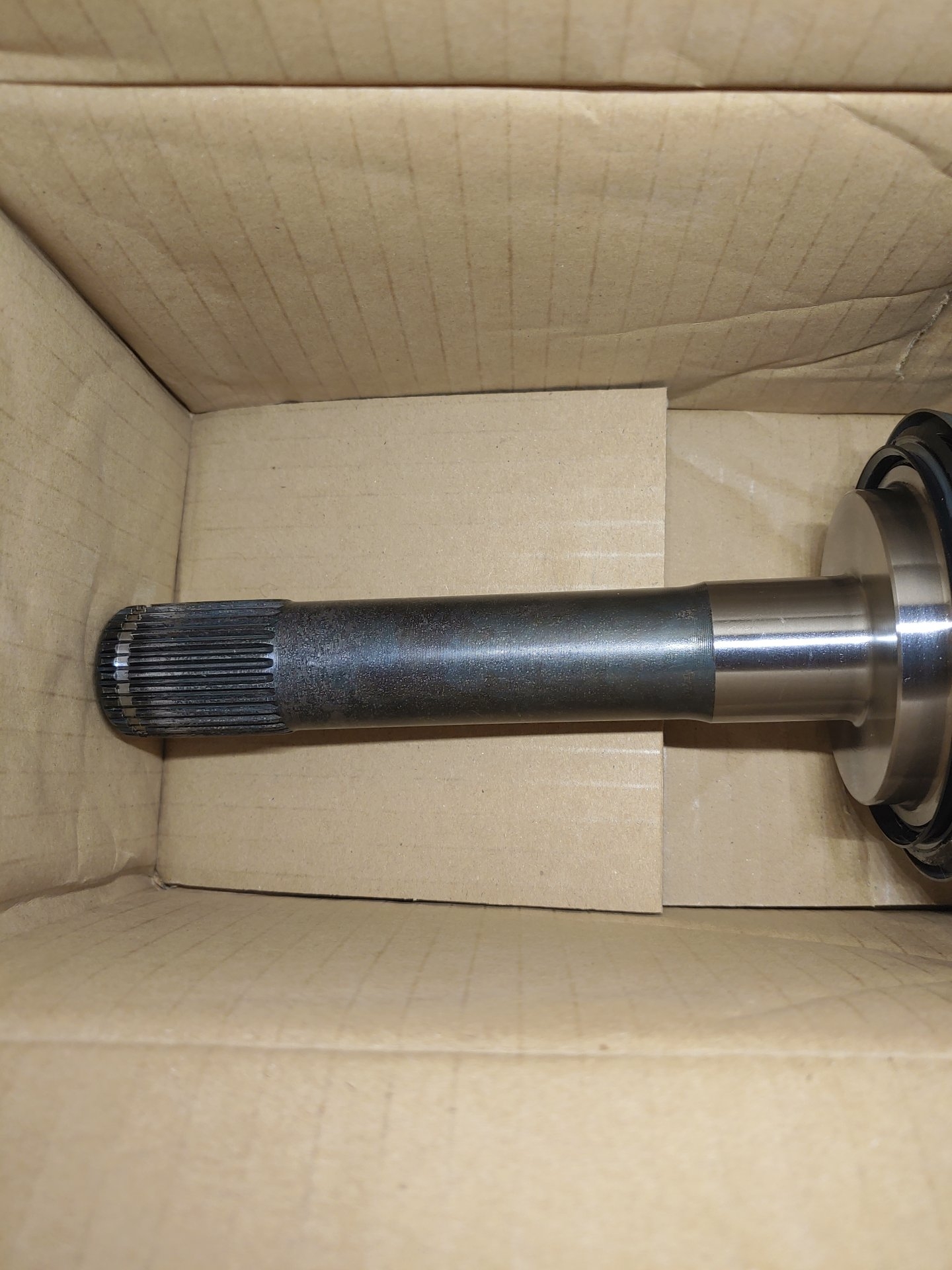

Has anyone else received an OEM CV axle with only 1 yellow boot clamp? Is this real or a fake OEM part?
I ordered from Discount Parts Monster

Correct, OEM has yellow bands on the outboard tulip and silver bands on inboard. Also, OEM has black painted intermediate shaft and tulips while (most) aftermarket do not and will develop surface rust very quickly because of it.

Should I be concerned that mine is fake since I only have one yellow band on the outboard shaft? Or seems legit? Everything else looks legit, both tulips are black
Yours looks to be OEM, I would not worry
