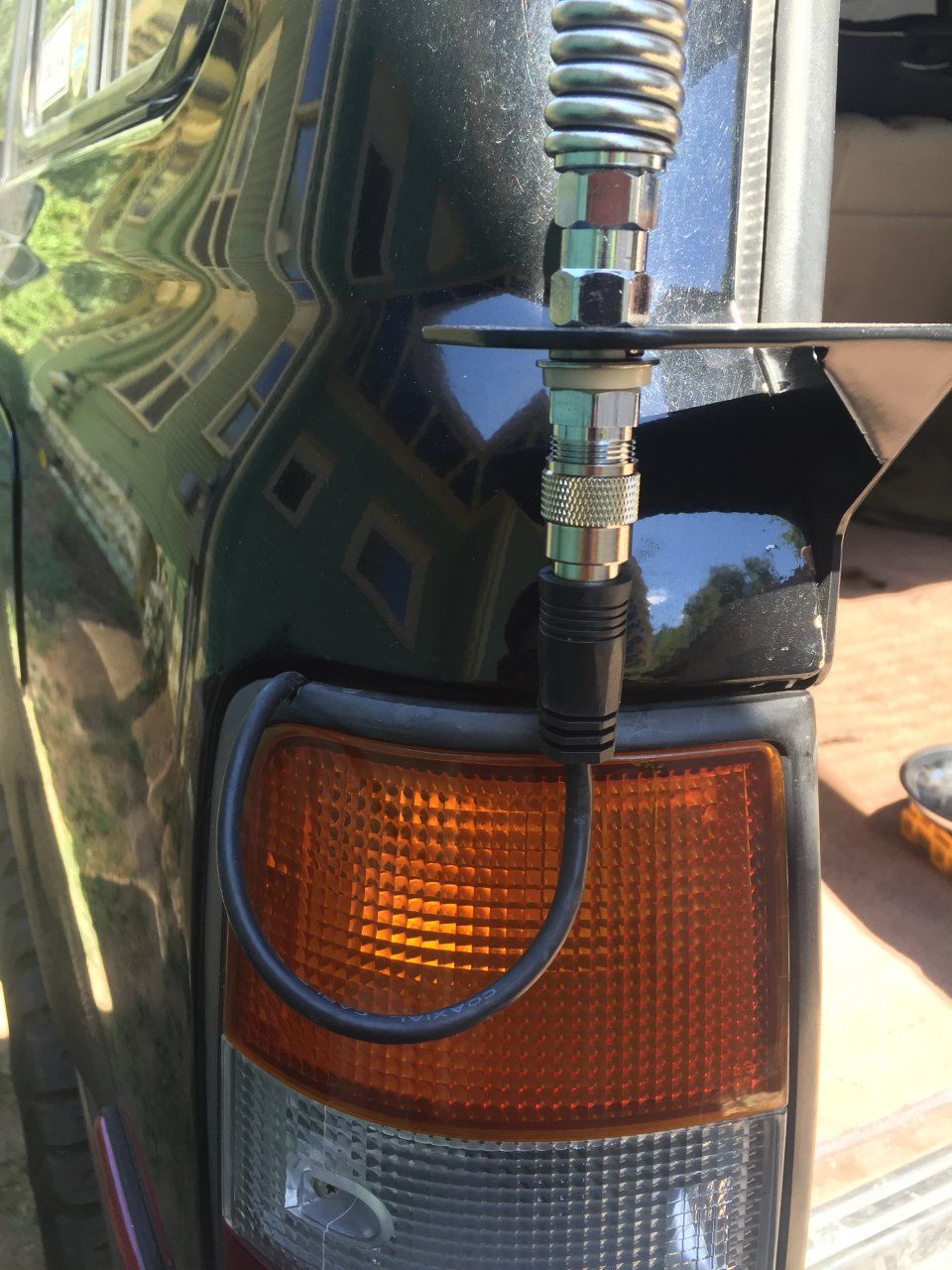

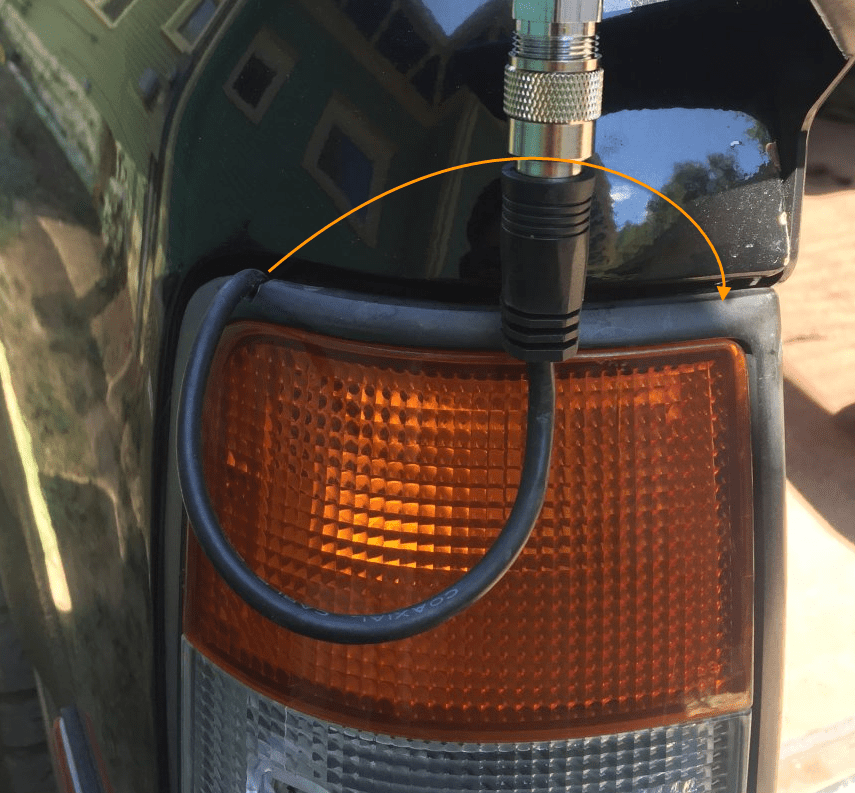

I would add a little more slack in the wire for a slightly downward loop.
Even though I live in California and there is no rain here, I am OCD over water coming inside the car following the antenna wire's path.

Noted, and will now be addressed tomorrow. Thanks for the insight.

Looks good, but not to nitpick but that routing wouldn't last 5min around the trails here. It would get snagged in a heart beat. Food for thought.
Are you thinking the best option is routing through the inside of the hatch? My only concern with that was drilling another hole, but if snagging potential is high then I will certainly go that route.
From the ones I have seen drill I would have drilled on the other side (inward to right in the pic). Could just black silicone that current hole and drill a new one more inward in the light housing).
Sorry, just IMHO. We have thick brush, pine, madrone etc, aside from the pinstriping they have move my rack around on top.

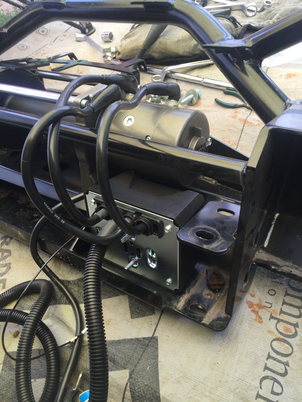

Hey guys, @Dragos80 , @NLXTACY , @retrofive , @GW Nugget is it a necessity that I be able to access the winch solenoid other than to plug in the controller once mounted?
It seems it bends the wires too much using either the warn mount or the Slee mount. However, I found this spot but I won't be able to remove it unless I remove the bumper, but I can access it for the controller.
With my limited experience it doesn't seem like a good solution.
Well, I think I found a solution.
I realized thin metal bends. I'll get the Slee mount to work with a vise tweak and a hammer although the solenoid won't be level. (Big deal?)
Well, if you blow a solenoid and want to replace it ;) other tahn that no.

Could extend the remote plug and then not worry about it. Put it where you need to.
I might just do that if this doesn't look good or work as I anticipate.
