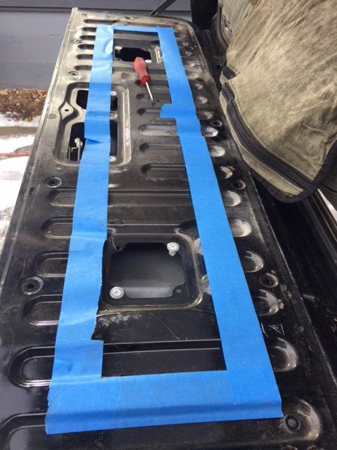

Step one- remove access panels and make sure you move the license plate wire so you don't cut through it.
Step two- place the lid where it will go using the existing holes and pop in a few of included hardware. Tape off inside of lid as a guide on where to cut. Get to hacking with jigsaw or grinder.

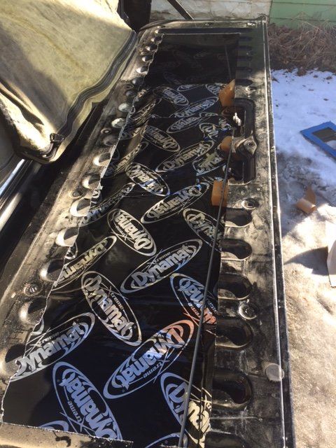

Step 3- once I had my cutout I chose to dyanmat the inside to cut down on the contents clinking around.

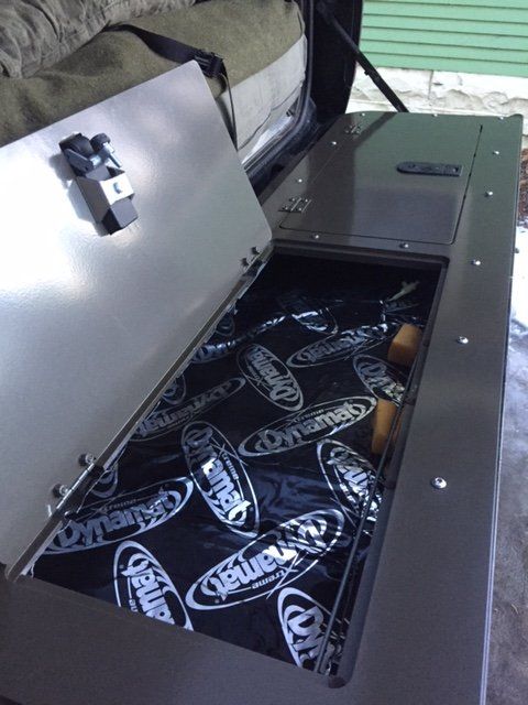

Step 4- Install lid using included hardware. Jason forewarned me that where the lid hardware meets the tailgate that in my year Cruiser I might have to bend/grind/file a little of the tailgate metal in order to get lid to shut smoothly. So 10 minutes was required with the dremmel shaving down the inside of the tailgate (not the lid) at the 3 indentation from the bottom and 3 indentation from the top. (see above pic)
Step 5- go have a cocktail.
Still have to tweak/maybe grind the inside of the lid as I'm getting a little rubbing from the tailgate latch hardware, might have to do with me cracking down the hardware too much?
In short, I couldn't be more pleased and am equally as excited to have Jason building a bumper for me.

For those that are wondering what the issue is.... I overbuilt the lid support reinforcement and for some reason the 95-97 latch release rod rubs on the lid. I used a 93 lid to design off of and mine works flawlessly without any rubbing. So, All the ones in stock I have ground the inner lid down to correct the issue for future buyers.
Jason

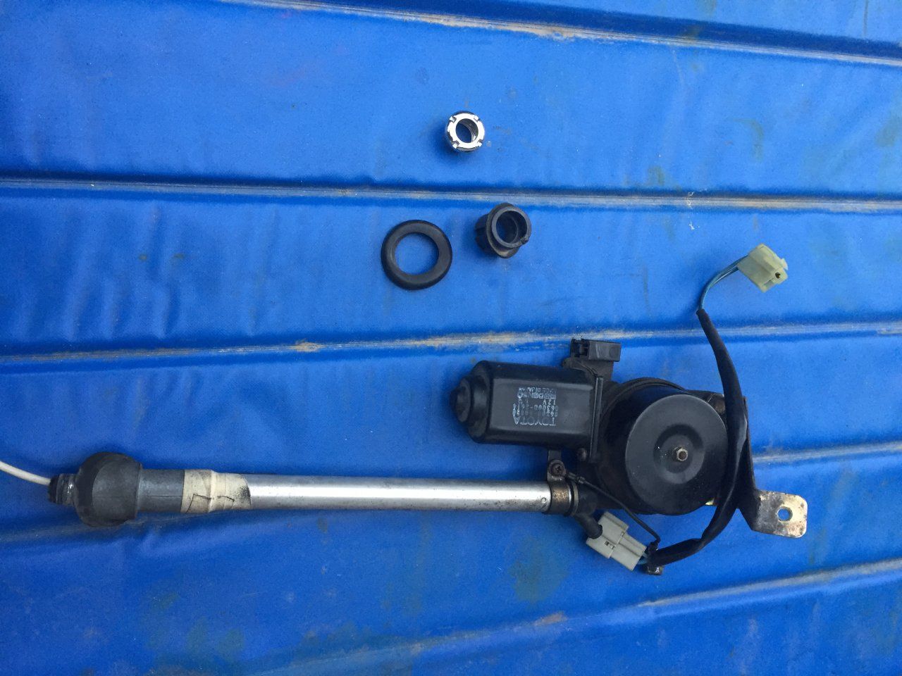

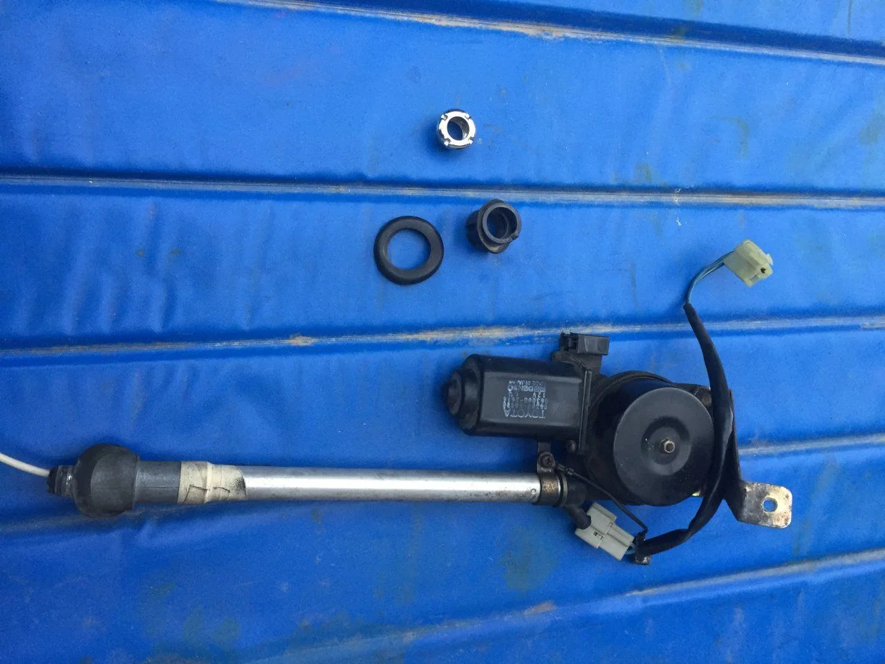

In case anyone was curious I used Napa antenna 730-5903 for 15.99. Came with exactly the amount of coax to run to head unit.
Anyone need a working antenna motor?? @NLXTACY @beno @Salue @Dragos80 @Dissent @DOCBG or anyone else? Just needs a new mast.
if you are serious i am trying to do this job and need the tube the mast rides in, the tube the antenna cable is attached to. I sure would appreciate any hints for the wire passing through the grommet in the firewall. I am stuck and how to proceed.
