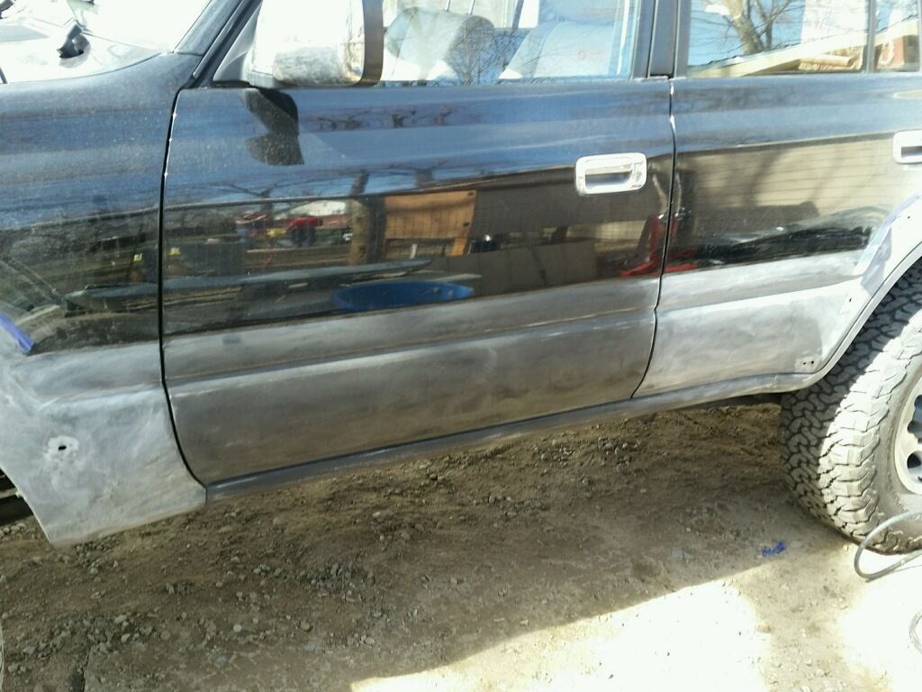

Alrighty, for those that have been as curious as I was as to options of fender hole delete, this is what I opted for after seeing @DOCBG rig at Slee. Mind you I talked to a few body shops and MUD members and this is the option that seemed to make the most sense for ME from a cost, time, and reliability perspective. Yes, I realize the best option is welding, IF you can find someone that won't screw it up (likely with the thinness of metal and I've seen a few botched jobs)
So with Rick's permission, here's a little about his process.
Fiberglass reinforced filler. While welding is primo there is the potential for other problems, cost twice as much (unless you can weld). When I checked out 2 places in Fort Collins the lowest estimate was 1500. Please don't start telling me "I found it for X" as YMMV, and I'm skeptical of anyone who's work I haven't seen first hand.
Rick's words with specifics left out due to it being his process, not mine.
"Sand the area to be lined, then grind the dented area. I don't grind it clean to the metal on an 80 because the sealer already has great integrity. Between the chemical bond of the filler resin and mechanical bond of the grind, there is plenty of bonding strength . By not completly grinding to the bare metal there won't be any risk of future corrosion."
That pretty much sums it up. Raptor lining was used, spray on, and 2 coats (or maybe 3, I honestly can't remember)
Should something not work, it fail, whatevs, I have no doubt that Rick will stand behind his work. So for those in the Front Range looking for a similar job hit me up, or DOCBG for Rick's contact.
Any prep done to the backside of the holes? Just squish it in there and sand it? Any particular filler preferred? Thank you for taking the time to post this up!
Rick used dynatron dyna-glass. I believe the process actually requires denting the holes slightly then filling. I believe yes, just squish it in but I did come across this product that I was going to use if I took the time to do it myself.
There are a few mentions of it being used on MUD, when I searched but nothing terribly informative. Most of the reviews I found were from classic car restorers.
I'll give it a whirl myself if I only have a hole or two to fill.

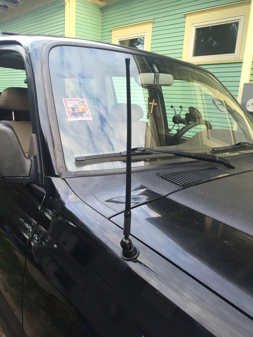

Well, I've had crappy FM reception since I purchased the rig back in early September.
Much like everything else I've done myself I researched the crap out of this before diving in. The biggest takeaway from all of the threads was DO NOT LOSE THE ANTENNA CABLE that runs from the mast/motor to the head unit, otherwise you have to fish something through the firewall and around a multitude of crap."
My thoughts were of course, "Simple enough, cmon I'm not an idiot....."
(In actuality, yes,...yes, I am when it comes to working on my cruiser)
So, in short, I finally removed the antenna nut, dropped the auto-antenna motor, fished it out, cut the antenna coax from the motor, and taped some string to chase it through.... Wrong guy... You forgot about the rubber gasket at the firewall junction and the tape was to thick. SNAP!! "FU**!!! You gotta be kidding me." Coax broke, no way to get it through.
Commence fishing new cable.......after removing rubber gasket, remove glove box, reach up and right, find electrical wire (similar to coat hanger) and eventually pulled the new wire and antenna through.
After 6 hours, (you heard me) and 2 double tall cocktails, presto, I have TUNES!! (Until I install a snorkel)
Gasket of my woes... This is found at the firewall junction and your current antenna cable runs through this.
Chasing new cable through using wire.
Finished product.
In case anyone was curious I used Napa antenna 730-5903 for 15.99. Came with exactly the amount of coax to run to head unit.

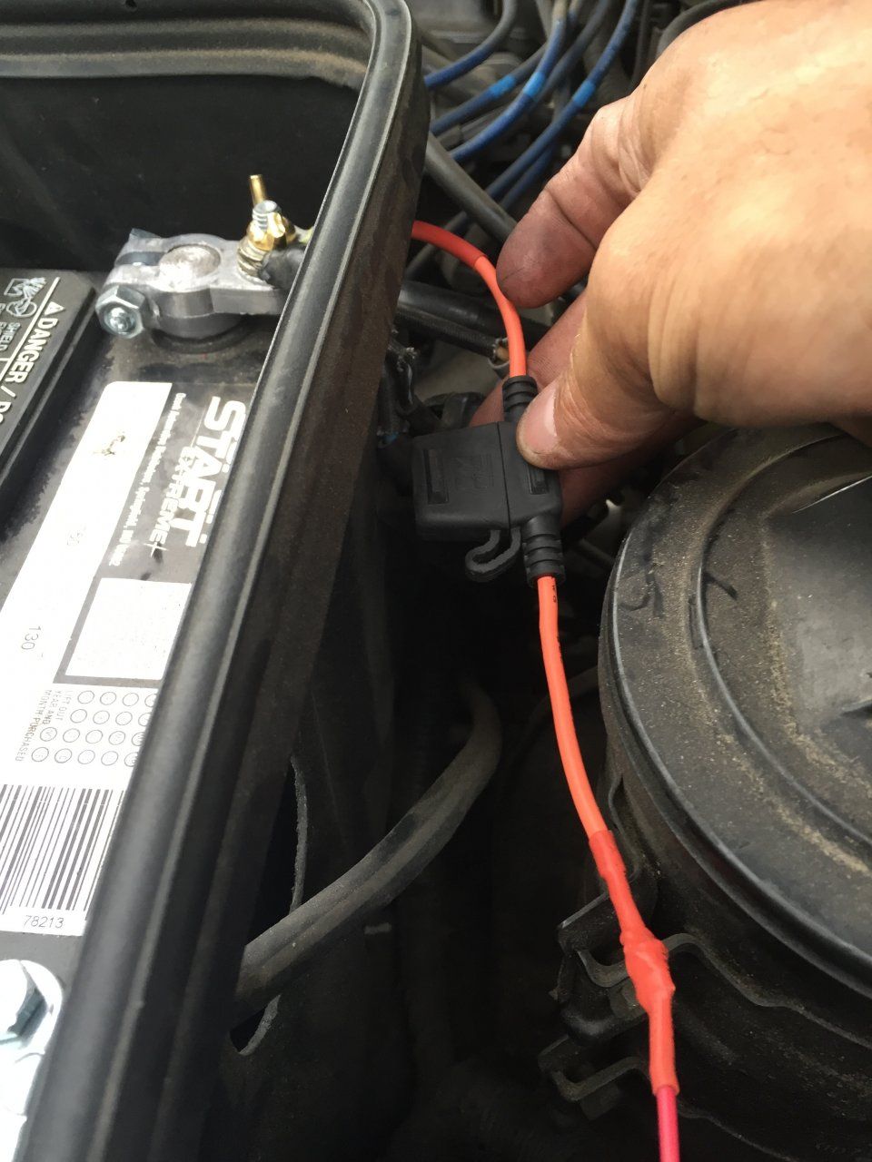

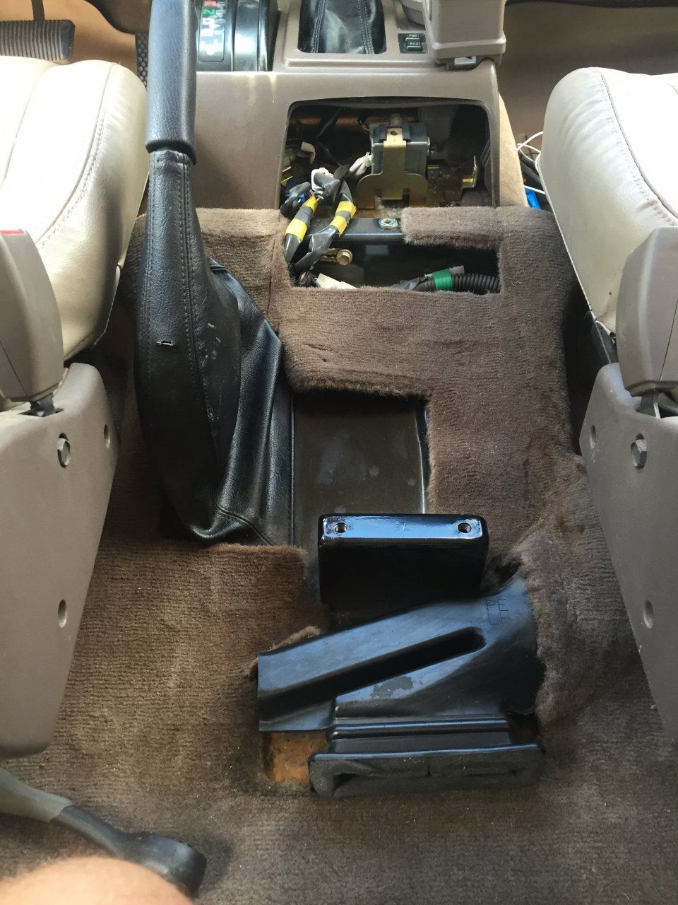

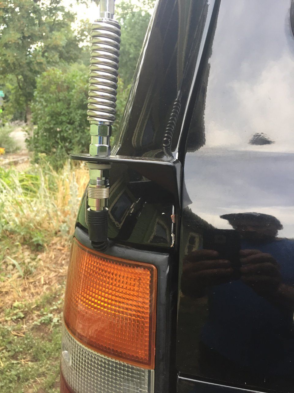

CB install day.
No need to reiterate the entire process as @RiFF RaFF did that for us with his build. Suffice it to say I followed his thread pretty much to the "T."
I just wish I had a SWR meter and normal instructions on how to use this freaking thing. Also I am hoping I made the correct solder (first attempt) inside the CB as noted in RiFF RaFF's thread. (I'm skeptical it'll work on my first try)
Frank @yodaTEQ 's bracket is obviously working like a charm. Like a lot of people I ran the coax thought the tail light grommet behind the trim, under the carpet, and under the console, and behind the dash.
Power directly to battery through DS firewall, grounded to a separate body screw next to the battery tray, inline fuse soldered in (first for that as well, HF soldering iron doesn't seem to work that well, or I suck, which is probably the case )

In-line fuse.

Yodateq bracket, spring, and 3 ft firestix.
