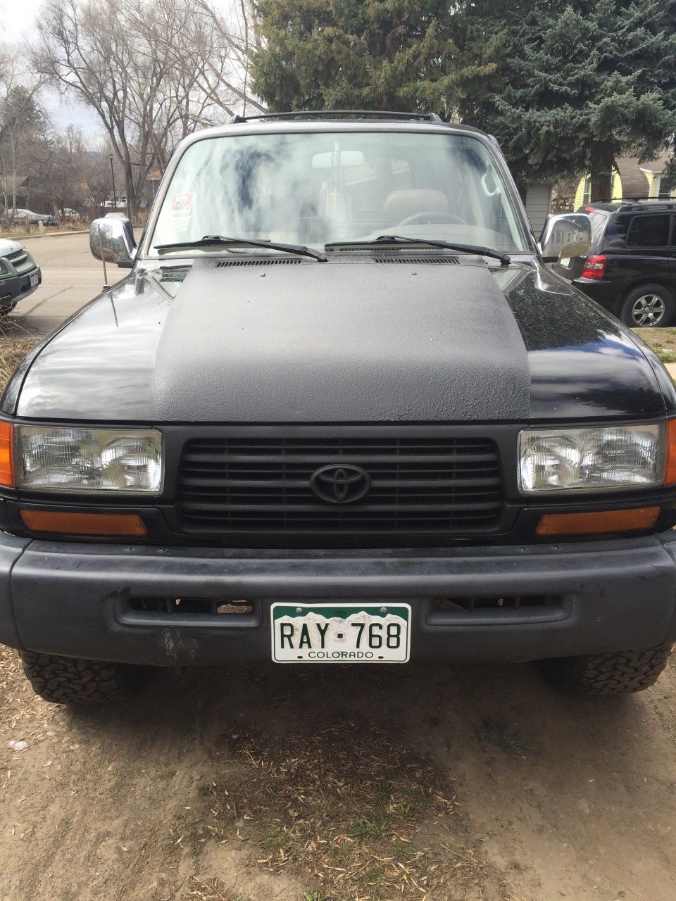

Well, 2 steps forward....and a quarter mile back.

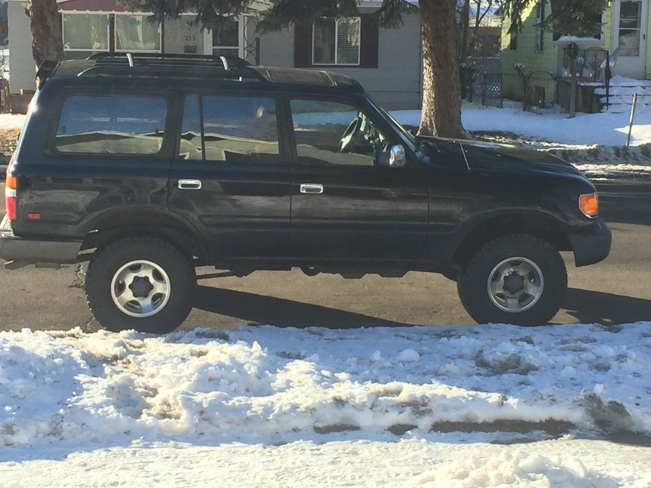

OME 2.5 inch lift, and Goodyear K02 305/70/16 rubber. Psyched on this for sure.
However, we realized the front axle needs a rebuilt.... and the viscous coupler.... and the drag chain is seized (common), and the power steering pump,...... I'm sure I'll find more things as I start replacing.
Also, need a new passenger side door handle, upgrade radio (stock speakers and head unit suck) then bumpers. Really wish I could get the fender flare holes taken care of ASAP, and the old roof rack gone!
As I said in another thread, don't ever let me meet the previous owner of this rig. I hate people that don't take care of vehicles.... especially vehicles that originally had a price tag of 50k+
Oh, and @DKBrulles as soon as I get this rig in shape, you better believe I'll hit you up. Me and the wife spend a lot of time in the spring/summer at Vedauwoo.

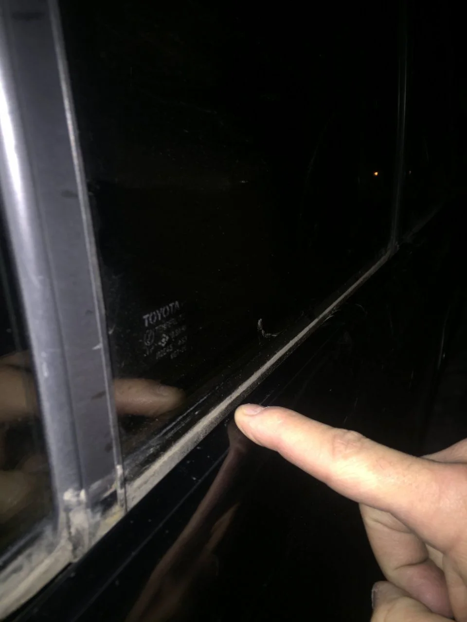

I get a good hookup on factory parts, and thise "belt mouldings" are about $50 each with a discount, and the large land cruiser badge was $90. I'm picky, so I bought them. My alternative was to peel all the black off them and go with the stainless look, but it didn't want to come off easily.
Thanks for the heads up warezdog. I might have to look you up when I make it back to Md so you can show me a few trails in your neck of the woods. I am, after all, a born and raised Baltimoron.
Sweet, we could go up to Rausch Creek for a day, I rent a dairy barn on a farm with 220 acres too and the guy lets me run thru it as long as I don't make the guy farming the land mad.
Yeah, I'm going to have to drop some coin on new moulding for sure. The gap is too big for my liking and I'd be concerned something would slip down and mess with the power windows.
No way to peel the black off mine, like yours they were too banged up and didn't want separate from the stainless/chrome piece.
Here it is without the moulding.

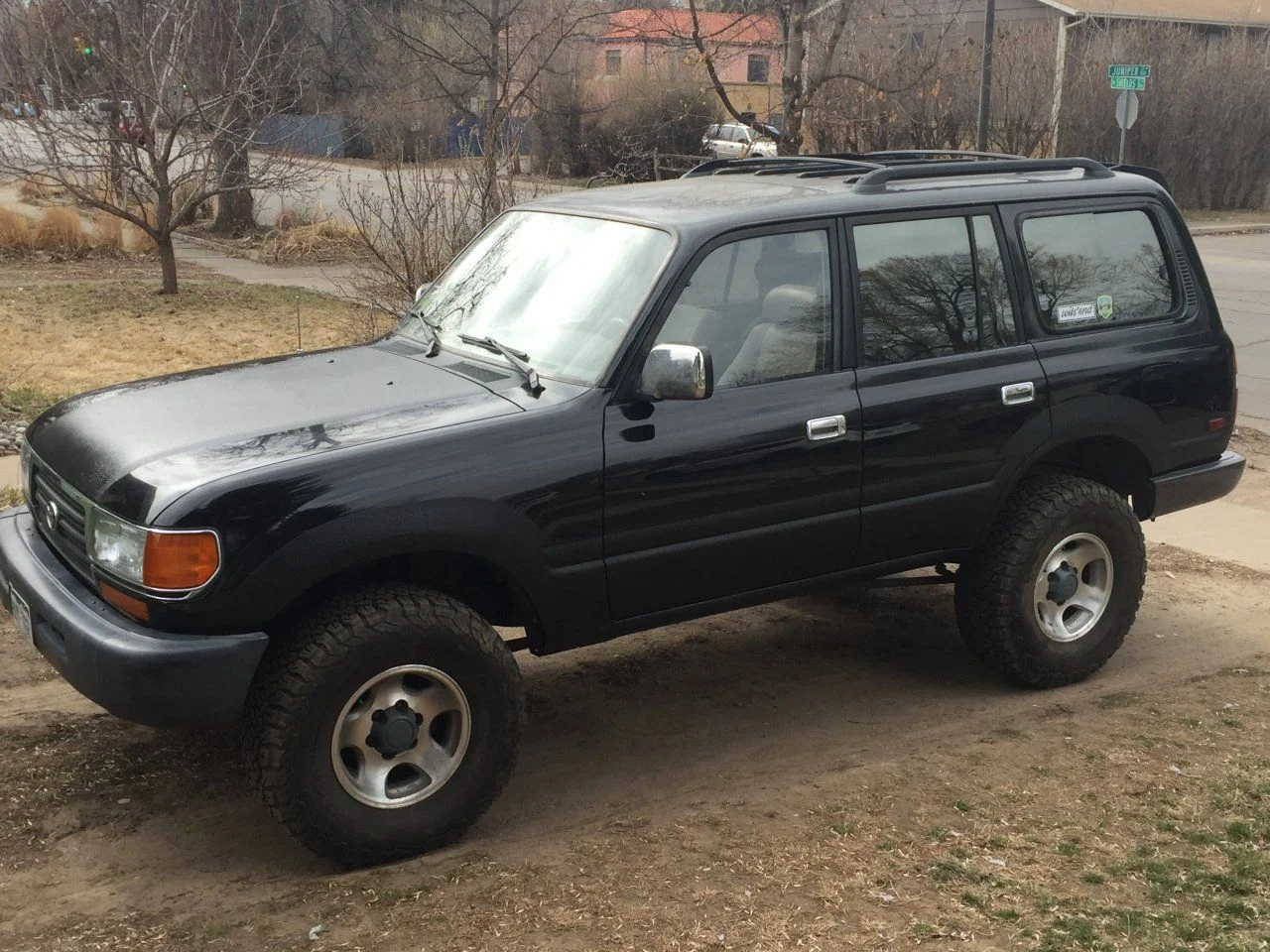

Well, been a while. Here's what's been happening.
VC repplaced.
Front axle rebuild with new drivers side burf.

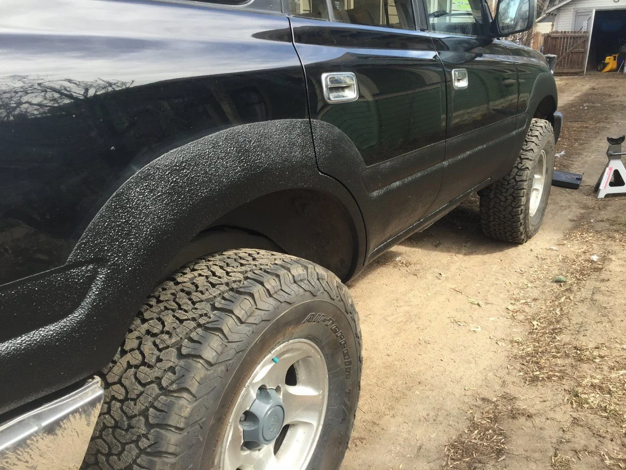

Also, got the fender flare holes taken care of thanks to Rick in Loveland on @DOCBG s recommendation, and after checking out his rig when I was at Slee.
Without further ado.
If anyone is looking to fender delete and is in the Northern Colorado are I def recommend Rick. His dad owned a body shop when he was growing up and had been working on cars and trucks for 30+ years.
He's actually working on pretty good looking 40 series and awesome looking 60 series that will be on the market in a few months.
Oh, and much to my dismay Rick was able to tell me a few things about my cruisers body that I didn't realize. After market fender, and prob replaced hood... @Salue it would seem you are correct, one of the fender flares was NOT original.

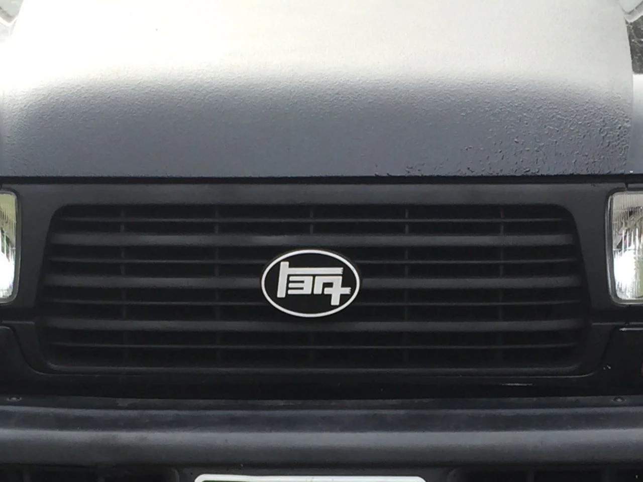

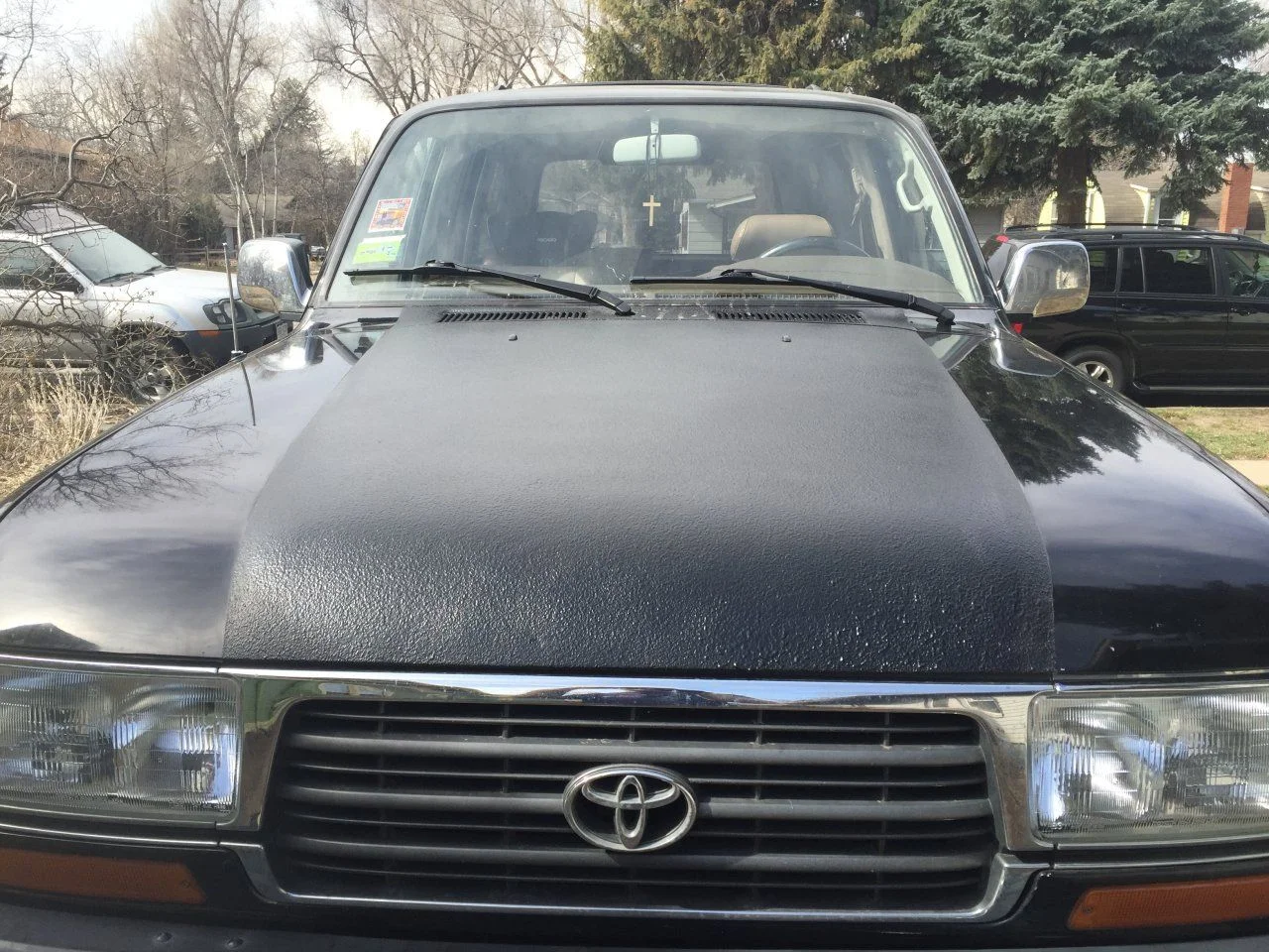

"Night Rider"blacked out look. (For those old enough to know who the night rider is)
Figured it matches the raptor liner on the sides. Might even do the mirrors.... Still in debate.

Very nice. After welding the flare holes on my first 80, I don't want to do it again. Unfortunately, I've already removed the flares from 80 #2 so I'm looking for options... What did you have do yo plug the flare holes?
Added a little bling a-la @bhicks
FYI, this guys is the quickest shipper around. Ordered Thursday, arrived at my door on Saturday. Cali to Colorado in about 48 hours, not too shabby.
Hey Bryson I'll add Rick's process tonight for the fender flare holes, as few people have been asking.
However, I have to drag myself to, and from, a 3 year old b-day party first, then I'll post up the notes.
Big pop-rivots work great if you go thick with bedliner - PO of my old green "pink panties" used them, it took me a good while before I noticed.
