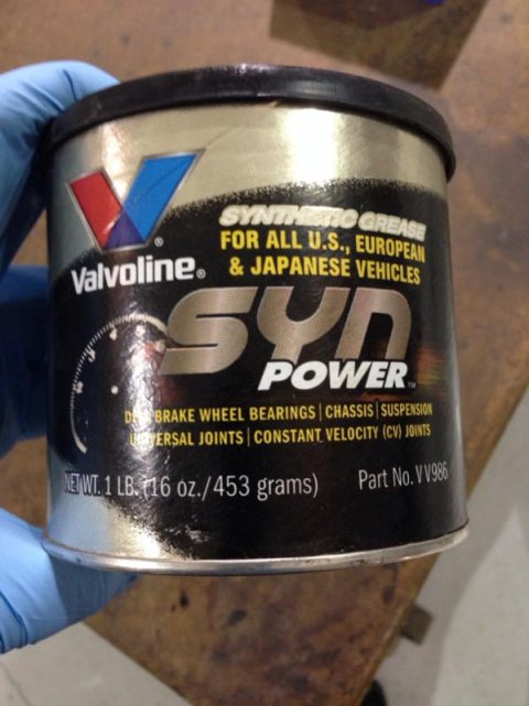

Quick question. Is this grease ok for the rebuild?
The container said it was moly fortified. I hope that works because I've already used it.
