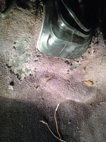

On to the next project. My heat doesn't work. I read about using muriatic acid to clean the heater core out. I was even told to use it by a radiator shop. I guess there must have been a hole in it that the crap was covering up because once I finished, it started dripping the acid and antifreeze in the cab of my cruiser. The acid eats carpet by the way. So, I tore into the heating system and ordered a new heater core. image-4094863485.webp It wasn't too hard tearing everything apart. I just hope it goes back together as smoothly. image-2650052977.webp This is thd burned carpet.
Did you neutralize it with baking soda? That stuff's nasty, and will keep on eating if it's not totally neutralized. It's not the strongest stuff, so it takes its time, but it will dissolve things no problem.
I cleaned gunnite pools with it one summer, and we kept a 100lb bag of sodium bicarb on the truck "just in case." Turns out that was a good thing, cleaning a drained pool, walking down to the deep end, my rubber boots slipped and I slid down into about 6" of standing muriatic acid. By the time I got back out of the pool, the other guy had the bicarb off the truck, and was throwing handfuls of it on me. That stuff sizzling with the acid on skin is a really odd sensation. Anyway, I was fine, but it dissolved the bathing suit type shorts I was wearing, leaving me in my boxers. We had another guy that was a r'tard, and didn't wear the rubber boots on a job several weeks before that. It ate his work boots and left bad burns on his feet. Heeeeeeeres your sign.
That's pretty intense. I poured water all over it flooding it and letting it drain out of one of the drain holes, but after reading your post I poured baking soda and water over the top of it. I got some of it on my hand and was surprised at how much it burned. I was using the 31% concentration.
