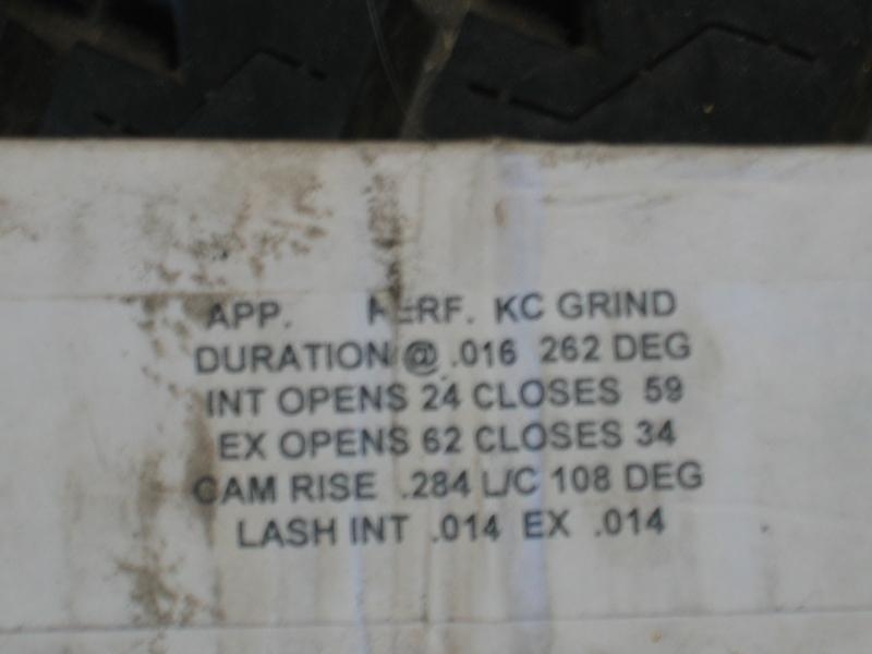

Might want to recheck, intake and exhaust lash are not the same. I think .008 and .014? I would need to look it up.
I set them both at .014 based on the different cam setup from Delta Cam. Browsing a couple threads here there was some discussion about different valve lash for different spec cams, I have the KC grind from them.
Here's a pic stolen from another thread.

I appreciate the input though, 100%. In reality I have no idea what I'm doing.
This is great tech info @rkymtnflyfisher, although a bit disconcerting for those of us that don’t have knowledge of the history of our old motors, specifically if there has been any cam work. Didn’t even realize that the lash settings would be different than original, but makes sense. Now I have to throw this potential conflict in my quest to get a properly functioning motor. Not sure what/how I can determine cam specs without tearing down the motor. I guess I could do some trial and error with the lash settings. Is it common for ground/modified cams to have equal intake/exhaust valve lash settings? @whitey45? The settings on mine when I got it (again, no known history on this engine for me) were pretty much close to OEM spec, so maybe that answers my questions.
I didn't realize the lash would be different either until I was reading a couple other threads, and I have no idea how to determine if a cam is not OEM spec. I guess it would need to be pulled and mic'ed to see what the actual measurements are.
I did gain a little vacuum reading, when I had the lash set at OEM spec it was only pulling 12-13, with the .014 lash it was up to about 16.5.
There was no noticeable improvement in performance yesterday on the test drive.
The real test will be if I see any improvement in MPG.
You can pull the valve cover and rotate the engine to measure valve lift. Without pulling the cam, that’s about it as far as I know. You should be able to tell from that if it is non-stock lift, but that won’t tell you duration, lobe separation, etc unless you’re really good.
