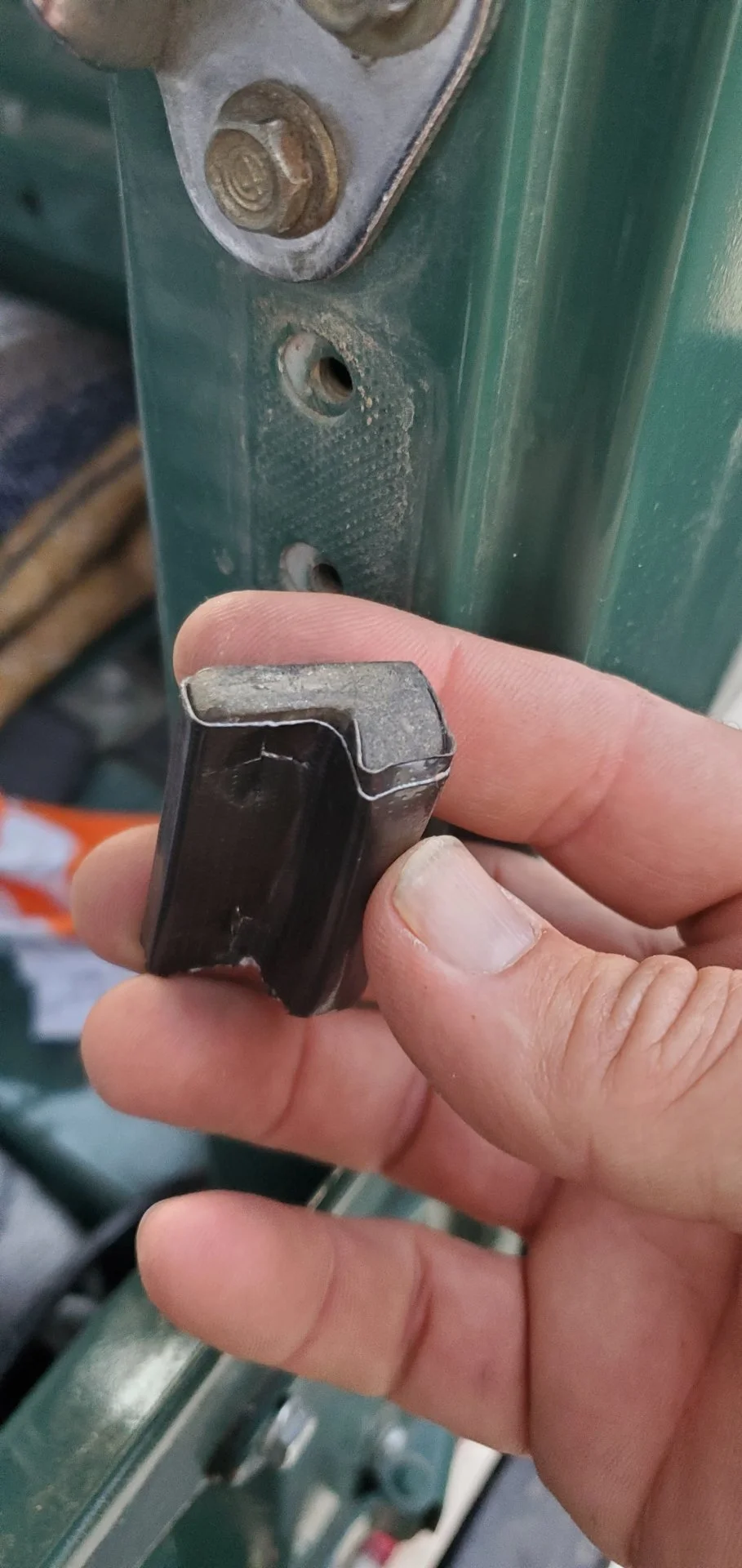

Chasing a pesky rattle that I heat when I'm driving dirt roads, I tracked it down to the latch for the rear hatch. I adjusted the hatch to center it more and made sure the latch was positioned as far in as it would go.
How about a wrap of Gorilla tape to dampen the metal to metal contact.

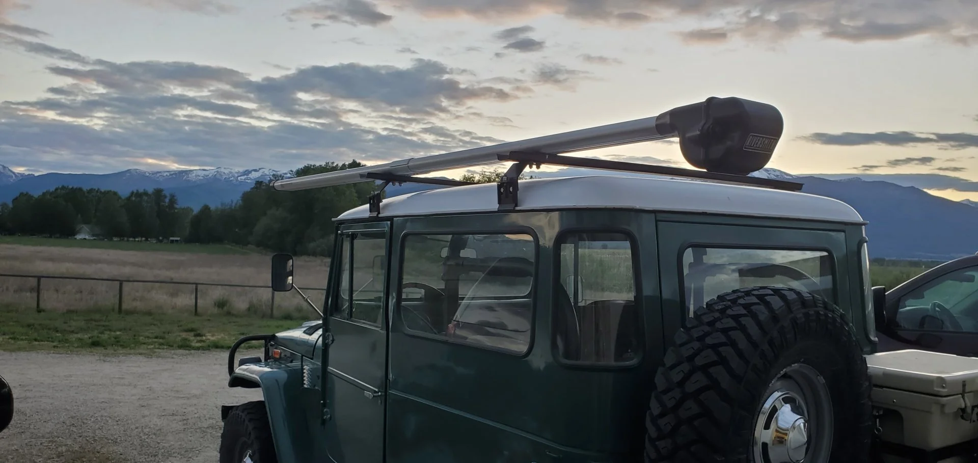

Also put the rod carrier back on top, the rivers are getting back to normal flows.

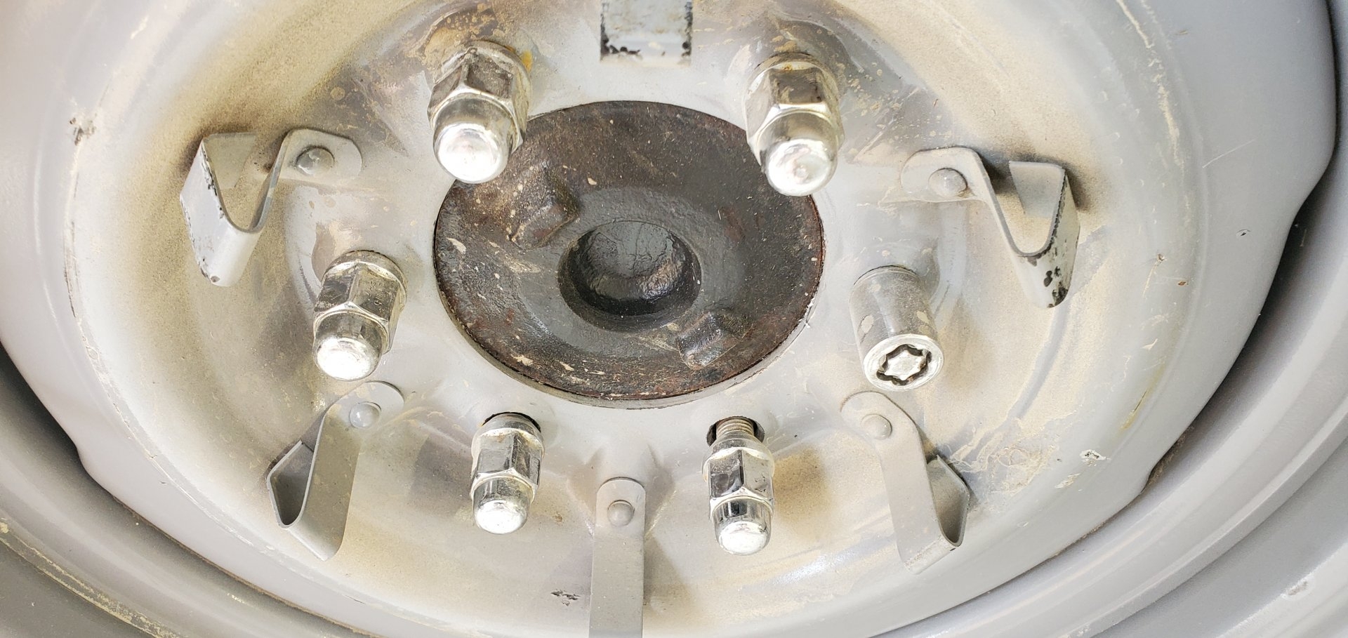

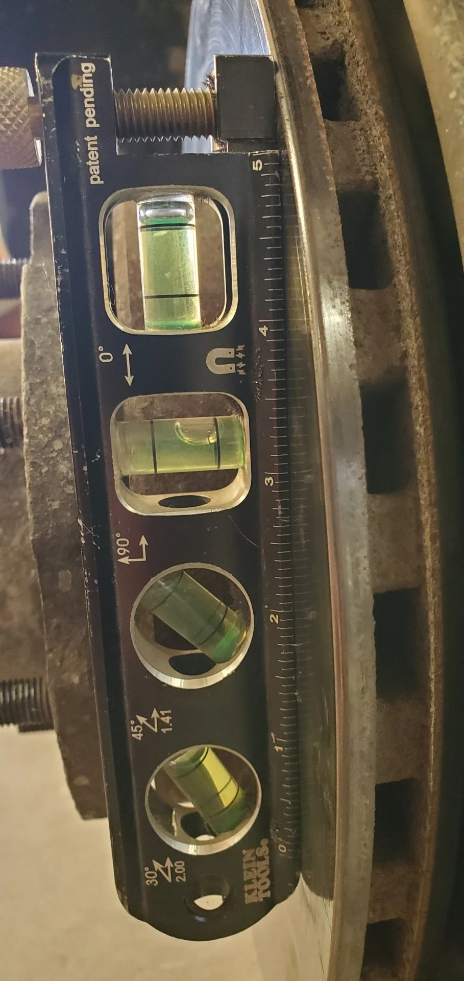

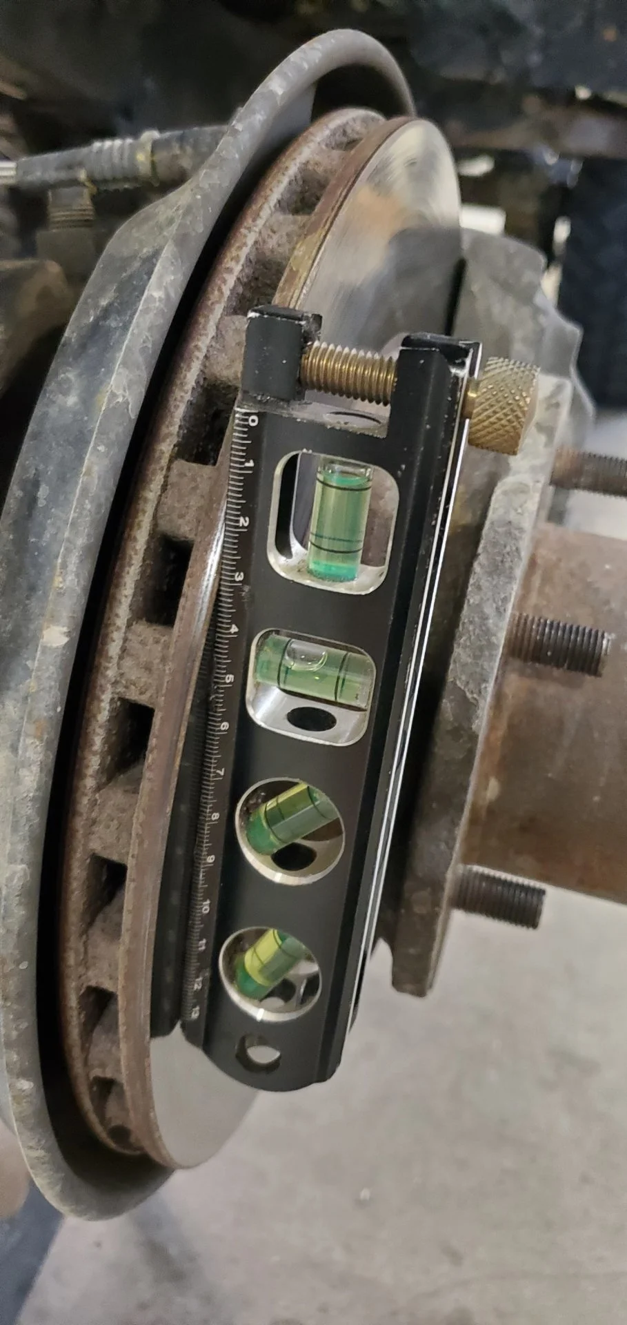

I've noticed some abnormal wear on my right front tire lately so I decided to rotate them and check the front end for any unusual wear or damage.
Nothing really seemed out of the ordinary to the untrained amateur eye, other than the tread wear.
The toe in was right at 1/4" at a 36" reference point, I did adjust that out just about a shaved hair over 1/16". I'm sure you understand.
I did notice that the camber was suspicious, the tread wear is on the outer edge of the right front, pretty obvious wear, cupping to go along with it.
I didn't take an exact degree reading of the camber angle due to the fact that it's fixed, nothing I can adjust on it.
We all like pics.
Here's the disc's with a level on them, axle checked out to be fairly level(ish).
