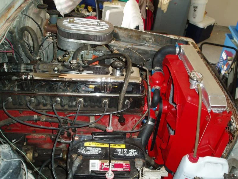

eBay Aluminum Champion Radiator
The three core bolted right up. It is a great deal and in South Texas heat, it is running a chilly 170-180.
This is a factory replica - that is why it has the split hose connections and bent filler neck. Exact copy of the old one I had in my '72.
Next on my list is the overflow tank :p
