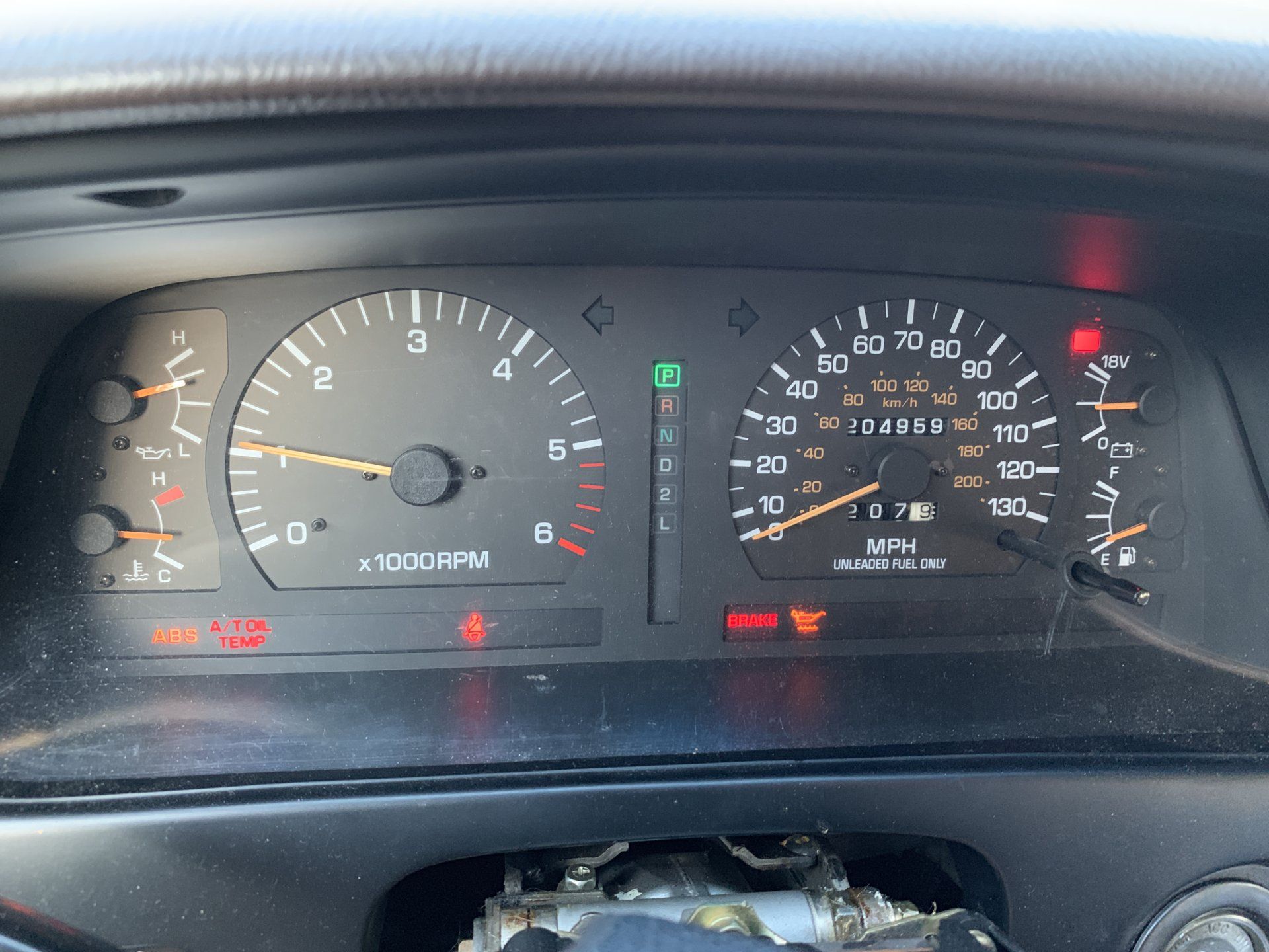

This is the first time it’s happened. Turned it on and the warning lights did not turn off as usual.
Alternator is not putting out enough volts (see above). The voltmeter (upper right in the instrument cluster) needle is below horizontal which means under 12 volts, should be something like 13.5 when idling.

Alternator. It can pass the diode check and still be bad. Did you have a shop run a check on it? Look at your voltmeter, its way low while the engine is on ie your alt is not putting out.
You can test the output of the alternator with a voltmeter if its 14.3 then maybe its the cable between your battery and alt / fusible link. But 9.9 times out of 10 in this situation its the alternator.
