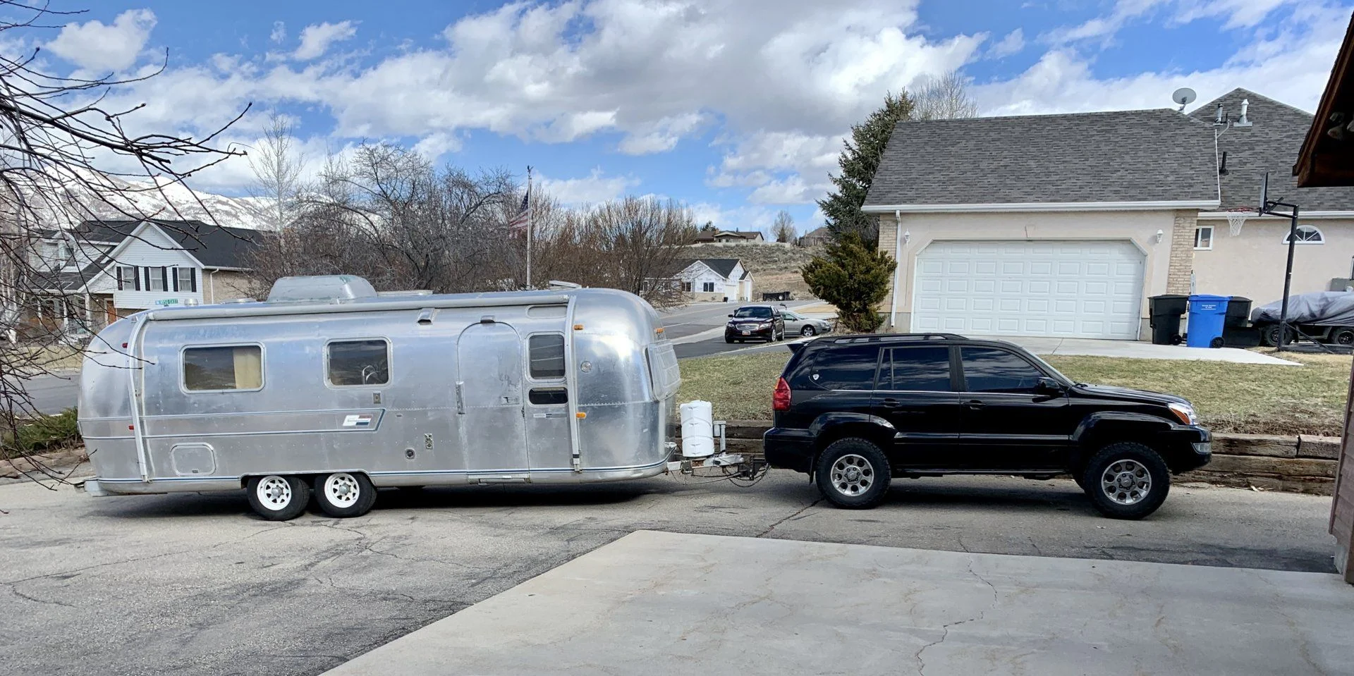

Sold the ~3600 lb dry (4500 lb GVWR) 22’ airstream last fall. Picked up this old 27’ airstream last weekend. It’s dry weight is supposedly 4575 on with a GVWR of 6500). I haven’t weighed it yet but instead of the 11-13mpg I used to get towing, I got 9 mpg on the interstate coming home. I might need to budget a re-gear into this.
Sold the ~3600 lb dry (4500 lb GVWR) 22’ airstream last fall. Picked up this old 27’ airstream last weekend. It’s dry weight is supposedly 4575 on with a GVWR of 6500). I haven’t weighed it yet but instead of the 11-13mpg I used to get towing, I got 9 mpg on the interstate coming home. I might need to budget a re-gear into this.View attachment 2241524

We traded the older airstream to get our house painted and then my wife sent me to Scottsdale to pick up another one (my wife has a habit of buying trailers and then selling them for a loss).
GX is maxed out (2760# front and 3450# rear) with the heavier tongue weight (720#) and loaded trailer (4880#). The tongue weight will change once the lead batteries are gone, replaced with lithium under the bed.
It rode very well and we averaged 10.5 mpg @65-75 mph. ATF temps stayed in 190°s except when downshifting on passes around 6-7000’ when the got up to 210°. This was with ambient temps in the 30-50° range. I think I’ll need to put on a bigger cooler to get through the summer until the 22 turbo v6 tundra goes on sale.

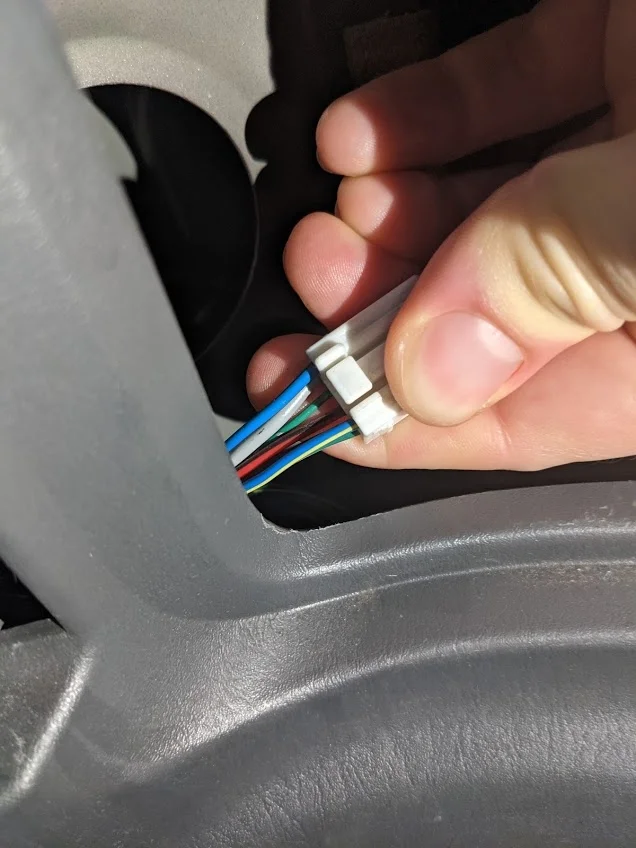

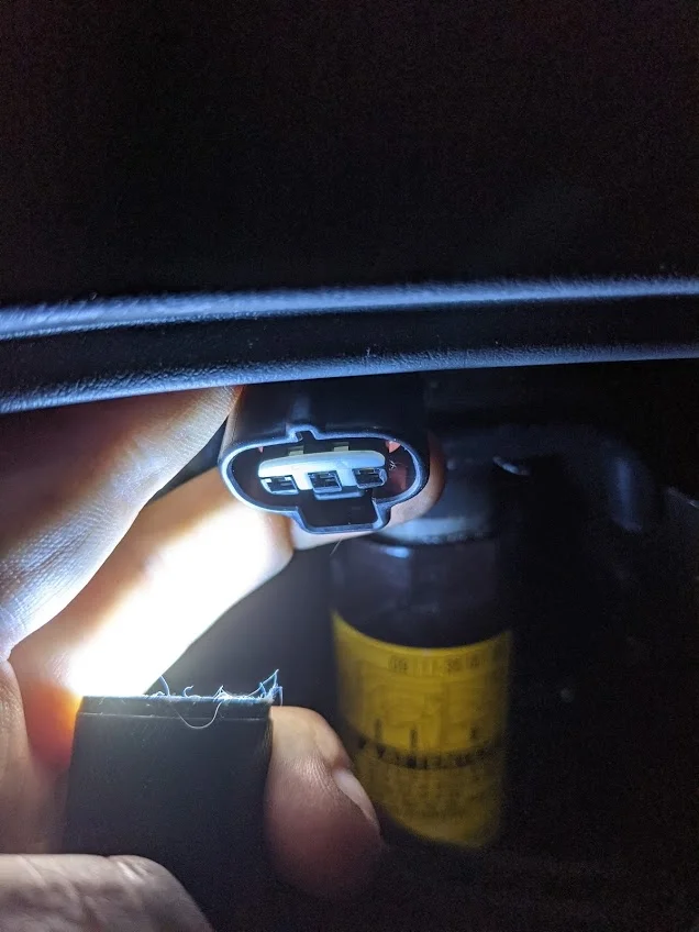

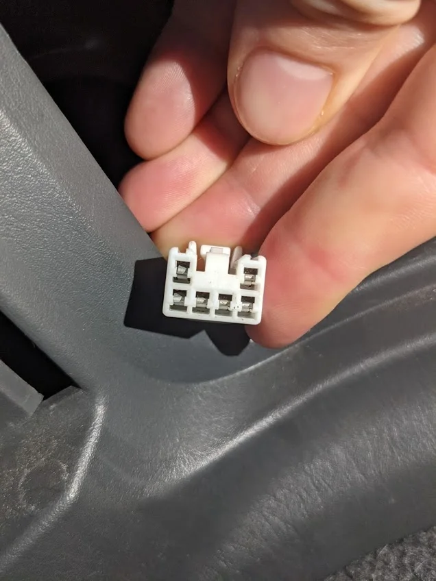

So.....my Prado didn't come with factory towing. I've been trying to figure out my best move for adding an aftermarket harness and boy do they make it convoluted. I think I understand but better to ask questions than screw this up.
First mistake, I already bought a 7pin flat/4pin OEM replacement from Hopkins thinking the truck had the towing package. I have no problem with cutting up and soldering the wiring on the unit I bought since that will be necessary on some level anyways...but appears I also need to buy and wire a "Tail Light convertor" in line to function correctly. Right?
Unless I'm not finding it, there are no OEM plug and play convertor setups for the GX/Prado/4Runners so I just need to buy something and splice it to the OEM wiring brake light/signals harness and then to the Hopkins 7/4pin connector unit?
All the convertors I can find seem to be only 4pin....since the trailers here are all 7pin, the other 3 pins need wiring for reverse, brake controller and marker lights, no light convertor needed for reverse and marker lights....right?
Rather than run all the wire and mount a brake controller, I like the idea of the bluetooth brake controller that fits inline between the truck and trailer (7pin flat male/female) so I need to run a 30A auxiliary to the brake controller pin. Would I be adding a relay that kicks in with AUX that pulls from the battery or am I overthinking that?
Left side behind the jack, two lonely connectors....assuming this is what the OEM towing connector plugs into? Can anyone show me if that's right on their GX with towing package?
