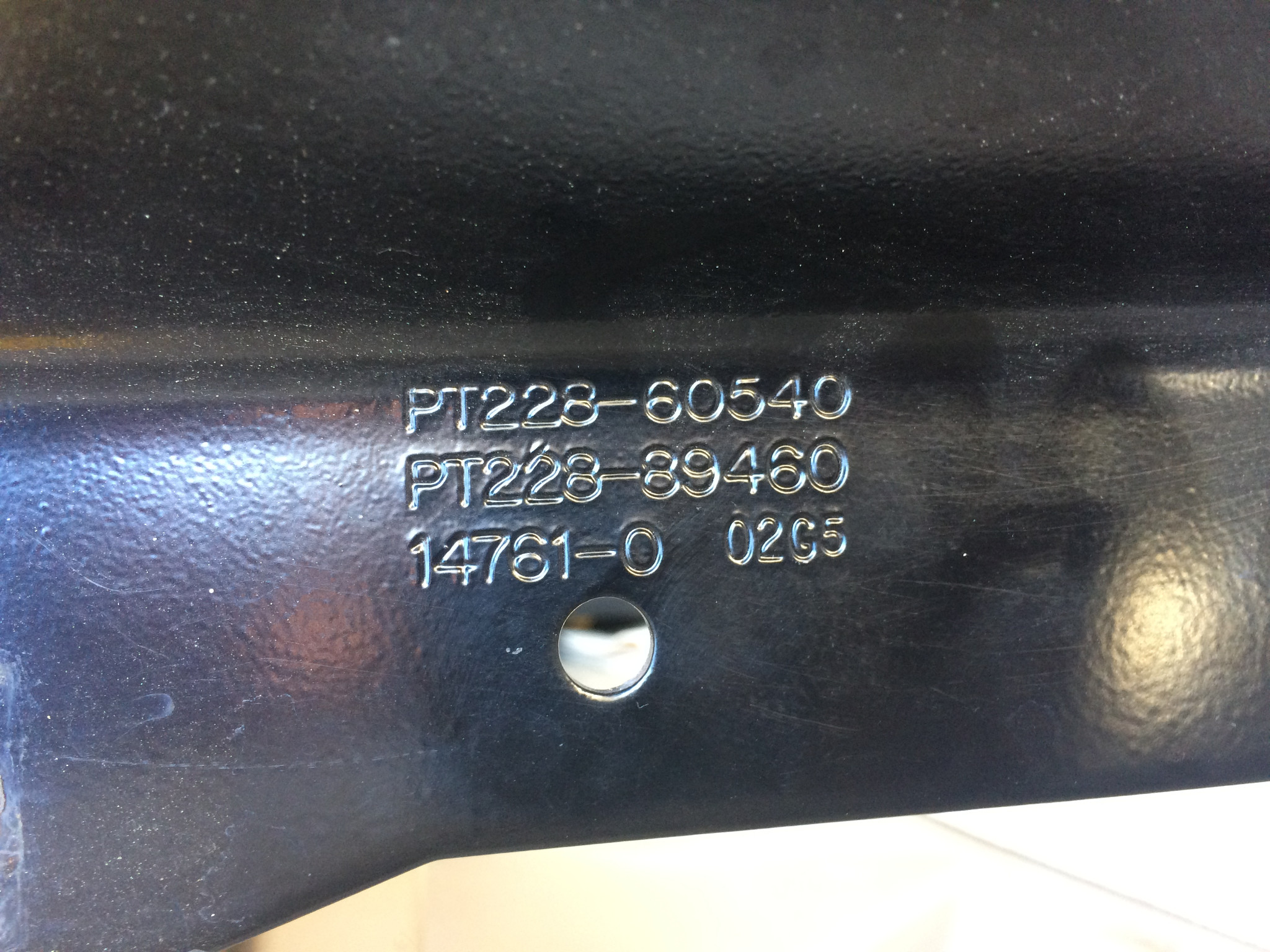

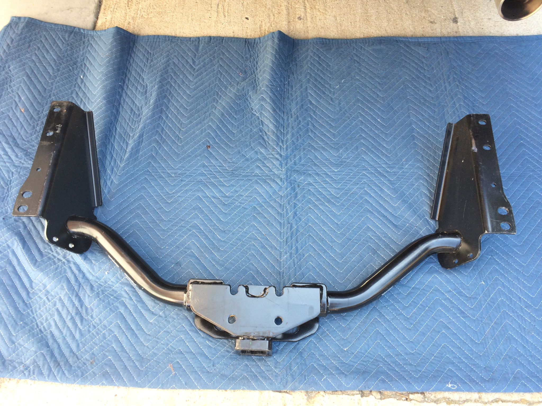

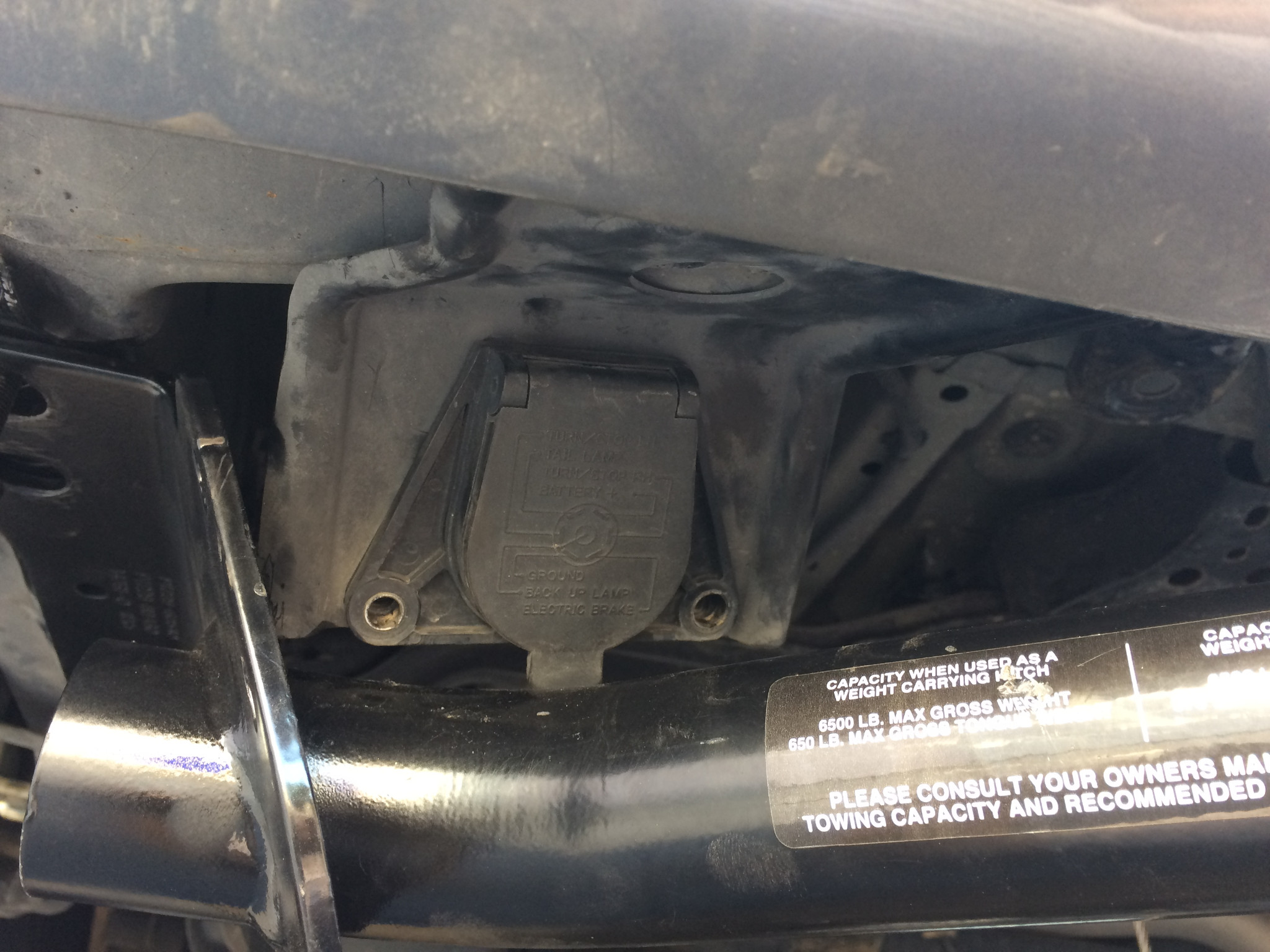

So I am a little bummed out. Today I installed the factory Lexus tow hitch (PT228-60540) and I ran into an issue with the trailer plug bracket being in the way of the hitch. I knew this would be the case for an aftermarket hitch because I saw it in a YouTube video an their solution was to just zip tie it to the hitch tube. This ended up being my solution right now but something must be different for these two items to not work with each other! I would love to see pics of others who had a hitch from the dealer to see if the bracket is different.
Discontinued Part No.
Used OEM town hitch in excellent shape. I don't think it was ever used.

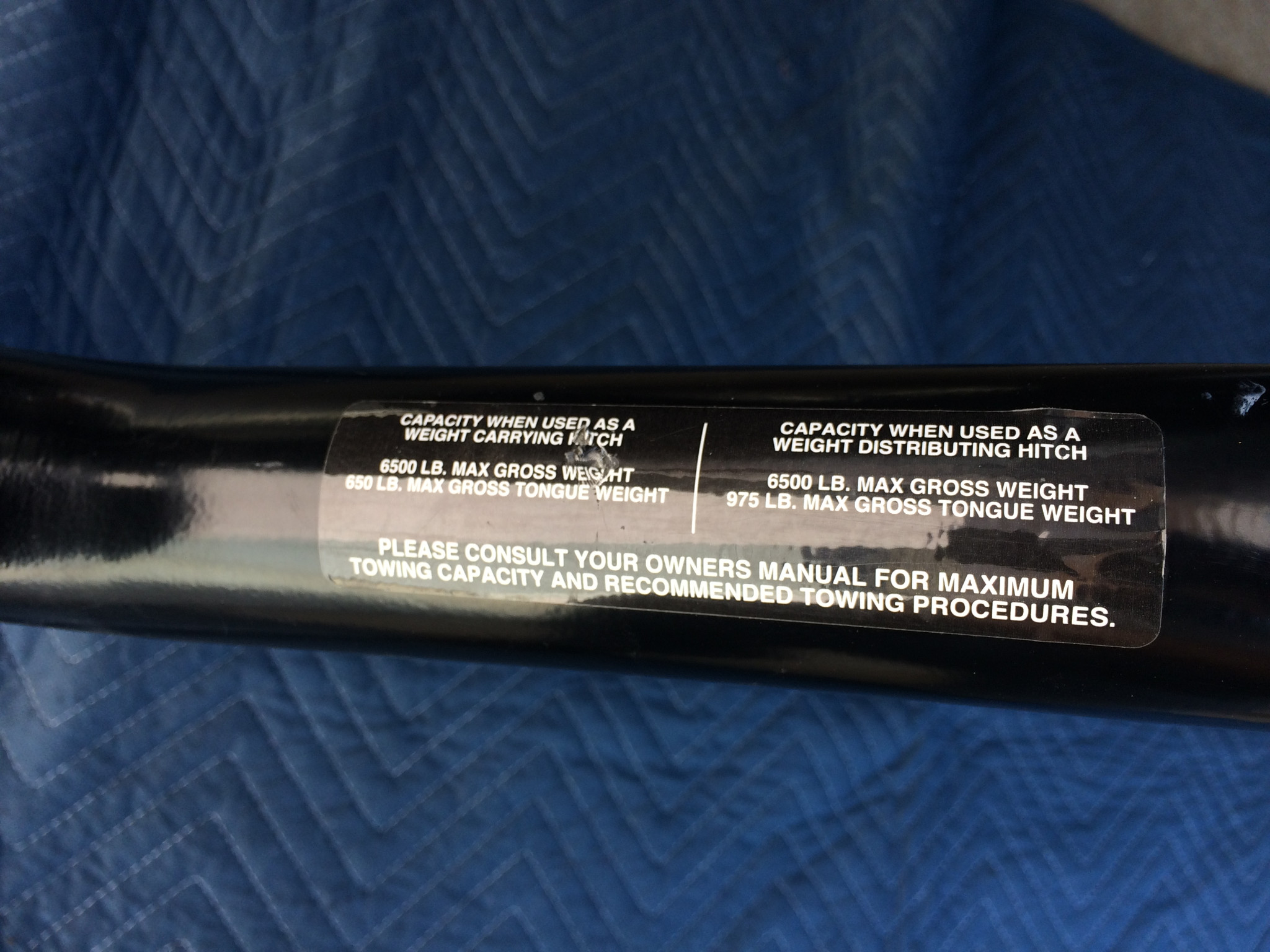

Specs
And here is the issue WTF! Even if I trim the bracket the flap cover would not be able to open.
So after a visit to the Lexus dealer to figure out if there was a separate bracket part number we thought we had it but not 100% sure. So with the part number on hand I went to my favorite online Lexus Parts sites and one was a strike out and then Lexus Parts Now had it and a pic of a diagram that looked like the right part and for about $11 less than the dealer so I took a chance on it.
Came in the mail today and we have a winner!
So for those of you who pick up a used factory tow hitch without a bracket you will want to pick up this part as well for a nice clean install.
PT228-89440-BK
