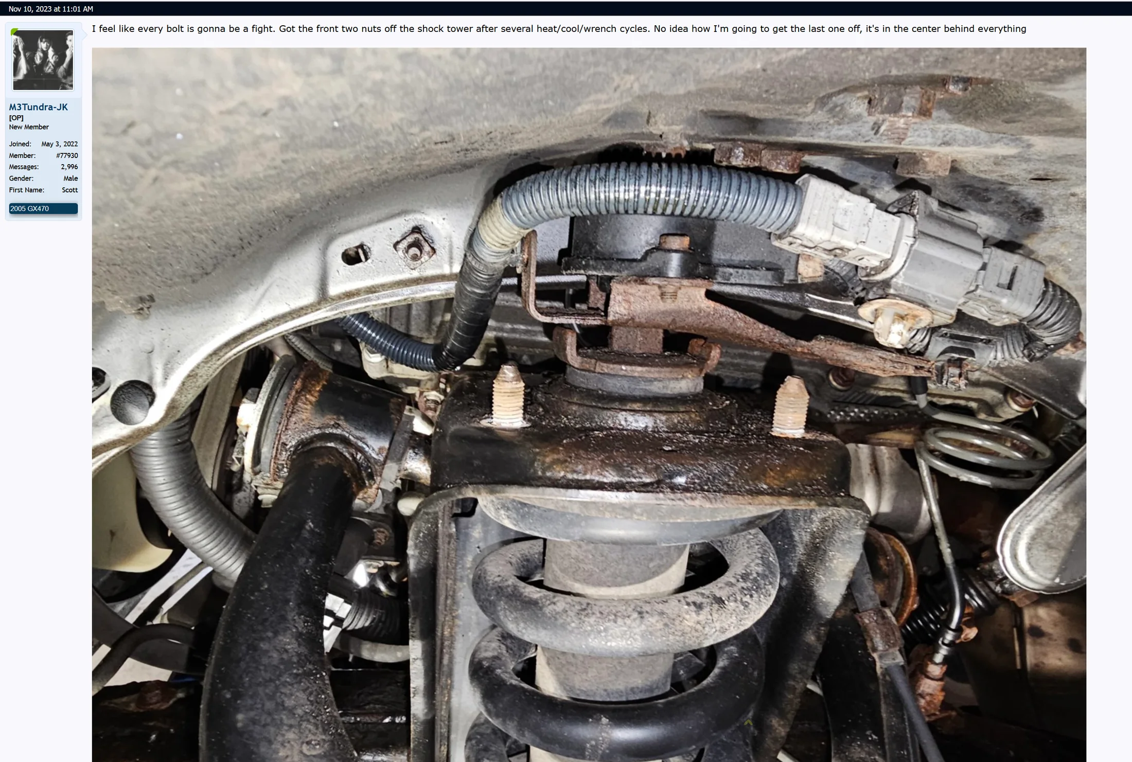

UNLESS there's any amount of rust on them! What a PIA it was to disconnect the sensors and remove any of the bolts to get the front OEM's out. Probably the hardest front struts I've ever removed.

Same Nightmare I faced.
Busted them off With Prybar.
