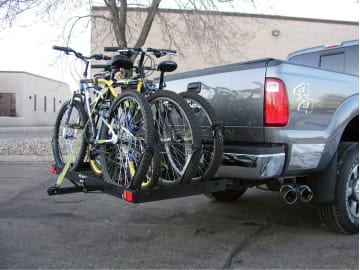

So next up is a luggage hitch basket for coming home from a trip this summer from LAX back down to SD with 7 people in my GX. Anyone want to say they have the best hitch basket?
I don't plan on using it again much maybe just once a month for recycling when I fill my two trash cans with bottles and cans. So probably just going to find a larger model but don't want to buy a crappy one because I will need it to hold about 7 pieces of luggage down the freeway from LAX.
Oh and just thought about may install a hitch receiver on the future travel trailer so the hitch basket could get some use their to carry the washer machine drum and wood for camp fires in the state parks.
I like the Tow Tuff TTF-276KR because it can double as a bike carrier with removable tire chalks. This would be handy on the back of the travel trailer for sure!

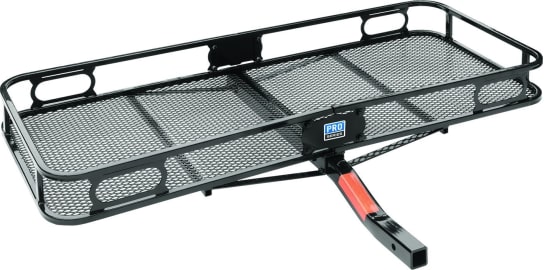

I wish it had the bent hitch bar to allow more ground clearance like the Pro Series 63153 but not a deal breaker.
