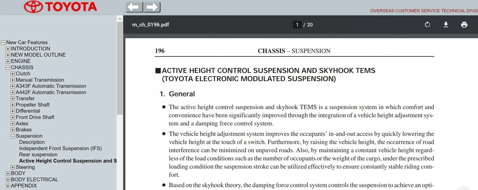

The pump is a simple robust positive-displacement gear pump. Diagrams of the pump and other AHC components can be found in the FSM at the pathway given below.

To do this, go to https://lc100e.github.io/manual/ . To start, find your way to AHC general description and diagrams by following the tabs along the pathway depicted below. Diagrams of AHC components and an explanation of how they work are found here:

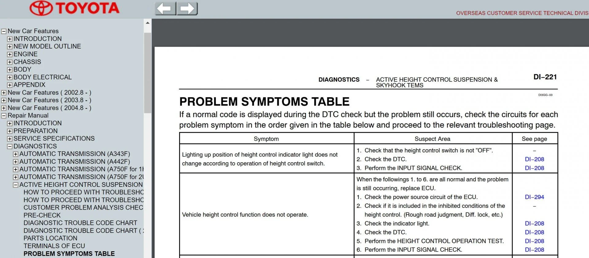

Next, follow another pathway to the “Problems Symptoms Table” as shown below. This lists various symptoms and gives a lead as to the possible causes. As stated at the top of this Table, it is best to work through these methodically in the order given in the table, rather than start in the middle with a guess.
Details of all of the Diagnostic Trouble Codes also are found in this section of the FSM, as well as details on how to check the Pressure Sensor on the AHC Pump with a multi-meter (without removing the Sensor).

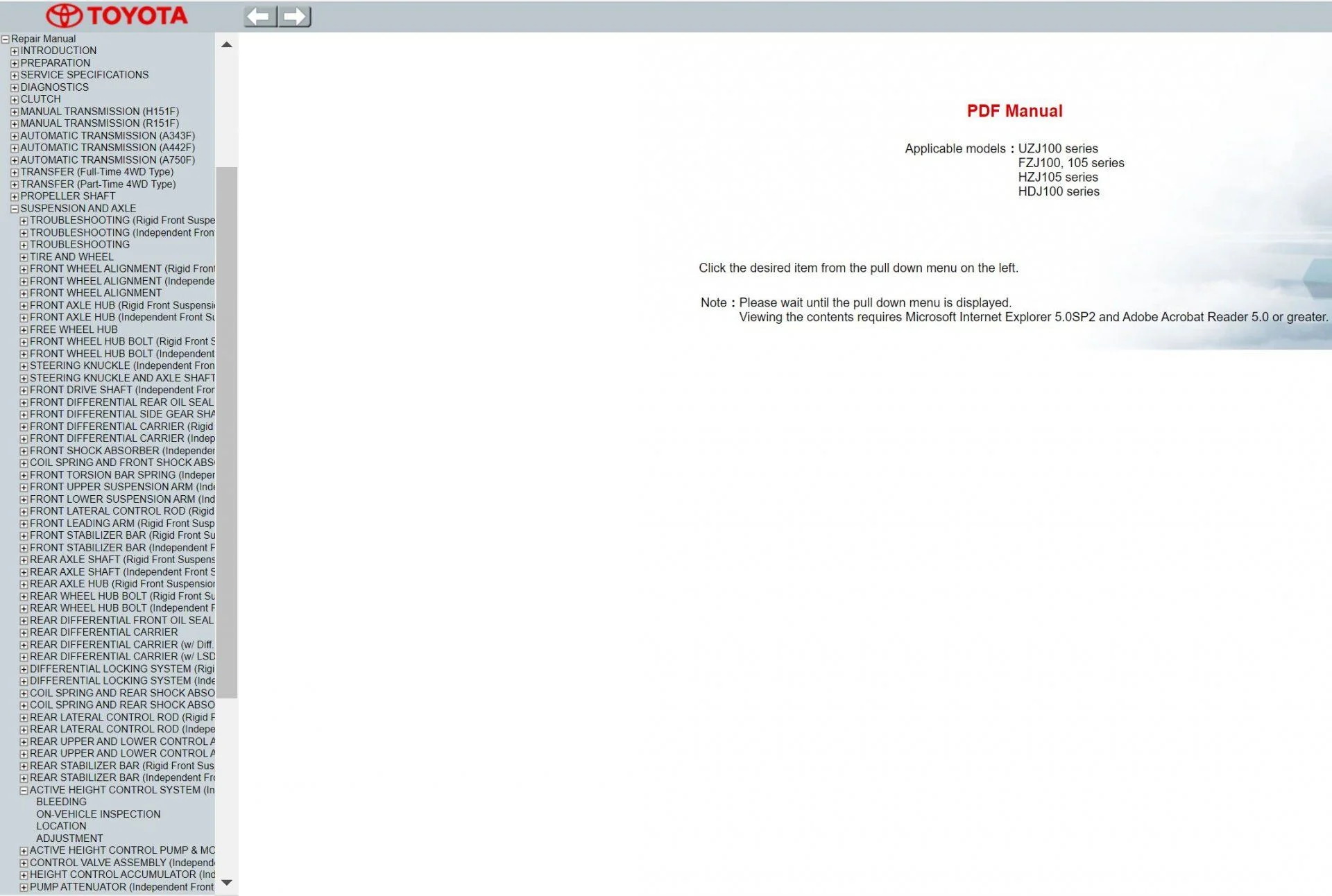

The “Repair Manual” section of the FSM also explains how to go about removal of various items. In this section, scroll all the way down until you reach the "Active Height Control" sections.
As @ramangain already suggested, if you are inclined to remove and dismantle the AHC Pump (not difficult), this will first require depressurising the AHC system by very gently carefully opening the bleeder valves and catching the fluid with a hose leading to a container. Be very aware that the stored pressure is quite high and the vehicle will drop suddenly to the bump stops. As @ramangain noted, this also would provide an opportunity to open the bleeder at the Height Control Accumulator (long black cylinder on Left side chassis rail) and briefly start the pump again and observe whether fluid is being pumped, or not. Releasing fluid from all four ‘globes’ also would give you a good idea of the condition of the existing AHC fluid.
