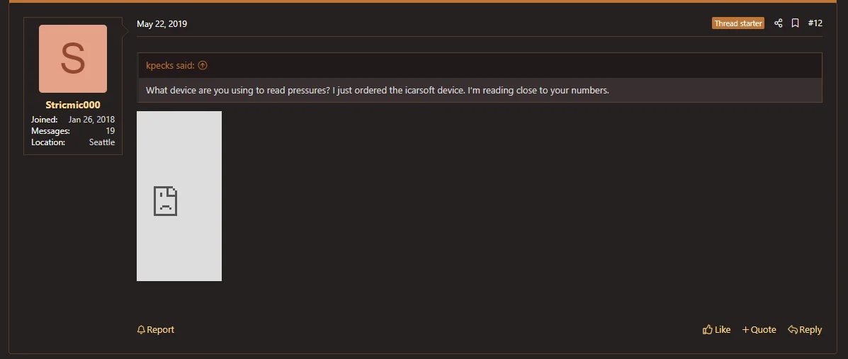

How have people found this device for pressures is it easy to use and how is it set up with your phone ?.Thanks.
Bluetooth, there's an app for your phone and instructions come with the device

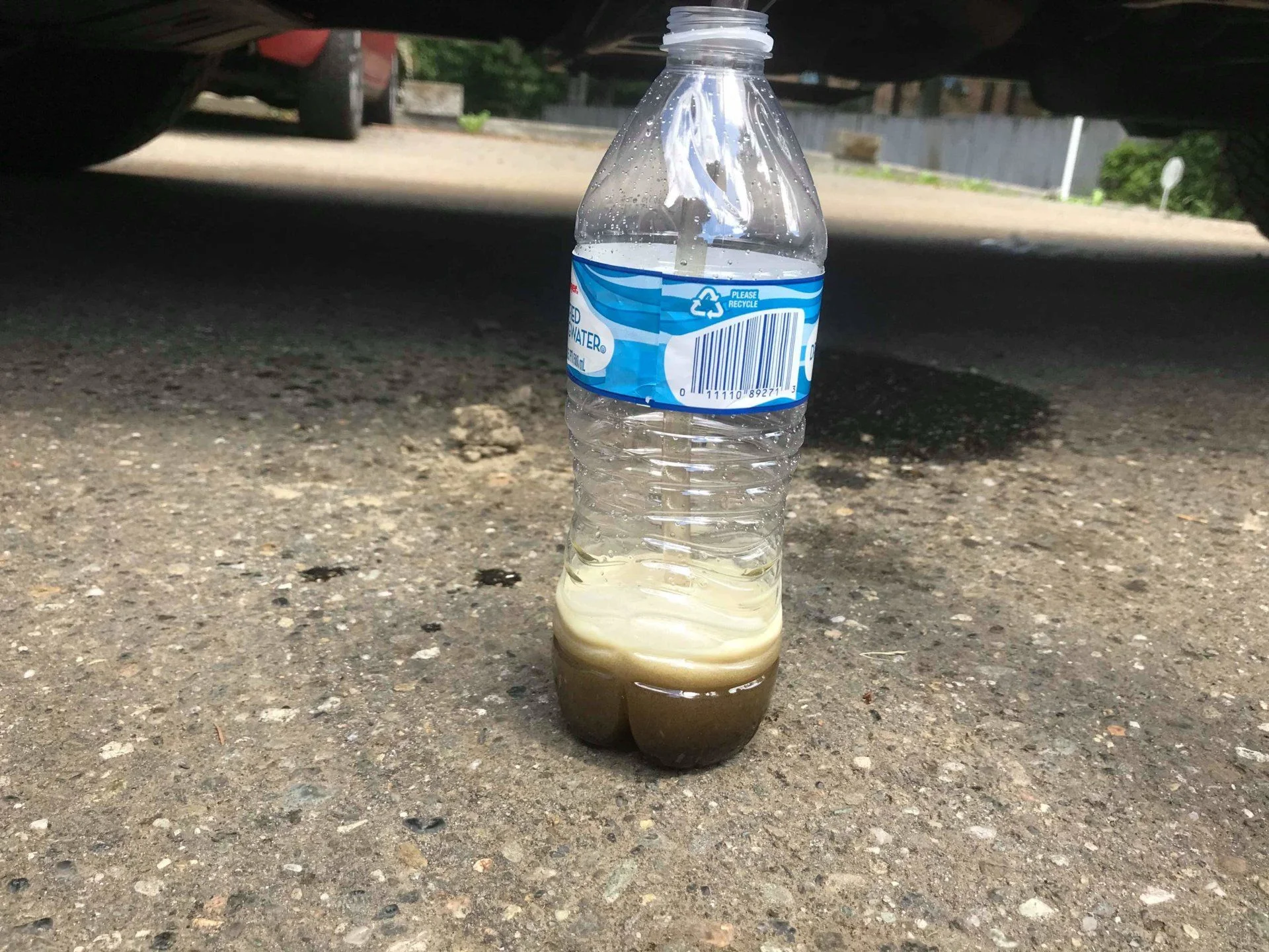

Put new Globes on yesterday and bled some of the old fluid out after replacing everything in the reservoir brighten body is significantly better and the speed of raising and lowering is quite a bit faster in the back but the front is seemingly the same speed oh, I'm going to read cross level and adjust the torsion bars today to see if I can make the ride even smoother

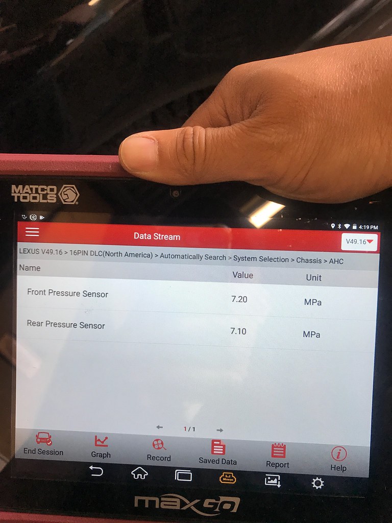

I have my pressures like this and I like the ride very much. When i first got the truck it was 9.9mpa front, 8.9mpa rear, I shimmed the rear springs with 30mm coil spacers and i tightened the front TBs 9 turns each.
How do you get the pressure readings? I'm not seeing the options in the app
did you figure out how to read pressures? Im gonna need to order if it can be done. Need to check my pressures badly after doing my ahc adjustments today! pls let me know, thanks!

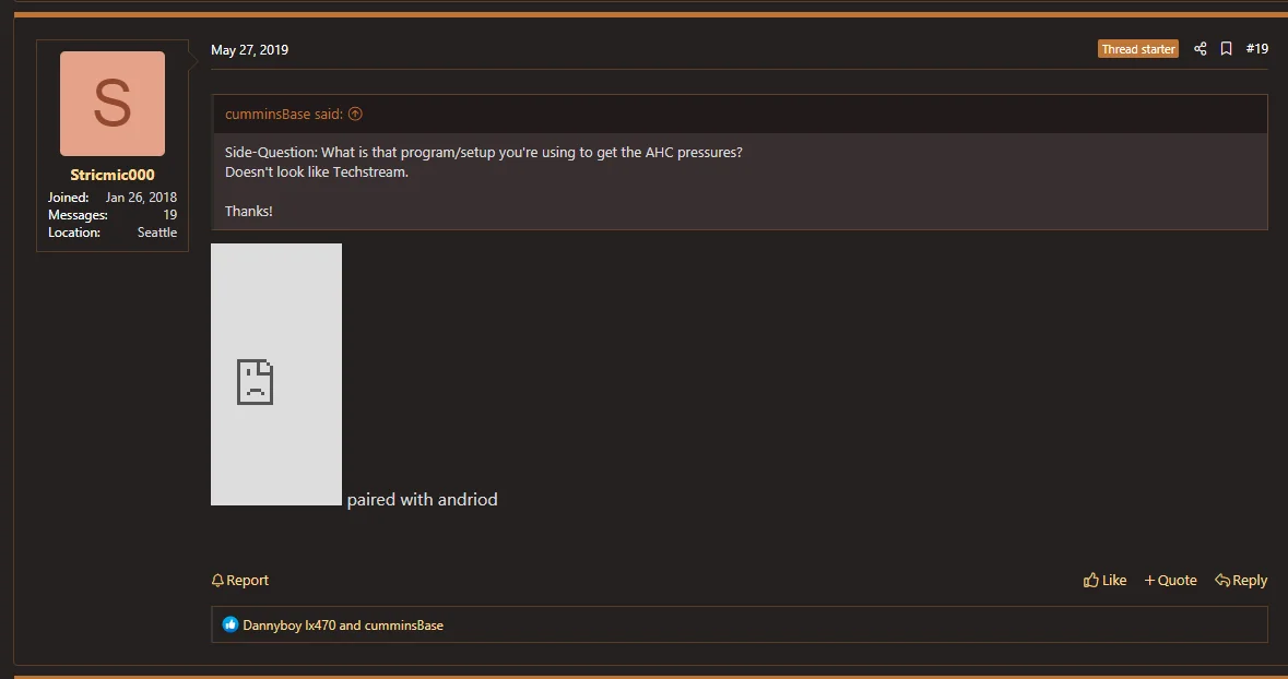

I use an inexpensive Bluetooth dongle -- ELM 327 MINI – and ELMScan Toyota - Apps on Google Play as a reader. This combination is used exclusively as my AHC Measurement Tool. It appears to read other ECU's as well, but I have not investigated these.
I do find this Bluetooth arrangement to be very convenient – no cable – and enables use of a tablet or phone (both Android in my case) which I can mount on the windscreen or take around the car, for example, while investigating suspected Height Control Sensor problems etc. For pressure measurements, I use this arrangement and follow the FSM handheld tester procedure plus IH8MUD commentary and obtain repeatable measurements -- when I do it correctly.
The scanner interface and the app were bought separately for about AUD30 say USD45 in total. Google for availability of the scanner interface dongle at Amazon and elsewhere in USA and EU, and at KOGAN in Australia.
The app comes from Google Play. It is pretty much ‘plug-and-play’. I understand that iPhone/iPad versions also are available.
