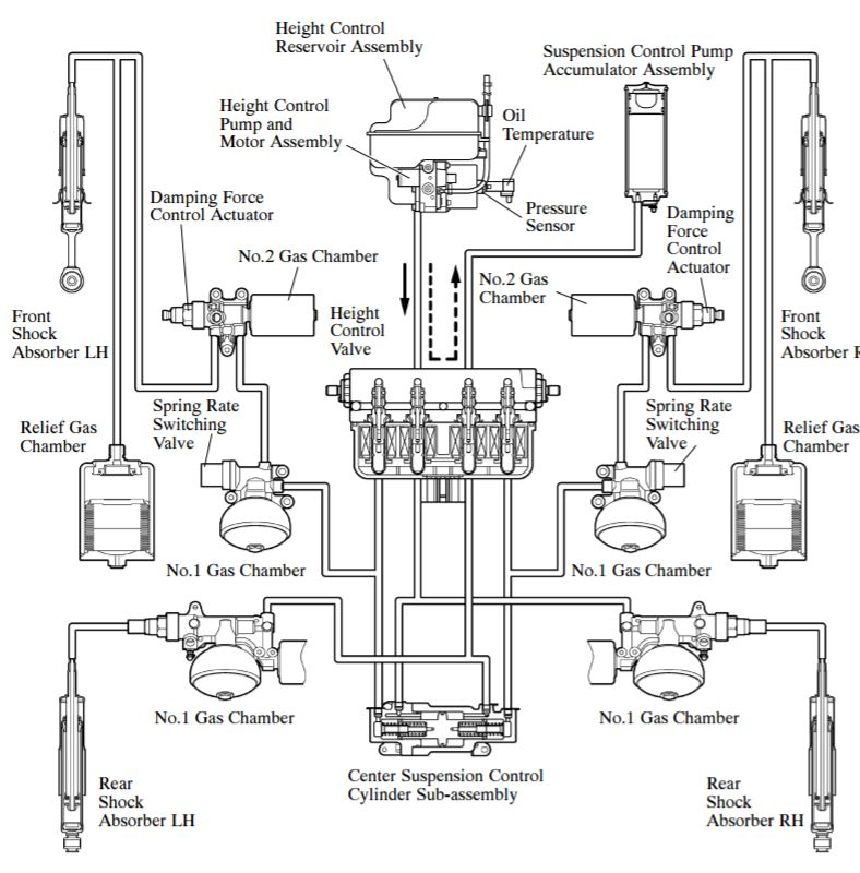

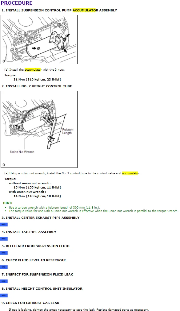

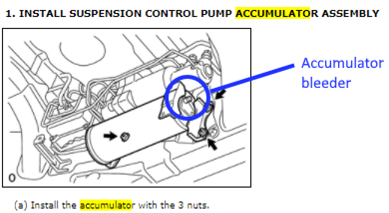

It's not the pump, unless they've burned it out. Even with a new pump, it won't solve the issue. They need to get the fluid priming again as there's air stuck in the system.
Tell them to bleed the system and to make sure the AHC fluid reservoir is appropriately topped off and not to let it run dry again. Then bleed the "Suspension Control Pump Accumulator Assembly" at the top right of the system diagram. It located on the inner side of the frame around the middle of the chassis under a cover in the lower diagram.
Unfortunately this is a common mistake, and the repair manual doesn't do a good job of documenting how to resolve the issue.

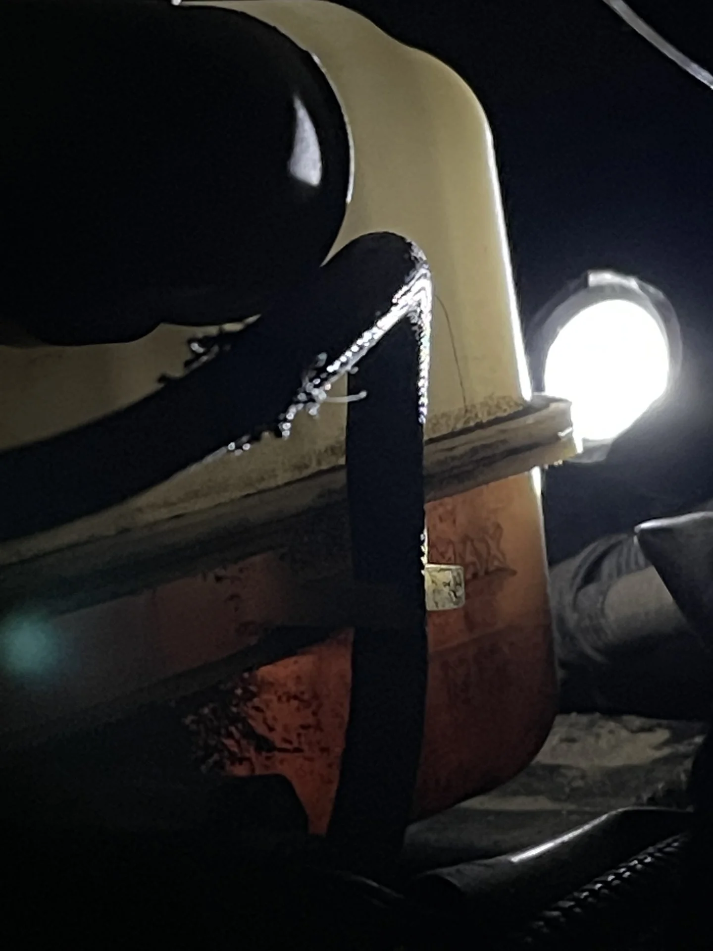

I just did a flush on my system following a couple guides that I saw on here. I seem to have pulled air into the system as well. Everything was working normally until the second time I drove the vehicle, about 3 minutes into the trip I threw the check AHC code. Stopped to examine what was going on and the pump was running noticeably loud. Based on what I've been reading thus far it sounds like I should bleed the control pump accumulator then the whole system starting at the drivers side front and working back to the passenger side rear valve. Is there anything else I should do in addition to that at this point? Should I bleed with the system in L? And how much fluid should I let out? I did some bleeding before driving after doing the job and didn't run into any air so I thought I was good. The guide I followed said to let out 500ml of fluid per corner and to add new fluid in. Shortly after I started having problems I found another forum saying you should absolutely not move more than 170ml out of the system at a time for risk of pulling air into the system. Needless to say my garage mechanic confidence has been dealt a serious blow. If the pump is already making spooky noises, am I going to have to manually prime it like some people have talked about? So many questions and seemingly a good bit of conflicting information. Sorry for the rapid fire questions, I'm just shook at the thought that I effed my poor truck up in a way that dealers even have trouble sorting out.

Hopefully this is your issue. It shouldn't be too hard to solve, and it's a matter of bleeding the right nipple at the control pump accumulator so the AHC pump is no longer dead-heading against high-pressure to prime again.

AHC in N, fluid level is a little high. All throughout the flushing process it was fluctuating between height settings fine. And the first time I drove it after the change it went L to N, drove 15 minutes two ways then N to L back into the garage with no odd pump noise, trouble code or noticeable delay. It was the second time I took it out about an hour later that it threw the code, pump started sounding funny and cycling between setting would take forever. When starting the flush I put it in L and got my fluid pump hose way down in the reservoir which led to 1.9L of fluid being evacuated. I replaced with the same amount immediately after and before operating the system at all. Does that sound like anything that would have caused an issue? That would have been the only time the reservoir was totally empty, but the system wasn't run at all in that state.
