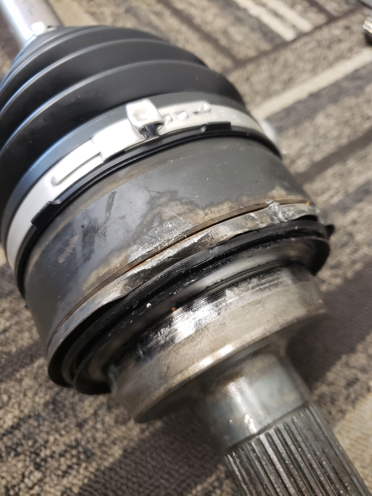

All very good Intel!!! I'd definitely hold dealer responsible for all repairs, parts and rental fess. All you have to do is threaten to file judgment and they will jump through your hoops! I took my cv's to dealer to have my mid-shaft swapped for a longer one with new boot kits. See in the photo what they tried to give me back. Looks like a ***ing wolverine knarlled on it. Needless to say I refused. And he seemed very a matter of fact making excuses. Afyer speaking with high up and threatening to sue.... that i brought it to lexus cause i expect perfection....They replaced the housings and all dust shields and seals. Trust me not a judge in the country wouldn't see it your way!!!
